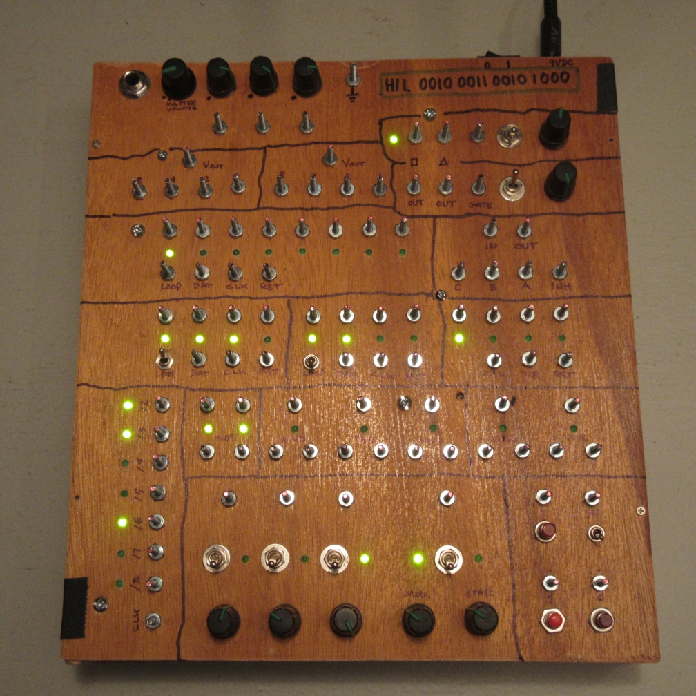

Despite the facts that it was/is the Lunetta subforum was which inspired me in doing electronics and that CMOS logic forms the basis of most of what I have built, I never got around to building a "real" Lunetta!
Even this I consider just a prototype, since I had to build it in a limited time-frame for a concert with not much planning, and I did not have time to incorporate certain visual decorations I've had in mind for a while (actually planning 3 separate Lunettas).
I call it the HIL 0010 0011 0010 1000.
(HIL for Highly IlogicaL, or maybe Highly Interesting Logic, and the binary is another reference)
From bottom to top more or less:
- Ken Stone Clock divider (w/o logic section or reset)
- 3 clock oscillators w/ 2 ranges
- 1 mark & space (variable duty cycle) oscillator w/ 2 ranges
- "bit buttons", i.e. momentary switches, 2 connected to 9V and one connected to ground. Also, 9V connected to on/off switch
- Logic section: 2 NOT, 3 AND, 2 XOR gates
- 2 x 4-bit 4015 shift reg w/ loop switch
- 4029 up/down binary counter
- 8-bit 4015 shift reg
- 4017+4051 "melody generator"
- 2 x 4-bit R2R DAC
- 2 gate-able square & triangle oscillators w/ 2 ranges
- 3-input mixer
I think there are 94 bolts. It's a little bit cramped.

nice lunetta james Very Happy looks like you have a useful selection of logic in there.
It always surprises me how fast the bolt count goes up, I'm working on a
lunetta synth myself at the moment which has an A4 sized panel and about
75 bolts.

It always surprises me how fast the bolt count goes up.
Thanks, yeah, it's easy to say "oh yeah, it would be cool to add another shift reg and that chip, and it would nice to add another gate...". but then you have to bring all those inputs & outputs to the panel...

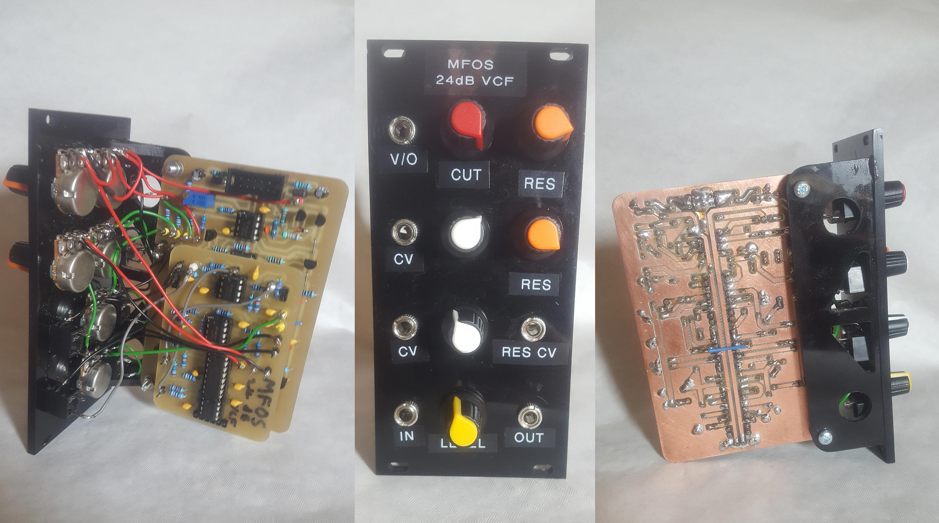

My first multilayered PCB Very Happy
MFOS 24dB VCF with VC Res

Very nice! MFOS stuff is classic DIY!

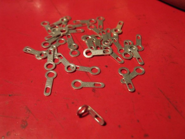

RingMad, PHOBoS, do you solder to the bolts/washers? or just make a mechanical connection?
Posts: 5854
PostPosted: Tue Oct 17, 2017 12:02 pm    Post subject: Reply with quote  Mark this post and the followings unread
I use solder eyelets/lugs myself, which I bend like the one in the foreground.
You could just wrap wire around the bolt before tightening it but this is more
convenient (and they're very cheap).

Seems like a nice economical way to build. Any disadvantages compared to, say, bananas? No colour-coding, obviously, but how does patching compare? Do the crocs stay on when manipulating a big tangled mess?
Posts: 428
PostPosted: Thu Oct 19, 2017 5:58 am    Post subject: Reply with quote  Mark this post and the followings unread
I don't have any experience with patching bananas. I used banana jacks on one box, but they were so cheap that they were a real pain to install and had to hot-glue them so they would stay still. I also installed them in such a way that I could use the alligator clips on them.
For colour-coding, one could always paint the nuts, or use a marker. I didn't think of that in time for that for this rushed build, but I did use a Sharpie marker on the tops of the bolts (although it's too small a surface to be very useful, especially in a concert situation).
It's true that the crocs can be a bit problematic in a patching mess, and surely less stable than bananas. With decent quality crocs, I haven't had too much trouble with them falling off. I probably should have put more space between the bolts, as it is a little cramped.
.:James:.
Posts: 5854
PostPosted: Thu Oct 19, 2017 6:39 am    Post subject: Reply with quote  Mark this post and the followings unread
My personal experience is that the alligator clips combined with the thread on the bolts make for a pretty strong connection,
maybe even better than bananas but that depends a bit on the quality of them. Patching takes a bit more effort because they
are springloaded clamps so you can't just plug/unplug as with other connectors. I've actually been looking for some female
connectors that could be pushed onto the bolts but haven found anything suitable yet. An advantage with alligator clips is that you
can easily extend leads by clipping them together and you can also clip more than one lead onto a bolt so no need for fancy stackables.
As for color coding that is something I really like about bananas but with the way I make my frontpanels I can still add some color coding:
I usually keep a spacing between them of at least 15mm/0.6" which works for me but YMMV.

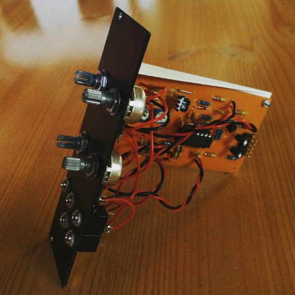

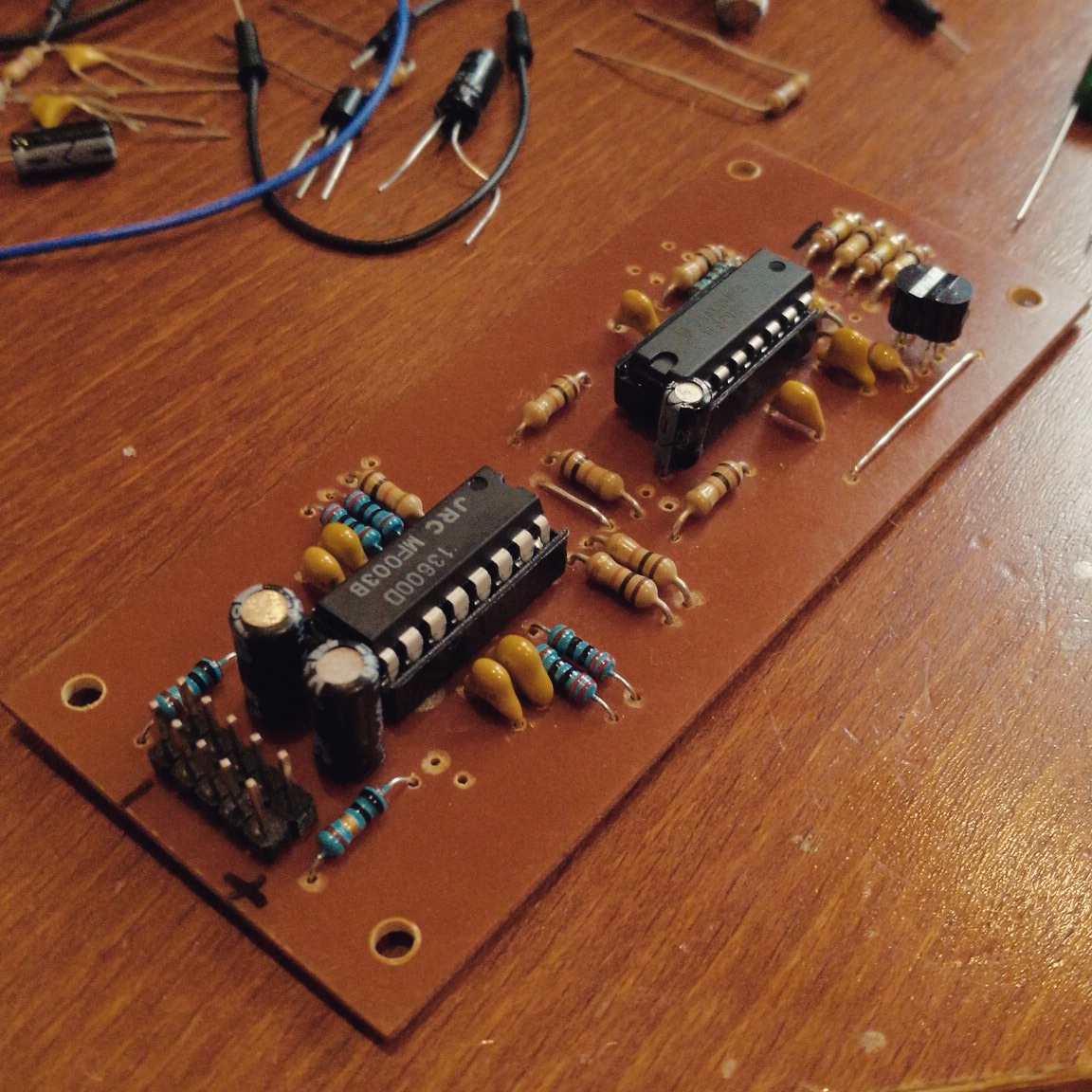

Starting to get it going, René's 4069 VCO and MS-20 filter, still need to make panel for that.

Great!
And noticed ... pertinax Smile long time ago since I last saw that!
buildamodular
Joined: Jun 14, 2017
Posts: 5
Location: Finland
PostPosted: Fri Oct 20, 2017 3:06 pm    Post subject: Reply with quote  Mark this post and the followings unread
Yeah, that stuff stinks horrible Very Happy
Posts: 24467
Audio files: 297
PostPosted: Fri Oct 20, 2017 4:16 pm    Post subject: Reply with quote  Mark this post and the followings unread
he, yeah, and smelled was a while ago too :-)

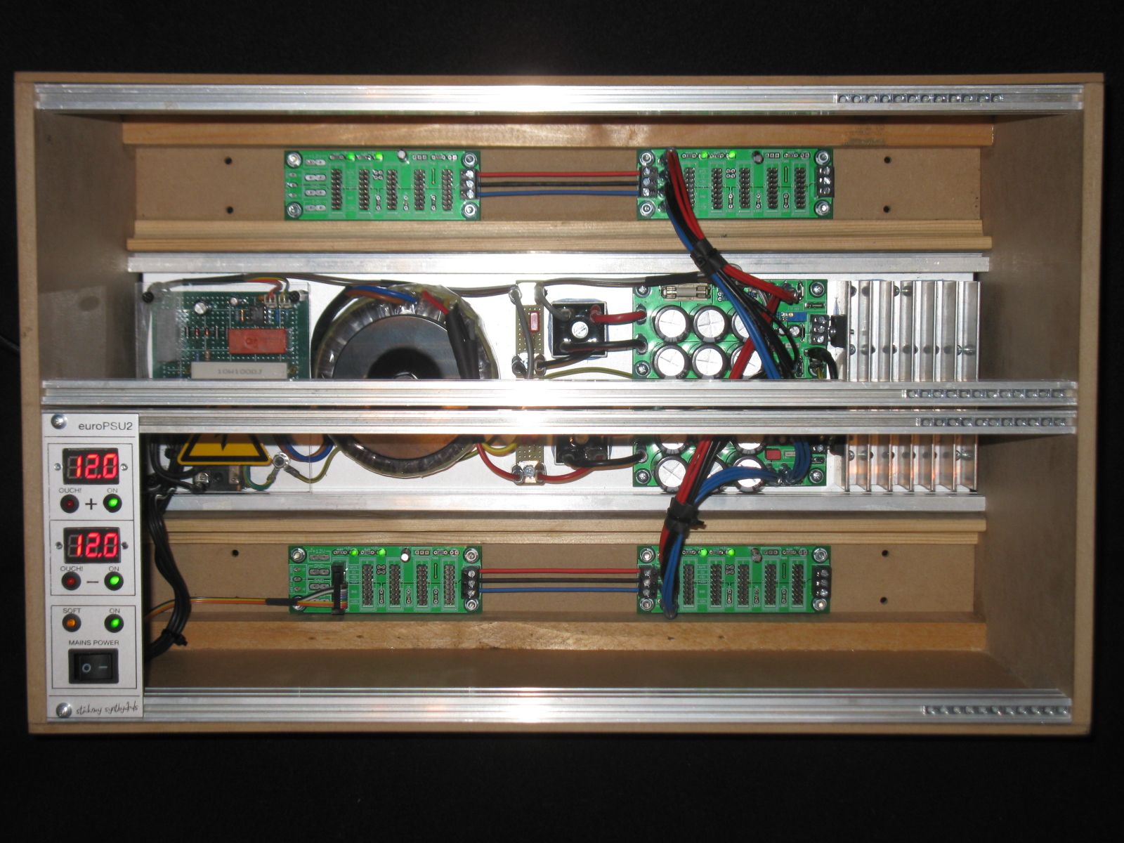

finished the PSU for a new euro-rack case.
more info here
