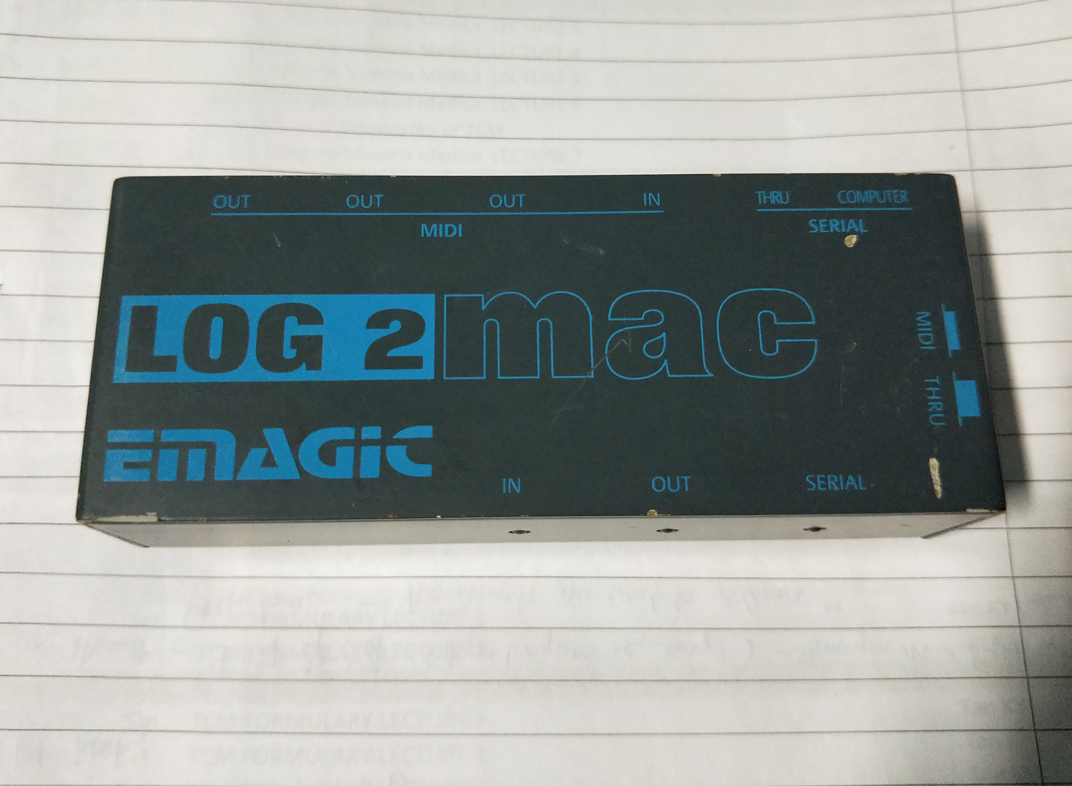

I was just cleaning up my room and discovered that I still have a serial midi interface from Emagic. It was the first interface I ever use when using Opcode back in the 90s. It has served me well.
Fast forward--->
Now recently acquired a Digitakt and love the interface the possibilities of beats making. I might next acquired a tabletop polyphonic synth, maybe a Micromonsta or a preenfm2. So this discovery of this midi interface came as a blessing.. well maybe....

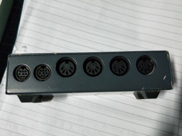

On the interface, it has a midi thru button. I plug my midi out from the Digitakt to the interface midi in and midi out from the interface to a Volca bass. Before doing this, I've already test that I could control the Volca Bass on track 9 of the Digitakt. So that works. But thru the midi interface nothing is transmitted.
So is there any way of hacking this to work as thru device? Maybe I need to power up the unit for it to work? Any ideas or suggestions?
There are 3 outs on this devices... hence if I get this working, it would be a super great bonus! and I can save money for one of the aforementioned synths!!

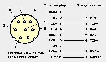

I was looking at the cable layout for the mac serial port connectors.. it seems that the connector has only 8 pins. and the pin for power is missing. My guess is that it the power is coming from the TX and RX port.
How and where can i get power into it the optocoupler?
i use this link for information on the serial ports.
https://whitefiles.org/b1_s/1_free_guides/fg1mt/pgs/h10b.htm

PostPosted: Sat Apr 21, 2018 4:39 am    Post subject: Reply with quote  Mark this post and the followings unread
there is no pin 9 on the serial port that I have... this is the diagram related to the port

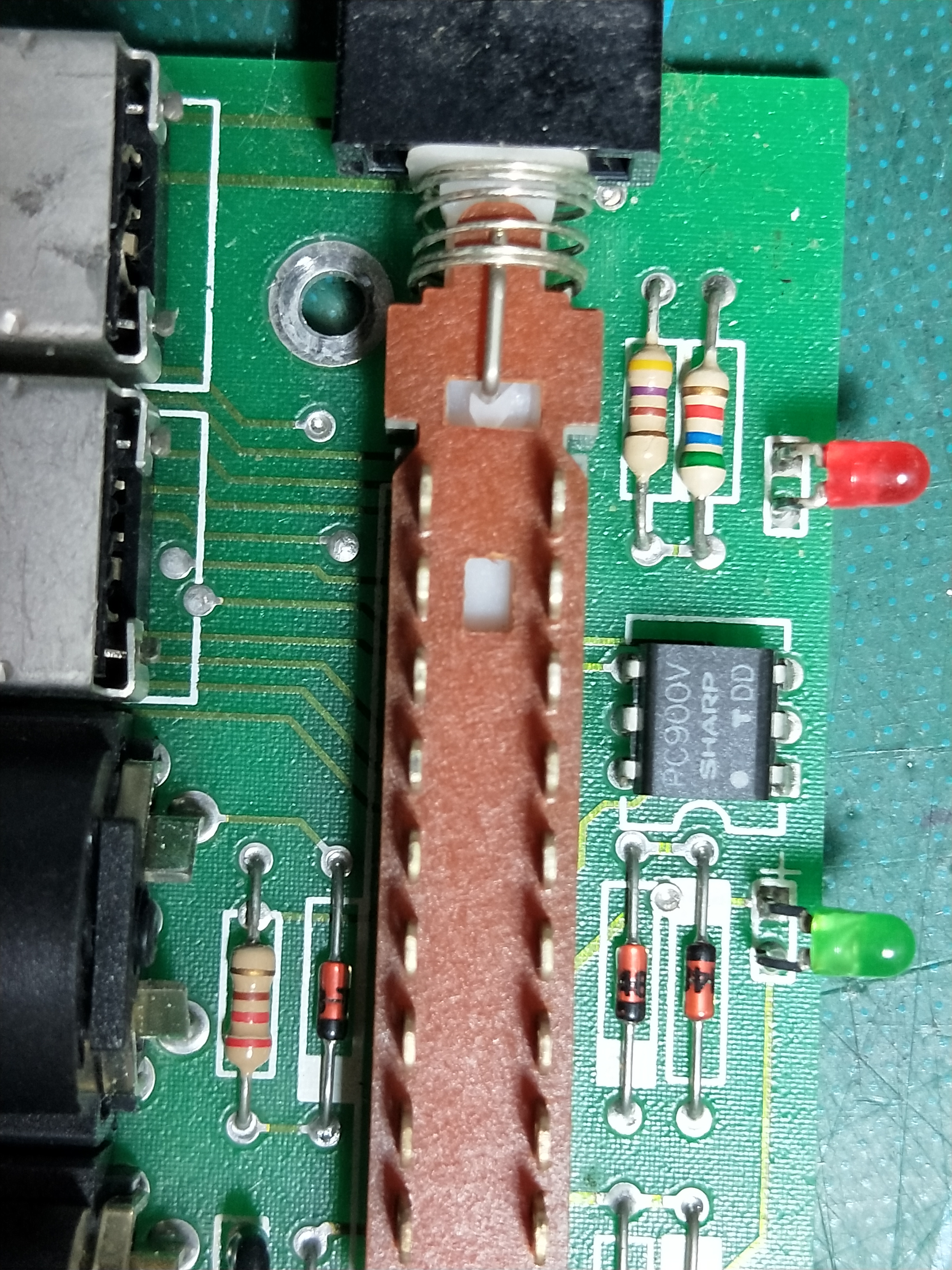

Maybe if you open it up and take a photo of both sides of the PCB (if it's not too hard to take out)
I can see where to apply power. Or you might be able to figure it out yourself too.

PostPosted: Sat Apr 21, 2018 5:09 am    Post subject: Reply with quote  Mark this post and the followings unread
here are the pics...hopefully it's clear enough..
there's 3 ics, they are ,
Sharp RC900V
SN74HC74N
MM74HC14N
thanks for having a look at it.

Posts: 5792
PostPosted: Sat Apr 21, 2018 5:39 am    Post subject: Reply with quote  Mark this post and the followings unread
I think I can work with that. It's probably possible to just insert the power on to the PCB (I can see some traces that carry the +5V)
but it must be possible to power it through one of the connectors. Maybe as you mentioned through the TX/RX lines. I'll try to work
it out later today.

PC900V is what I'm reading (not RC) .. which seems to be the opto coupler :: http://acon.en.seekic.com/product/integrated_circuits_ics/pc900v_pc900v_original.html

ah ic...ok so I should be able to add power on pin 6 and 0V on pin 5?
Posts: 24388
Audio files: 296
PostPosted: Sat Apr 21, 2018 8:40 am    Post subject: Reply with quote  Mark this post and the followings unread
Dunno ..
Since there are no dedicated power pins the power is either obtained from a MIDI input or from the serial port connection. My guess would would be that the four diodes near the LEDs make a bridge rectifier and the electrolytic capacitor would buffer it ..
In that case your suspicion of the power coming from the RX signal would probably be right, and PHOBoS' idea that a connector could be used would be right as well ... would have to trace a couple of connections.
It might also come from the MIDI input, but in that case the thing should already work for what you want to do with it. Also in that case a bridge rectifier would not be needed but just a single diode would do (with the elco).
Anyways .. such are my guesses .. but its hard to track the copper traces from the images .. do you have a multimeter or a continuity tester?
And also .. when my guesses would be right connecting power to the opto coupler would not power the rest of the circuit .. as the bridge rectifier would block it .. I don' t know if any part of that would be needed .. but I'd be guessing that it would not be needed.
[Edit] the above paragraph is nonsense, sorry :-)
Posts: 5792
PostPosted: Sat Apr 21, 2018 11:52 am    Post subject: Reply with quote  Mark this post and the followings unread
Your guess is correct. Now the question is what are the other sides of the diodes connected to. It's tricky to see with the
large switch covering a part of the PCB. As Blue Hell suggested a multimeter or a continuity tester would be useful.
I circled the pads in yellow where the (AC) voltage enters the bridge rectifier. You can probaby power it from there but
I wonder what else might be connected to it and which serial pins it actually gets the power from.
 Filesize:  95.19 KB

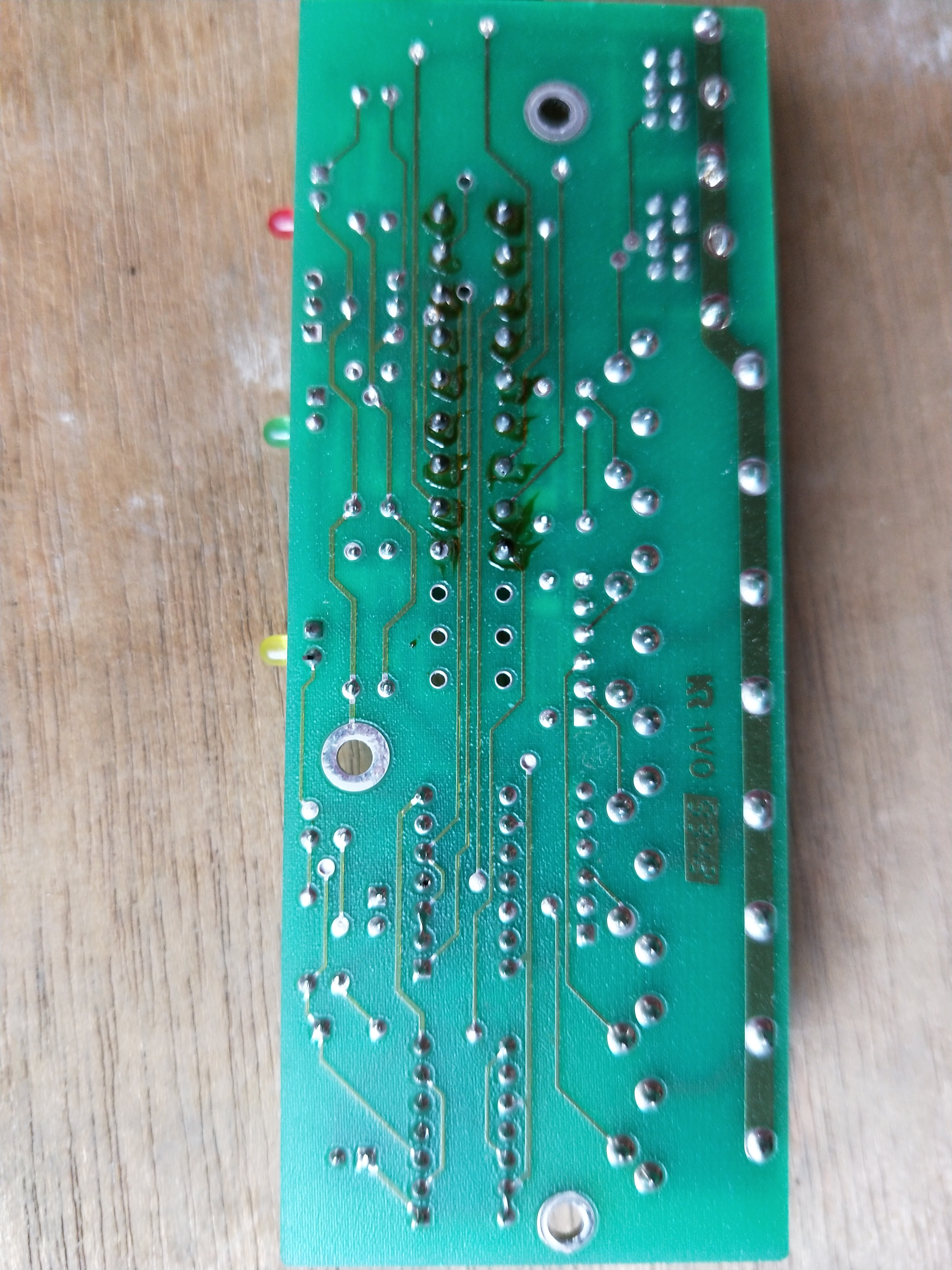

PostPosted: Sun Apr 22, 2018 3:00 am    Post subject: Reply with quote  Mark this post and the followings unread
here are some better pics.. to help see the traces.

Posts: 5792
PostPosted: Mon Apr 23, 2018 6:49 am    Post subject: Reply with quote  Mark this post and the followings unread
Even with the new photos it's still very hard to see how everything is connected wthout having the physical board in my hands.
It just doesn't really work well from a screen. However, I am pretty sure you can power it from the pads I circled or, probably better,
power it from 2 of the pads I marked black (gnd) and red (+5V). This way the power is blocked by the diodes to whatever it originally
derives the power from. An 78L05 should be sufficient as a regulator.
