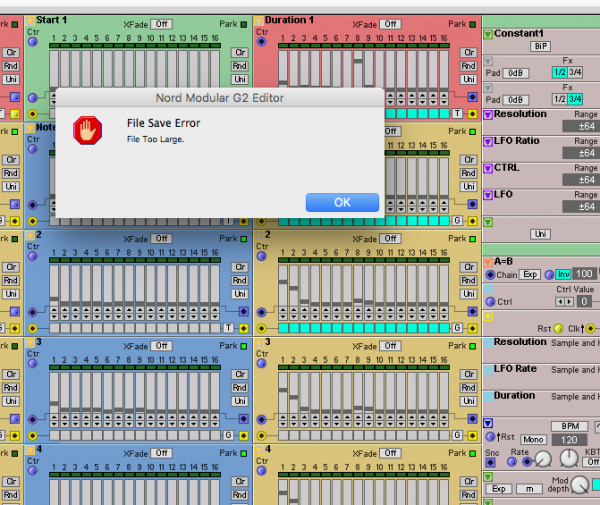

Has anyone had this before? I haven't overloaded the G2, but I can't save my performance because its too big.

I don't have the solution for this but I can try to fix it with you. By 'overloaded the G2' do you mean > max modules available in a patch OR the cycle/memory available from DSP ? You tried to save the .prf in G2 or computer ? Do you have enough free memory in G2 ?
Can you transpose the performance mode to patch mode (shift+perf mode from G2 front panel) and save each patch/slot one by one ? Like that you can isolate the wrong patch and dig on it.

I have saved each patch one by one and can load them all up again one by one. The performance works as it should but I can not save it as a performance either to disk or to the G2 Engine.
It seems to be that the maximum file size allowed to be saved is 66kb. It also appears that different modules take up more space than others. The control sequencer seems to be bad.
Tomorrow I will upload a performance made up entirely of control sequencers that is 66kb in size. There is still plenty of space available to add more modules but you will find that by adding just one more control sequencer you then won’t be able to save it as a performance. I have two expanded G2 engines and the same thing happens for both.

Interesting .. heh .. I was sure to find a larger one than 66k in the patch archive .. the largest one posted here however is 63k .. so 66k is huuge!

Yeah I am making some very large sequencer devices, using a lot of control sequencers.
I just tested my 66kb performance again this morning and it causes 'Major Error' so I won't upload it now. But I'm certain 66kb is the limit. Not sure why there needs to be a limit to file size if the synth engine can cope with bigger files.

But it has also made me wonder if there are other ways to reduce files size. Cable length for example? I don't know, but if file size is not related to patch load, it would be interesting to know what exactly does have the most impact?

All the settings for the controls eat up space ... there is not much you can do to change this as IIRC everthing in the patch file is fixed size.
Some info about the patch format to be found @ :: http://bluehell.electro-music.com/iaf/html/nm-open/nm-open-g2info.htm

Probably it is possible to save the performance (over 66kb) with sysex too. Do you wrote stuff in the textpad? It could increase the file size.
Is the file size is the same with OS 1.40 vs 1.62 ? I use v1.40 here. Not sure about that but I remember in the past the code in a .pch2 was different from now (the last OS). If someone can confirm that or not...

If I recall correctly, some of the offset structures are 16bit so it was probably easiest to enforce a 2^16 file size limit. I wonder if putting the biggest pch2 in the last slot would help?
I don’t know how you are organising your sequencers but they contain 8 variations that can be switched via internal midi from other slots. You might be able to refactor things so that fewer chained sequencers are required.
