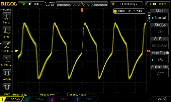

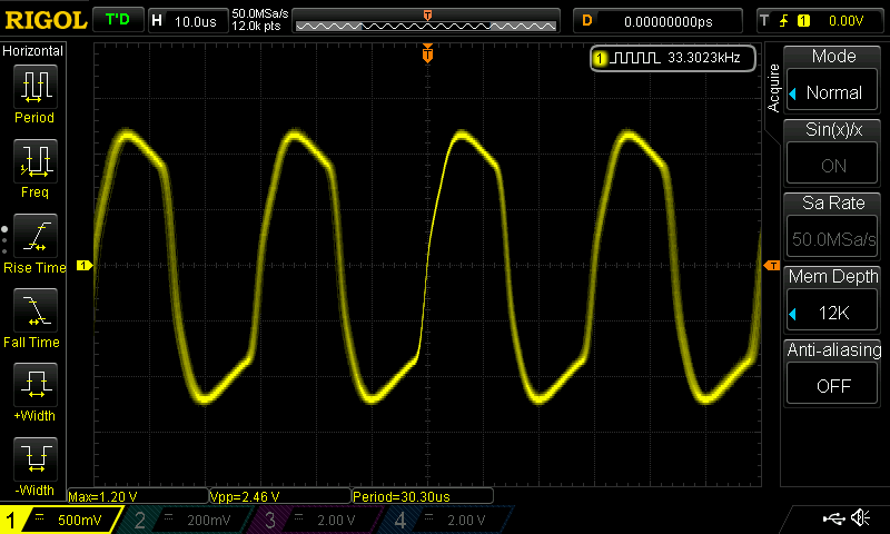

I emailed a similar message, but thought I'd repeat the post here, as it may be useful to others, if this gets resolved.
I only hear white noise coming from the output. With no external cables attached, I connect my scope to the inputs. Attached pictures show what I see with the scope at the inputs and outputs.
Measured at the input

Measured at the output with 50% gain. Frequency increases with gain.

Now I feel rather silly...
I forgot to ground the PCB to the panel components. Embarassed
