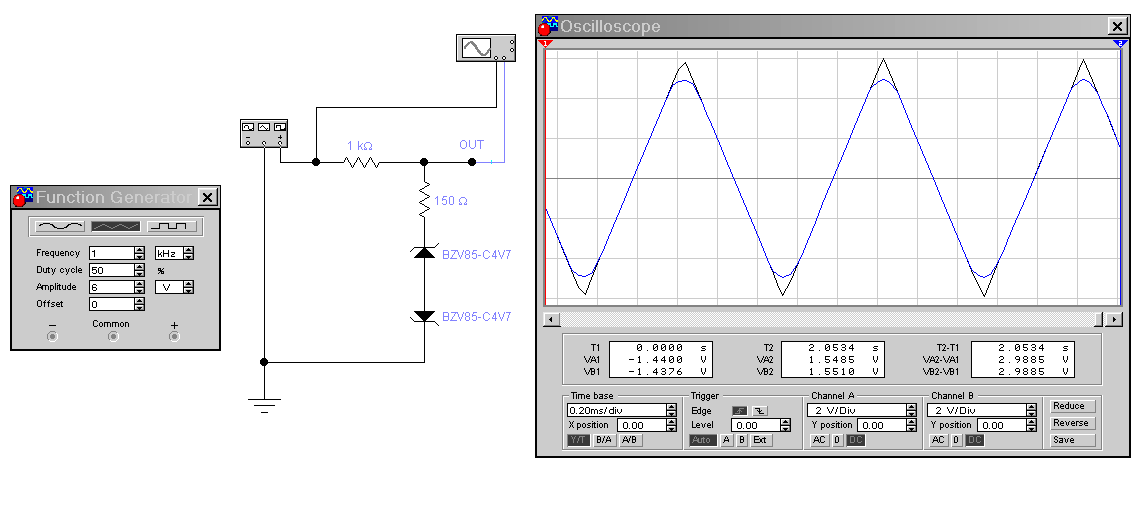

A simpler method could just use a couple of Zener diodes and resistors like I've shown below - no op-amps required !
This is from a circuit simulator and I haven't tried it, so not sure how it will sound.
For a sharper clipping effect, lower the value of the 150R resistor or for a more rounded effect, increase it.
The 1k resistor is for current limiting and may need to be increased in value but that will depend on the drive capabilities of the source.
BZX55C 4.7V (500mW) zener's will be fine.

Posts: 5841
PostPosted: Fri Aug 23, 2019 4:57 am    Post subject: Reply with quote  Mark this post and the followings unread
ah of course zenerdiodes DO work. It was the first thing that came to mind but I had forgotten you have to put them in series Embarassed
If you place them in parallel it doesn't work of course. It's actually a method I have used myself a couple of times to limit a voltage
so I feel quite stupid now.

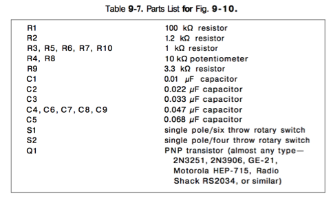

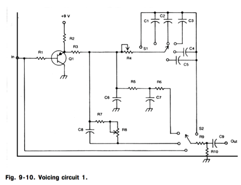

This is transistor pre-amp then 3 different clipping circuits (and a bypass) - it is for 9V but uses only resistors and capacitors.
I wonder if part of it could be easily converted to 12V? Maybe without the transistor.
I am not sure how the clipping would be trimmed to only be above 10v either. There must be a better way than "trial and error" that I could suggest Embarassed Very Happy
