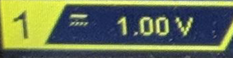

I'm building the Yusynth VCO-V2 using mostly parts I had on hand. For now, it's just the sawtooth part, none of the waveshaping yet until I get the core working. To my astonishment, I was able to get it working... kind of. At low frequencies, the waveform starts to sag more and more, instead of being a straight line.
Around 10kHz, it looks good
But down at 800Hz, it's not
The waveform looks like that of a capacitor discharging through a resistor, which led me to believe that, at low currents, my exponential converter isn't acting as a constant current source. To confirm this suspicion, I used the uA measurement on my multimeter, and with the coarse knob adjusted very low, I was drawing about 5uA when connected to +5V, 12uA when connected to +12V, and 0.3uA when connected to 0V. So at that particular knob setting, expo converter is acting more like a 1M resistor than like a constant current source. At first I thought this might be somehow related to my using hand-matched 2n3904s, but then I found some BC547Bs, got two that matched and had the same symptom.

Are you sure that your scope's input is set to DC (and not to AC)?
Posts: 1318
PostPosted: Fri Nov 08, 2019 12:57 pm    Post subject: Reply with quote  Mark this post and the followings unread
yes, its on DC

ah .. oaky, DC .. still it looks like AC coupling somewhere .. or a badly trimmed probe maybe.

Gah!!! I figured it out on my drive to work this morning and just got a chance to test my new theory. It should have struck me as suspicious that there seemed to be almost exactly a 1MOhm bleeding from my capacitor. Like an idiot, I was probing the capacitor directly, and not the buffer amp output. Guess what my scope's input impedance is...
In all my life I've never actually had to deal with probing anything that had microamp-levels of current in it, and I've been able to live in the happy oblivious assumption that scope and multimeter impedance is just "infinite" for my practical purposes. I've had to be careful of probe capacitance before, but completely forgot about probe resistance.
It's working perfectly now (and technically was before, whenever I wasn't probing)!
Thanks for taking a look. Yes, the trace has a DC offset that's making it look like it's set to AC coupling. It's caused by the fact that this dumpter-reclaimed power supply I'm using isn't isolated from earth (but the ground isn't shorted to earth either though). It's weird, the ground in my circuit is about -0.7V referenced to earth, so I couldn't ground my circuit to my scope (it would cause overloads on my negative rail). I did try plugging channel 2 into ground and plotting the difference between CH1 and CH2, and it really was just a DC offset, so that wasn't screwing anything up, just adding a bit more noise than is really there. I'm building a power supply for my new DIY case tonight, so that'll solve that problem.
