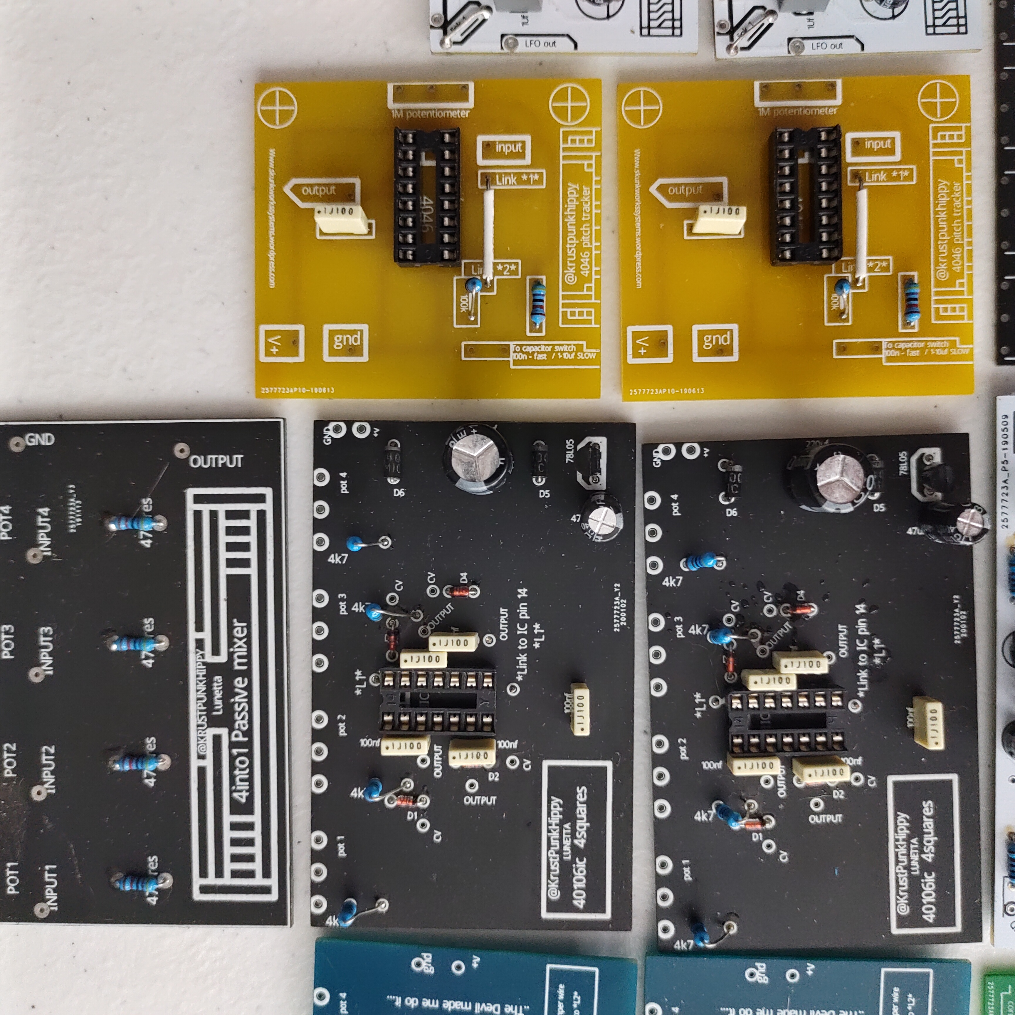

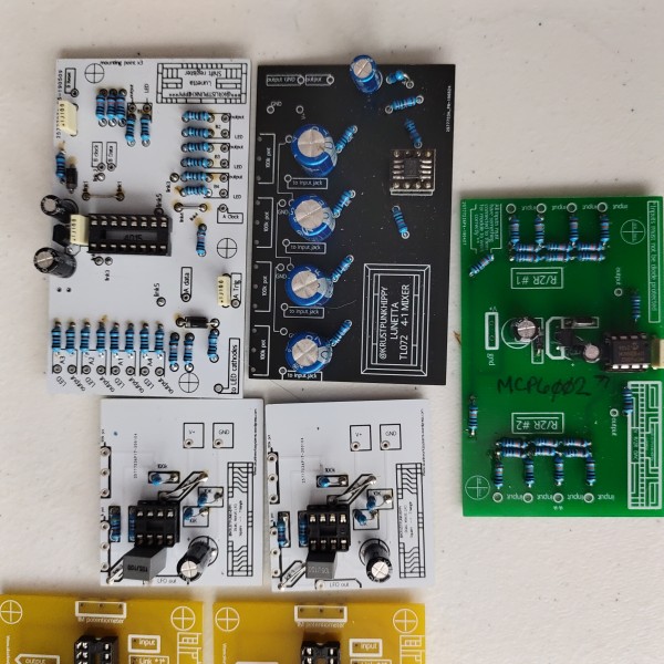

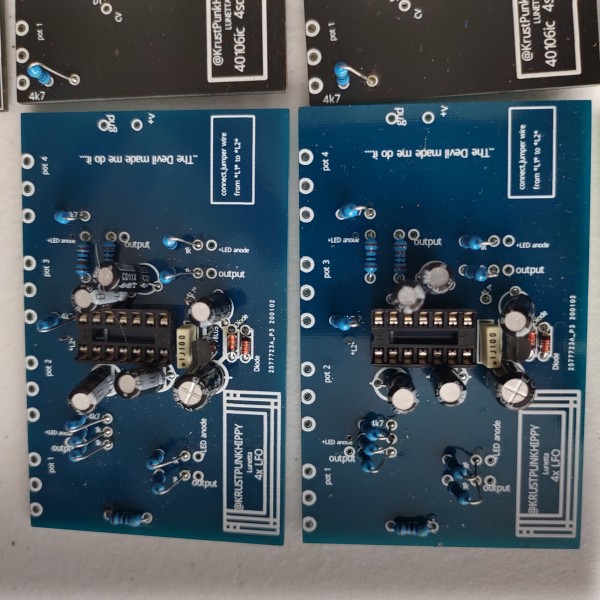

Against the spirit of Lunettas? Maybe, but appropriate for my skill level. I'm still at a loss about a few things in terms of interfacing these. One question would be "What kind of power supply would be sufficient to power all of these?" Has anyone else experimented w these? I struggle w electronics, my friend who had the skill set to teach me sadly passed away. We didn't have time to build a synth. Hoping I can cobble these together. Any insight or pointers are welcome!

I am not familiar with them but my guess would be a single DC supply somewhere in the 9..12V range.
5V willl posiibly work too.

Found this, but no info about the power supply: https://skunkworkssystems.wordpress.com/2019/06/03/mini-lunetta-nearly-done/
Given that there is a MCP6002 (Supply voltage: 1.8 V to 6.0 V) used at least on one board, my guess is that the power supply is 5V.
you are correct, though I do see what appears to be a voltage regulator (78L05 ?) on the R2R board with the MCP6002.
