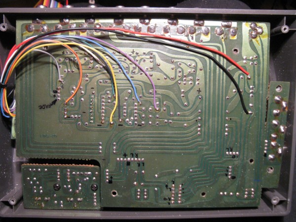

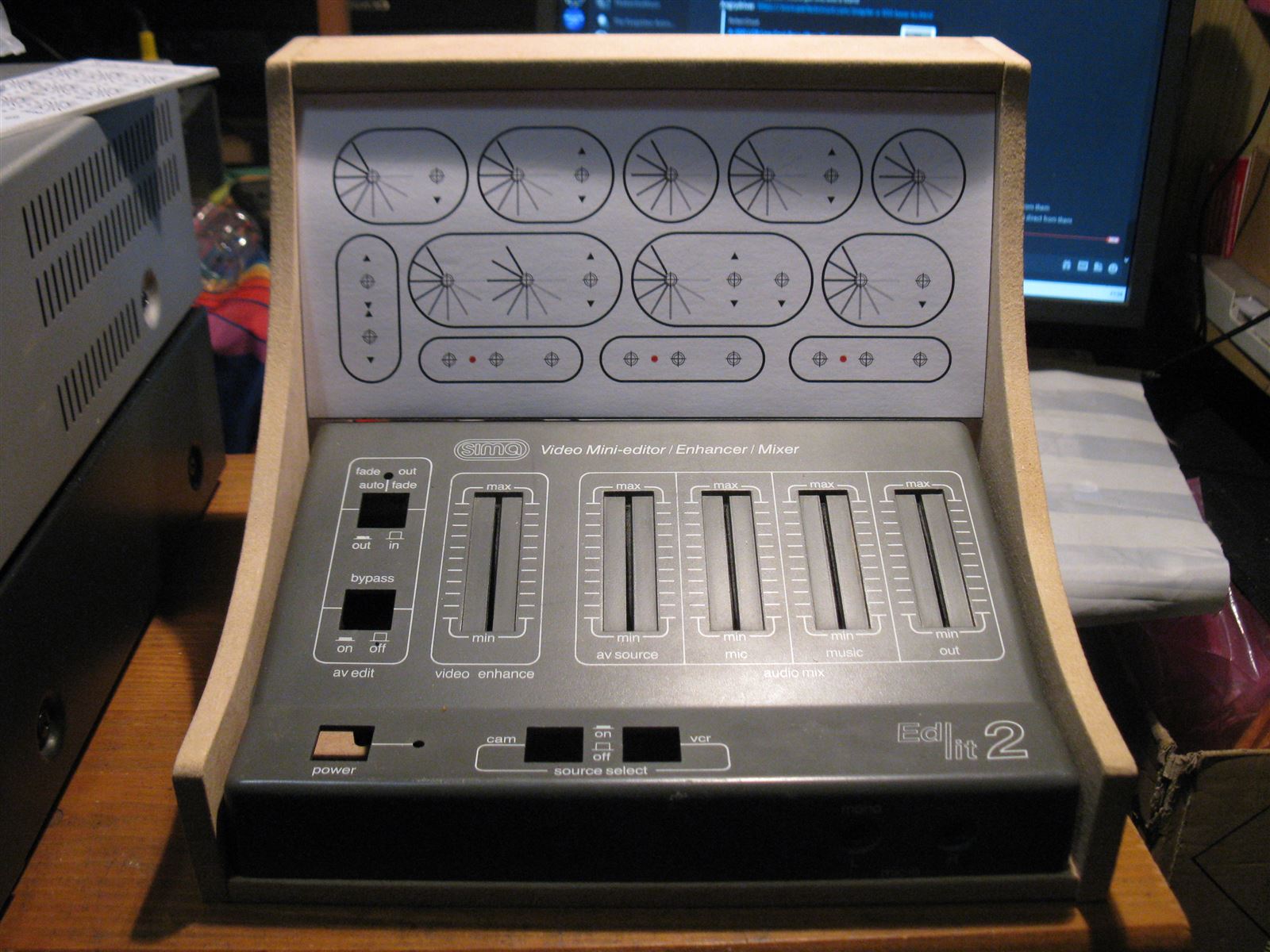

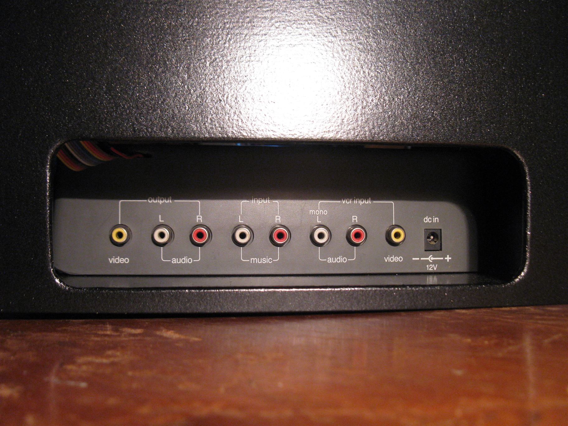

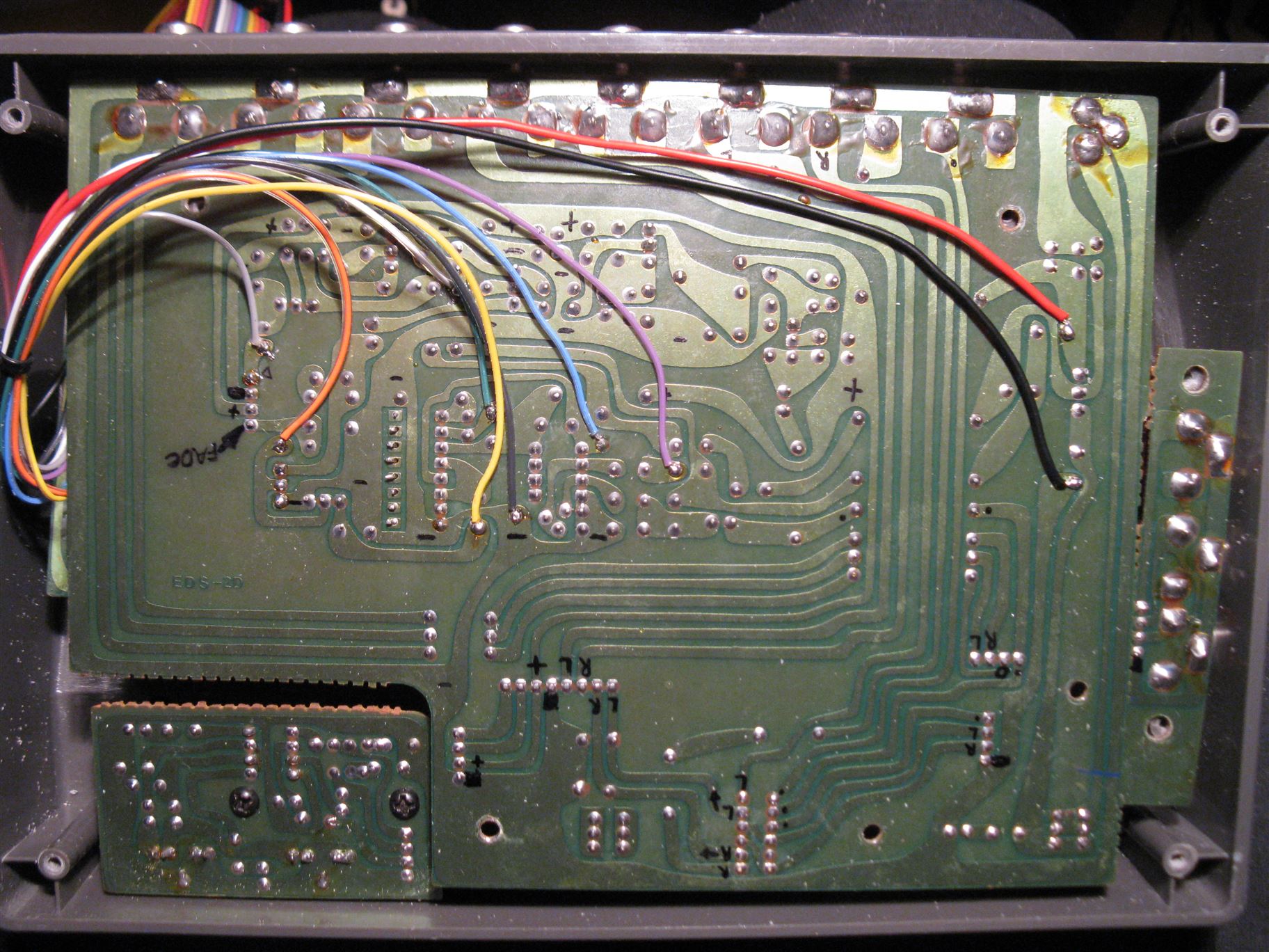

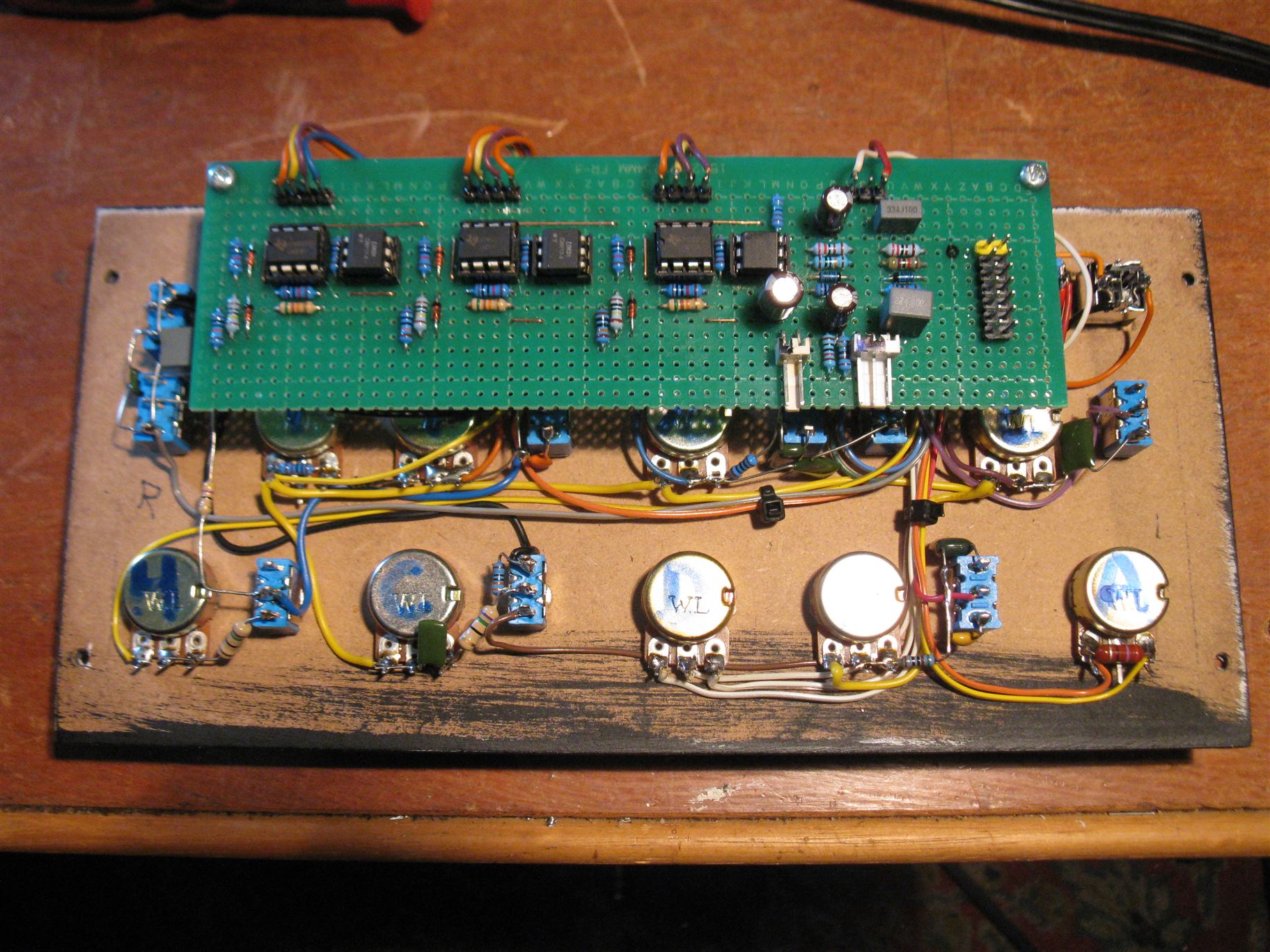

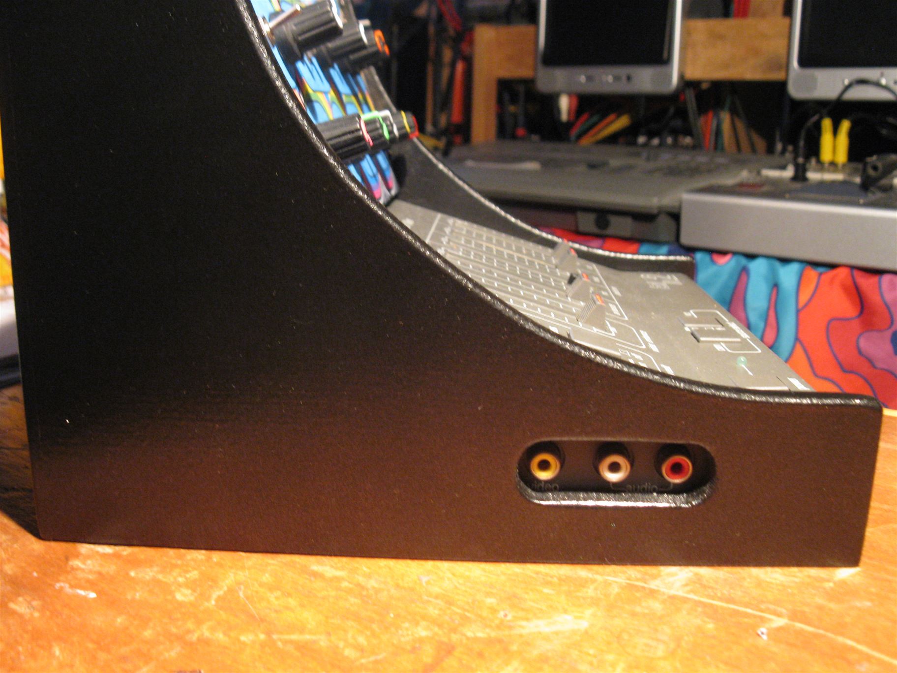

and some more photos,..
 Filesize:  240.57 KB
 Viewed:  176 Time(s)
 Filesize:  418.51 KB
 Viewed:  179 Time(s)
 Filesize:  415.24 KB
 Viewed:  165 Time(s)
 Filesize:  391.66 KB
 Viewed:  156 Time(s)
 Filesize:  286.38 KB
 Viewed:  167 Time(s)

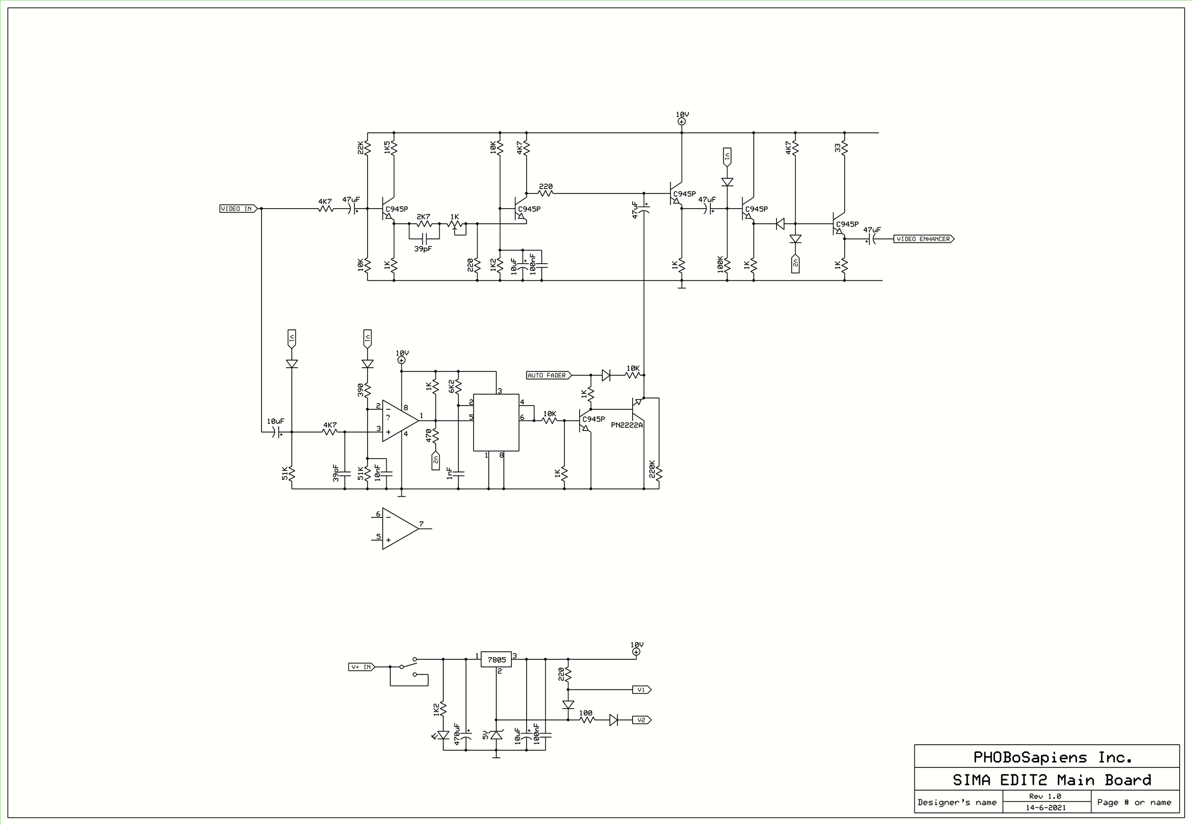

PostPosted: Sun Jan 22, 2023 11:59 am    Post subject: Original Sima Edit 2 Schem Reply with quote  Mark this post and the followings unread
Could you post the original (unmodified) schematic for the Sima Edit 2? I believe the enhance might come from the section on the main board? the section that looks similar to the AVE doesnt have a cap on the emitter of the pnp, so it's actually just functioning as an amplifier without high frequency boost.
Posts: 5862
PostPosted: Sun Jan 22, 2023 2:08 pm    Post subject: Reply with quote  Mark this post and the followings unread
this is what I got, can't promise it's 100% correct.
'Video Enhancer" connects to the pot of the other schematic.
 Filesize:  77.48 KB
 Viewed:  153 Time(s)
