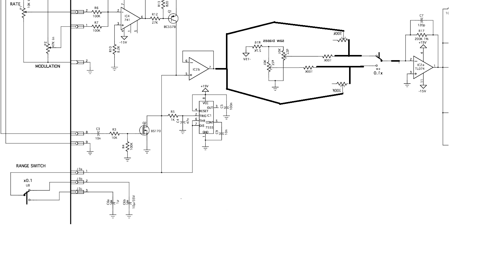

I am having some trouble with my LFO V2 as well. I have changed R17 for 100k (The 120p cap R17) and which has reduced the output.
I am having a problem with the X 1.0 & X 0.1 switch. After flipping it over to X 0.1, it introduces an offset to the Tri and Saw outputs. Seems to be about -1.7 V.
This is roughly what I have now;

i have to apologize,
i did not read ur post in such detail as i should have,
sry
but i have no idea rigth now how that amplitude drop can can happen.

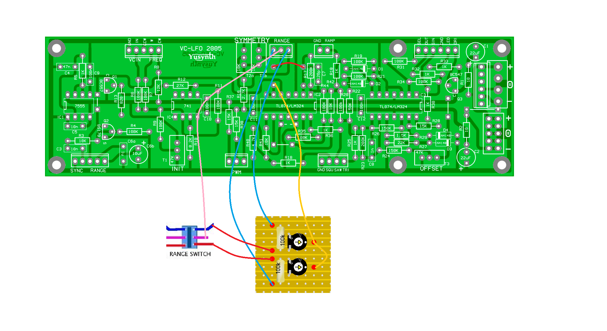

i only could offer an idea for a workaround, which i have attached.
This workaround would need you to solder out R14 and R15, solder in a bridge for R15, and a piece of Stripboard with two resistors (you could recycle R14 and R15) and two additional trimmer.

Had some time today so had a look at your suggestion. Am I right in thinking this will give me a way to adjust the gain of the signal from IC2 pin 7?
I wonder if this will have an effect on the offset that I am experiencing? The signal will be higher but it will still be offset by -1.7 V on X0.1 Sine and Triangle output.
Again, thanks for all your assistance g.gabba.

np it was a welcome task to think about,
the idea is to give you controll of the gain AND the offset for both setting (0,1&1) independently, with minimal effort.
the offset you can still calibrate on the two trimmers on the pcb,
the gain on the daughter board.
off course if you change the gain you will also change the offset,
so you will need to trimm them "thogether"
gl

It works!
Had a chance this evening to have another go and the relationship between the trimmers on the PCB and daughter board started making more sense.
It was kind of like trimming a VCO, you have to overshoot the mark with trimmer A, then bring it back down with trimmer B.

Resurrecting this thread because I had the same issue (DC offset on slow setting output) with my YuSynth LFOv2 and this clever fix was the only solution I could find online. It works perfectly - many thanks!
A quick additional note - you don't need to use two trimmers on the daughter board. Just use two 100k resistors for the 'fast' side and resistor + trimmer as shown for the 'slow' side.
Trim the LFO fast setting first using the fast Saw Bias trimmer to get a good triangle wave shape, followed by the Sine/Tri Symmetry trimmer to remove any DC offset. Switch to 'slow' and adjust iteratively using the slow Saw Bias and new Gain trimmers (they interact with each other) to get a good triangle wave with no DC offset. Don't touch the Sine/Tri Symmetry trimmer during this step.
