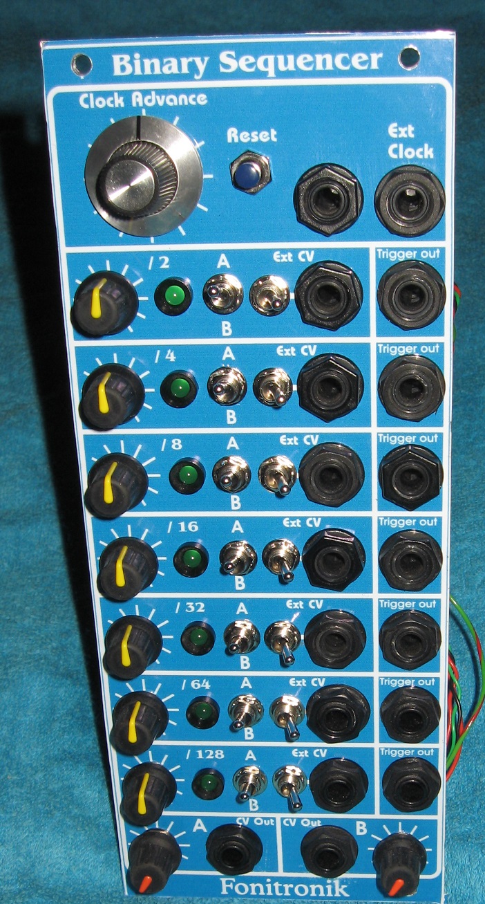

Finally got the order of stickers I need for a few Fonik projects, yay Very Happy .
A job to finish off from earlier this year , proper sticker for the binary sequencer I built.
On the tester layout I printed before , I changed the vertical row of led's & "A" / "B" switches around , during operation I found I was knocking the cv pots when switching , now the new layout has more finger space.

hey, this looks just great.
alas, it reminds me that i should turn this into a proper project. Embarassed
