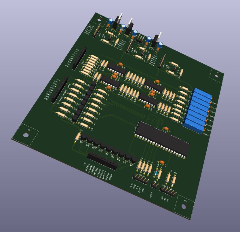

I was asked to build this for integrating an analog ratcheting sequencer into a studio’s MIDI equipment setup by a friend, the author of the Formant MSS2000 book.
So I decided to build this as a set of eight independent microcontroller controlled CV/GATE/CLOCK to MIDI converters.
Each converter consists of a pair of inputs (CV and CLOCK) and a corresponding CLOCK display LED.
At the top of the module you find three switches (again with indicator LEDs, because I just love Mr. Green LEDs) to select one of eight programs the module runs with.
Currently implemented is "Program 0" which was requested by my friend, but further functions are in development.

Wow, that is a beautiful build and very useful module, indeed! Thanks for the video.

Yes, I do. I've already started with the implementation of the next function, which will make the module being able to act as stand-alone MIDI sequencer additionally. When finished it can be selected by the top row switches.
The Peasant wrote:
Do you plan on making this available to others?
Yes, I provide circuit diagrams, gerber files and the software for free and programmed microcontrollers and / or pcbs for cost rate to everyone who is interested. Just send me an email ( carsten[at]analog-monster[dot]de, mail address can be found on my web site as well )

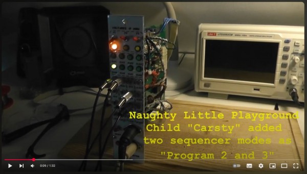

Fresh from the playground: 2 more sequencer modes as "Program 2" and "Program 3" implemented: "Moving Backwards" and "Knight Rider Mode" Mr. Green
See YouTube Demo 3!

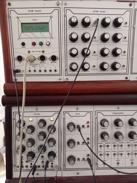

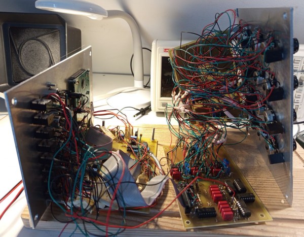

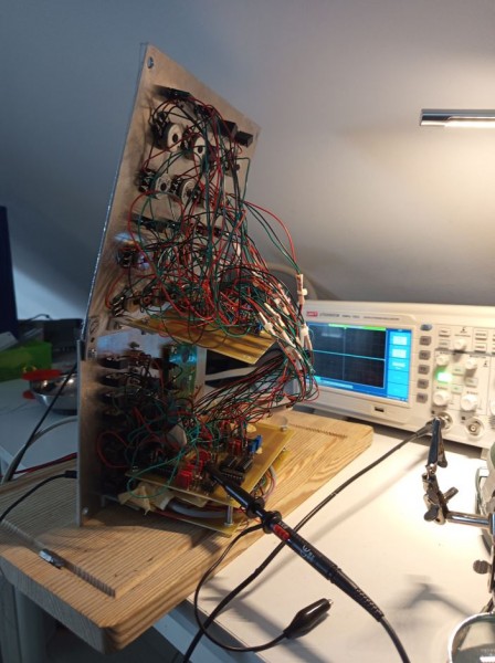

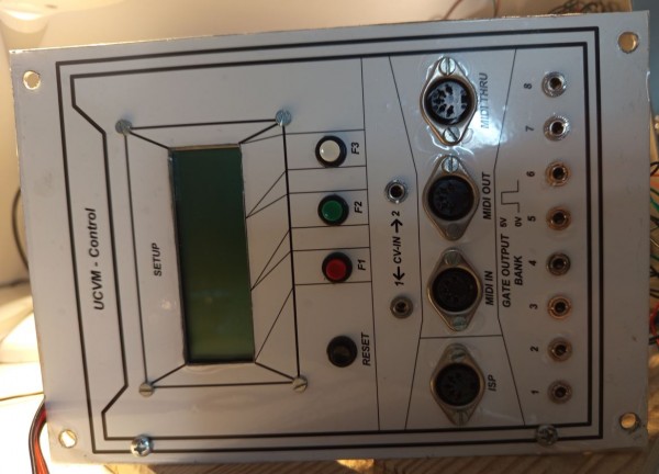

PostPosted: Fri Jul 11, 2025 5:47 am    Post subject: Formant++;
Subject description: UCVM - repair of a veteran

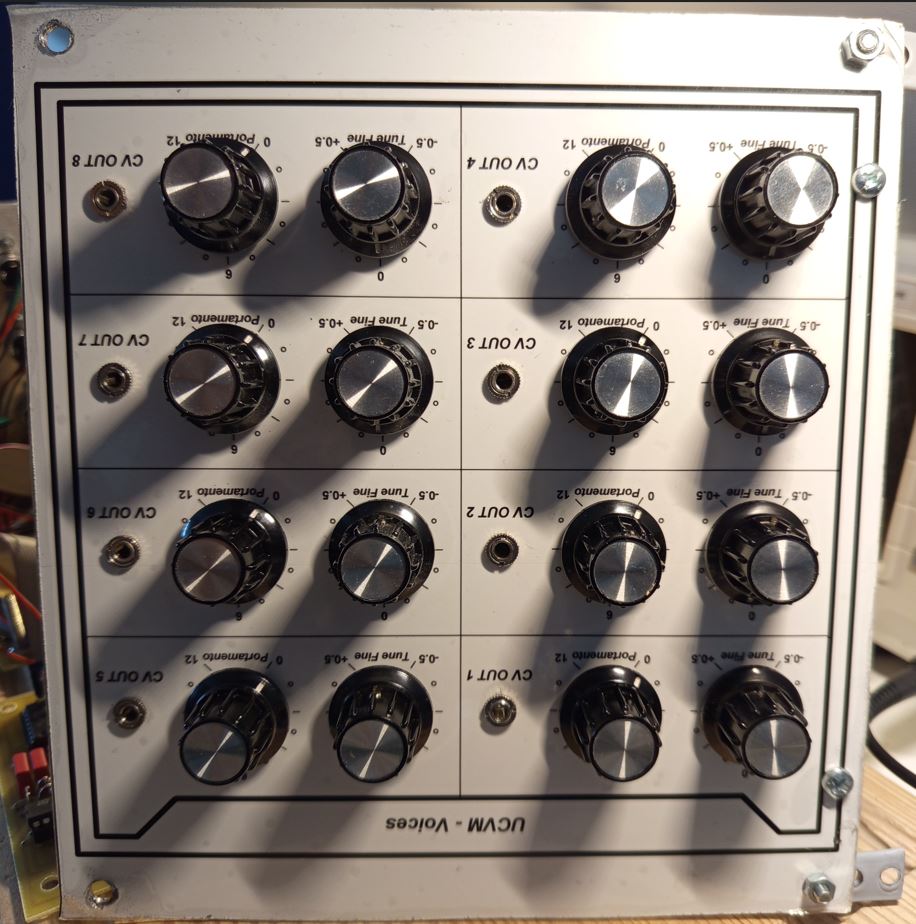

My first microcontroller based module, an 8 channel MIDI2CV/GATE - interface (UCVM) from 2004 did not boot any more. Reason was a dead ISP connector.
So I did what I was afraid of, I opened it after several years and entered the guts.
Enjoy the pictures.

Posts: 5881
PostPosted: Fri Jul 11, 2025 12:11 pm    Post subject: Reply with quote  Mark this post and the followings unread
some lovely looking stuff in here. Very Happy
I might not be building anything myself at the moment but I am watching from the sidelines.

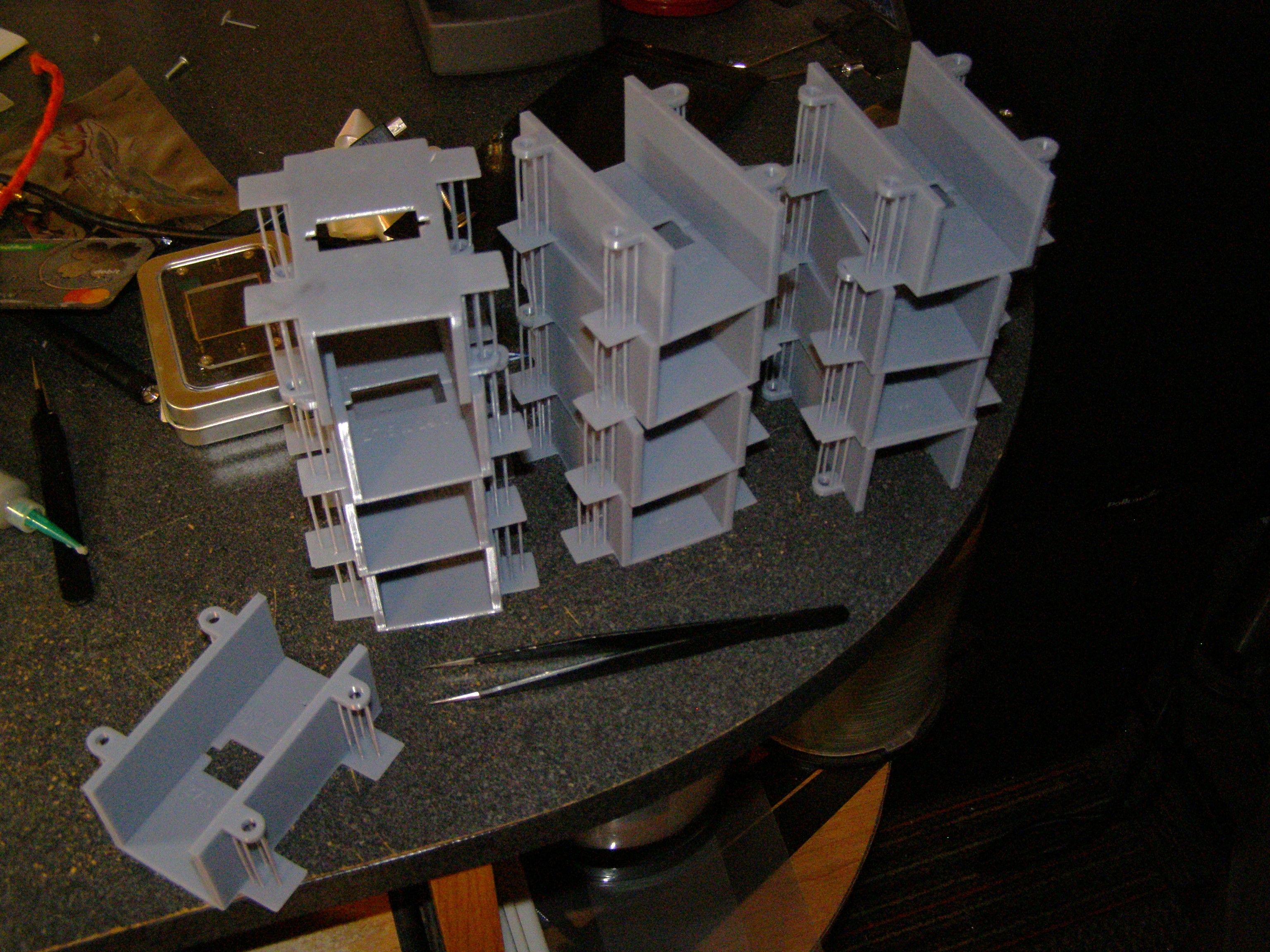

Years ago, when I began expanding my synthesizer system, I needed to add an additional power supply and the associated wiring in the new cabinet. Wanting to ensure reliability, I chose to use larger 18 AWG wiring and robust TE connectors. This became the new standard for all added modules, and I built distribution cables to supply power accordingly.
Over time, however, I became less satisfied with the loose cable runs — they weren’t as secure as I’d like, were vulnerable to vibration, and didn’t look particularly neat. Still, redesigning the bus system was one of those "I’ll get around to it later" projects.
As I started adding microprocessor-based modules, I wanted to integrate a CAN bus to support global inter-module functions. That provided the push I needed. I realized I could use my 3D printer to create custom channel segments that support both the existing TE power connectors and new Molex CAN connectors.
The snap-in feature of the TE connectors made it relatively easy to design 3D-printed mounting holes to accommodate them securely. Since my printer's bed is only around 12" wide, I chose to print 3" channel segments (matching the Aries 3" module width), then arrange them end-to-end to form a continuous channel along the cabinet.
This is still a work in progress, but I recently completed the first cabinet channel and took a photo to show a before-and-after comparison — the top cabinet still has the original loose power cables, while the bottom cabinet uses the new channel. I’ve also included a picture of a few channel segments as they come off the 3D printer. For efficiency, I print them three at a time per batch.

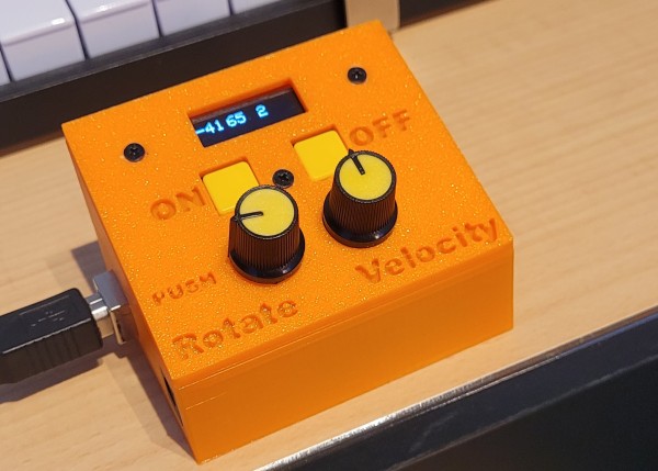

I've made what I call a DRONER, It's a standallone module around an Arduino UNO, programmed as a native midi device ( google HIDUINO) for sending Midi over USB.
You can choose a note, change velocity and pitch in real time.
The noteOn is sent when the ON button is pressed while the noteOff is sent when the OFF button is pressed.
When noteOn is active, I can change Pitch with a rotary encoder, and the Velocity can be set with the potentiometer.

PostPosted: Sat Jul 19, 2025 2:19 pm    Post subject: Re: Formant++;
Good troubleshooting! Seems that problems are caused by loose connections more often than not. Rare when it is some exotic problem!

That's a fine application for an Arduino-based device and a cool-looking case for it. Thanks for the video!

simple but very effective, nice build

I wasn't happy with the software and have been tweaking today.
Much better functionality now.

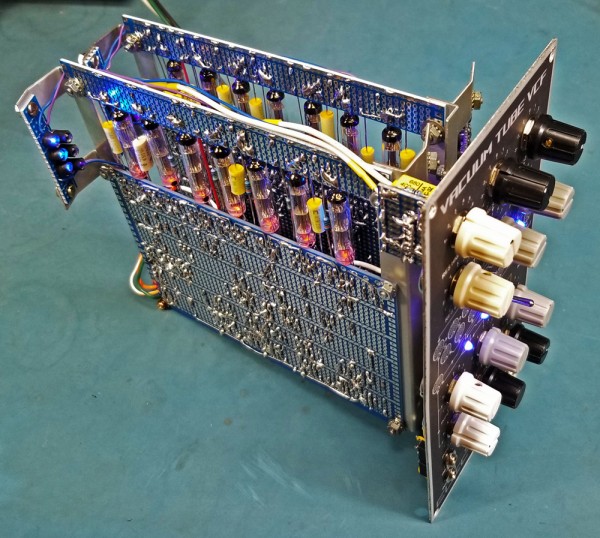

PostPosted: Sun Aug 10, 2025 8:57 pm    Post subject: Reply with quote  Mark this post and the followings unread

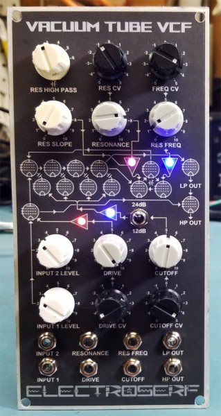

I have completed the VCF module, 14 tubes in this one. Working on a video now.

Posts: 1452
PostPosted: Tue Aug 12, 2025 5:02 am    Post subject: Reply with quote  Mark this post and the followings unread
Take care,
Doug
Indeed -- definitely want to hear your filter. 14 tubes? Wow. I don't think old TVs had that many tubes!

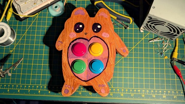

PostPosted: Wed Aug 20, 2025 7:11 am    Post subject: Reply with quote  Mark this post and the followings unread
It's not a synth, but it makes noise.
My daughter was trying to make a little animal with buttons out of paper, but was having difficulty with the buttons. I suggested wood as a better option. Since I had to be involved anyway to cut the wood, I offered to make the buttons beep when pressed.
My daughter drew the shape and painted it. I cut it out and added the electronics.
I kept it as simple as possible. It is four 40106 oscillators with fixed resistors values for different pitches, and a single amplifier chip (LM386), all running off a 9V battery.

Your buttond reminds me of a device I made for a brother of mine: It works like a bass guitar and the buttons are arranged accordingly.
With the black and red buttons one can set the octave for the lowest snare ( the yellow buttons).
That's awesome! A very unique layout. Nice work Smile
That is delightful! I can see that she really enjoys it.
