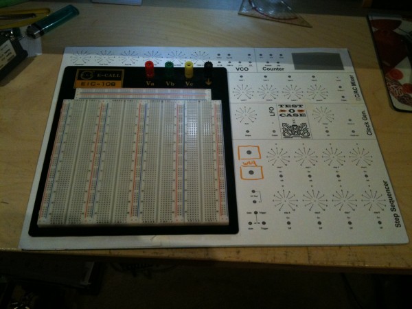

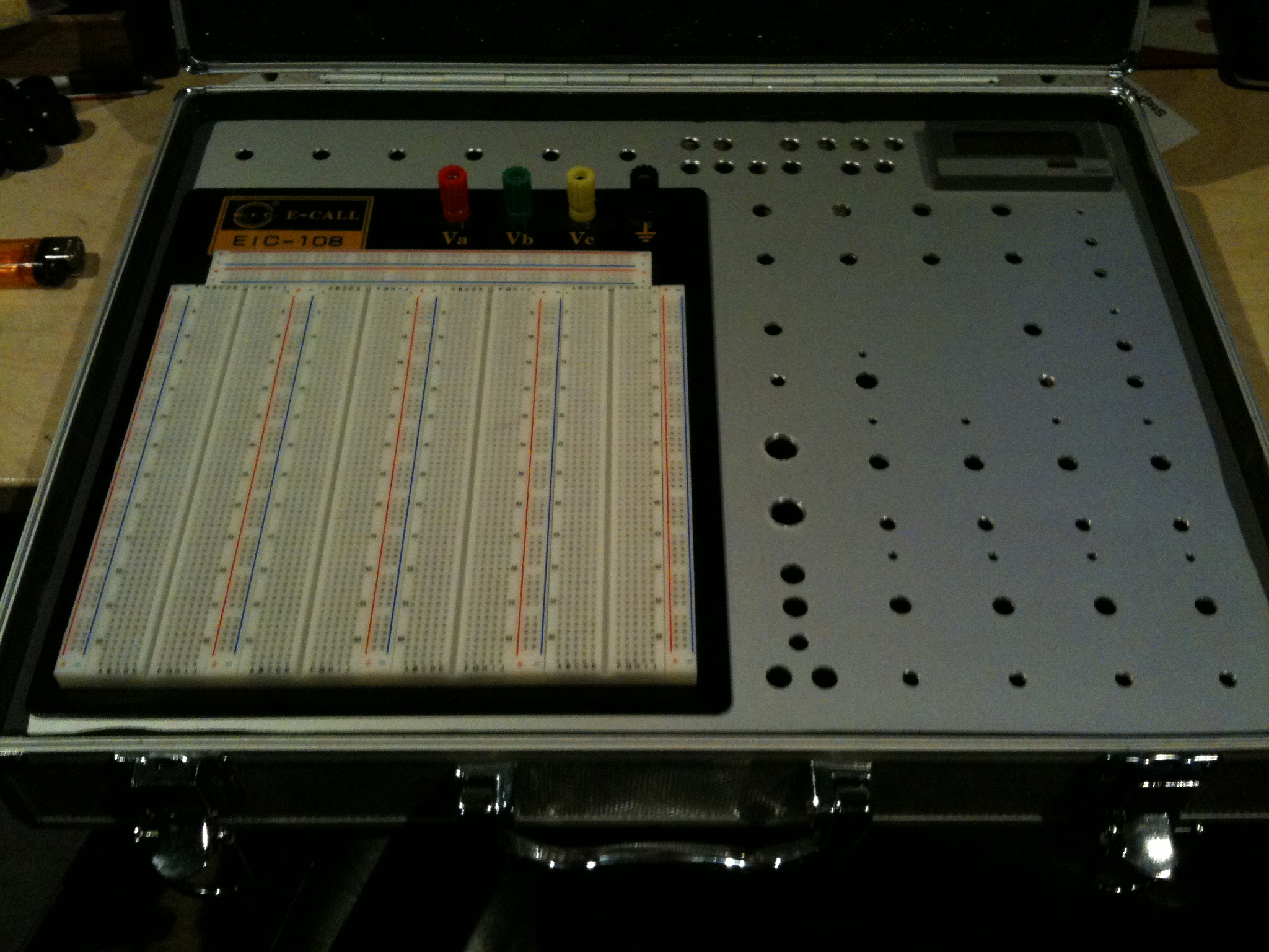

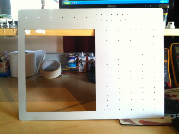

The plan is to build my breadboard into a case and add some modules.
With FrontDesigner i created the art layout and i made a aluminium front
that fits the case.
The front panel is ready for the artwork.
The modules:
Clock generator
Sequencer 8 steps
DC/AC mixer
LFO
VCO
Counter module
So far, TEST'O'CASE
Chris

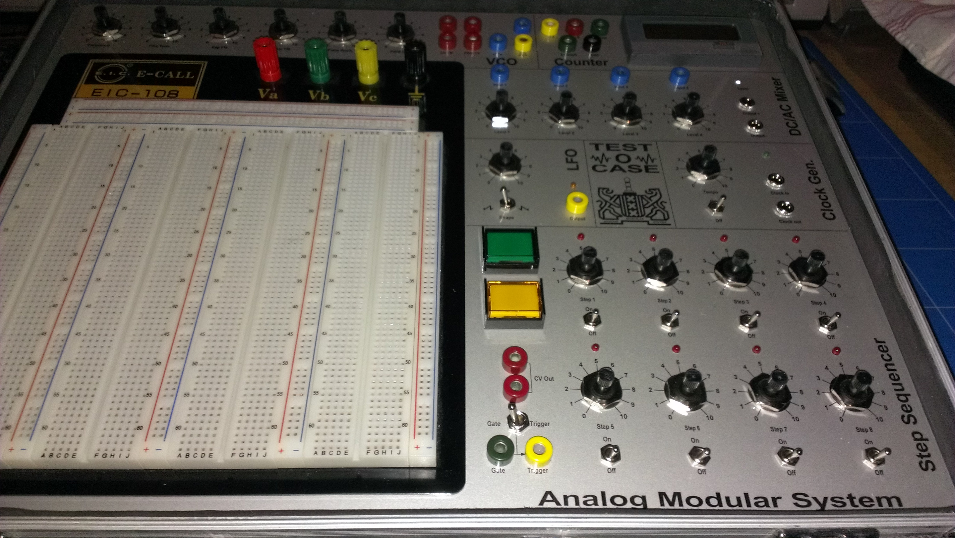

Update !
All the front panel parts fits and I also made the graphics.

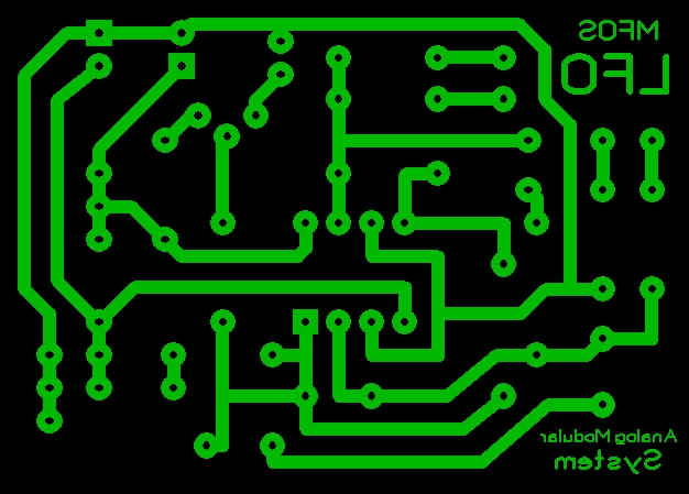

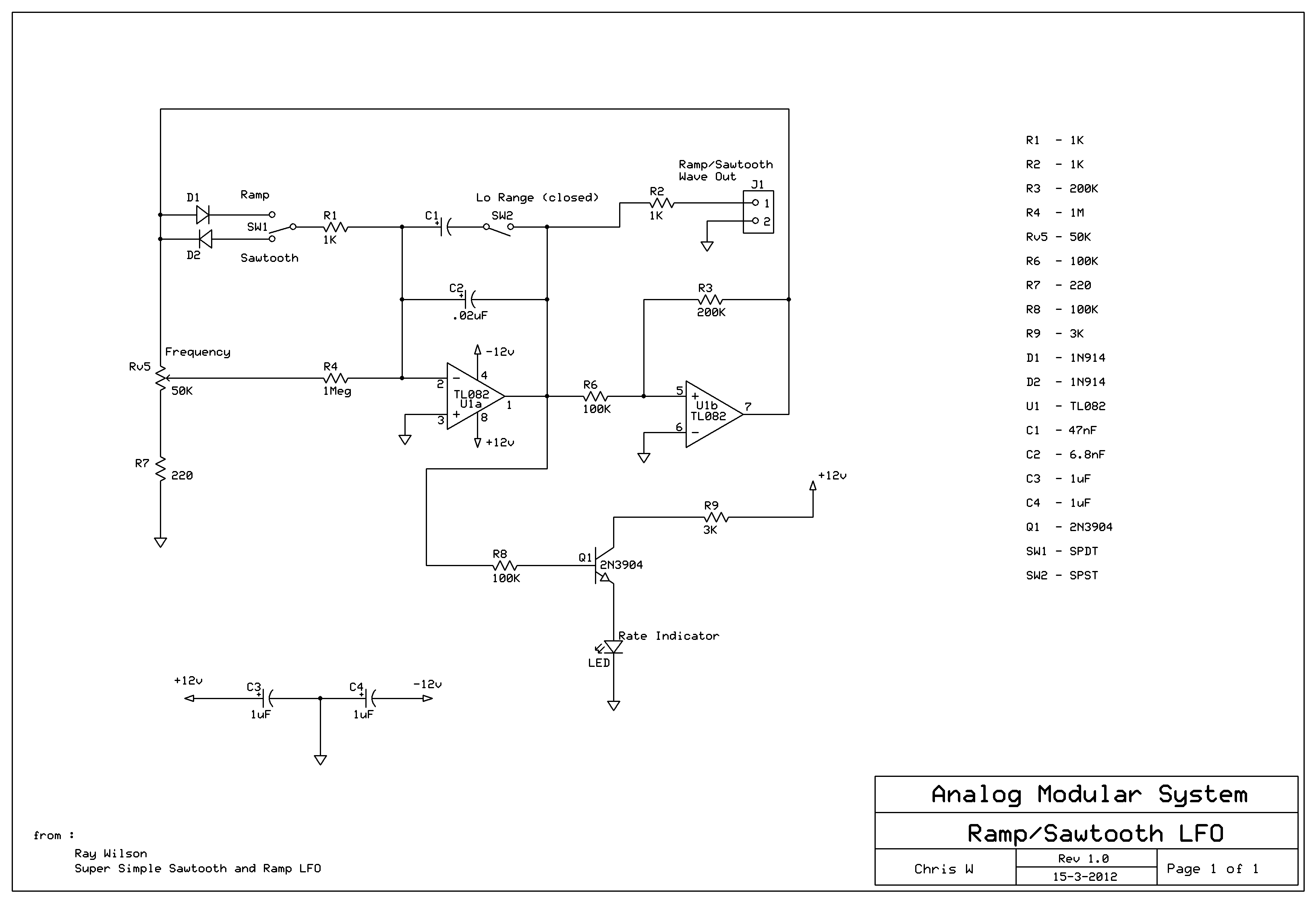

Update !
Test'O'Case
Front panel is ready and I think it looks just fine.
The module I start with:
LFO (Musicfromoutherspace)
Soon more.
