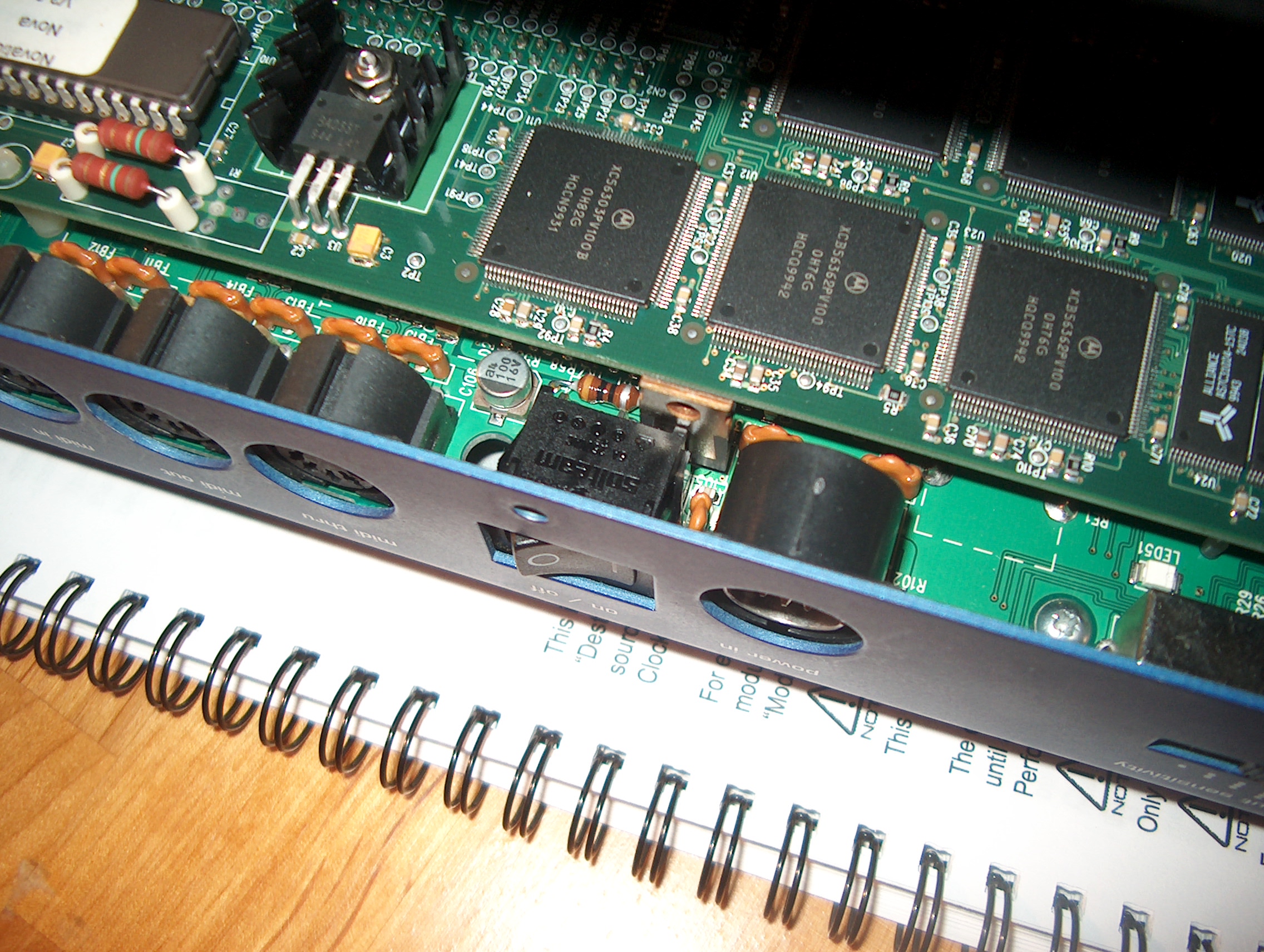

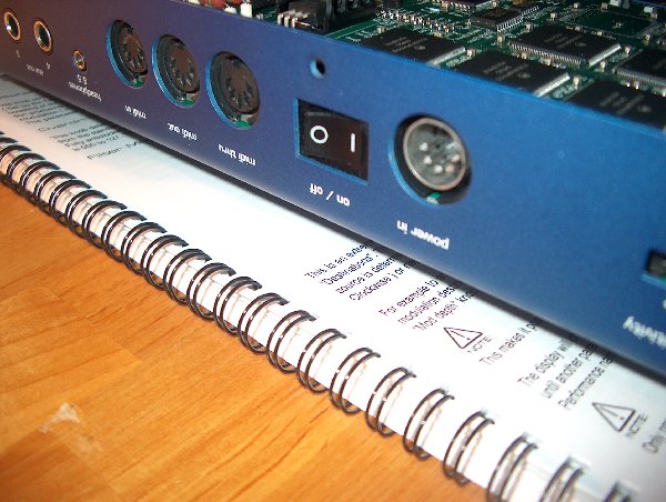

All is NOT well in Novaland! Only 6 weeks of owning the Nova and already a problem! Mad I bought my Nova laptop about a month ago on Ebay: thing was packed great with no sign of damage to the box. It sounds awesome, a nice compliment to my other synths. However, 2 weeks ago as I was doing some Pro Tools editing I look up and the Nova is off! I didn't turn it off....but it turned itself off! So I turned it back on....and noticed that in doing so just touching the on/off switch turned it on...not pressing the switch but just touching it with a finger. Odd. Confused
In the past 2 weeks though it's been playing games with me. Some days I turn it on and it stays on and some days it goes off and won't STAY on. I've got the problem down to the on/off switch...there's play in the on position where it can rock back and forth and it seems like the switch is not locked in the on position. I opened the Nova up and looked inside, evrything looks fine to me...there's not much that can come loose or unsoldered as there's no wires or ribbon cables in there. But like I said I suspect the switch and I would repair it myself but the cpu is Sooo close to the switch solder points(as you can see in the picture) that I dare not DIY it. Shocked
I've written to Novation and they referred me to the nearest repair center, I'll be taking it there next Friday but I thought I'd post here and get another opinion before I go. Anyone seen this issue before?

The switch looks like soldered to the board, and it looks like the board has to be taken out to reach the soldered leads ... that's one thing,the other would be to find a replacement ... unless you'd permanently bridge it and turn the machine on/off with the power supply ... but then again when you don't trust yourself to do it maybe it's best to have it serviced.

PostPosted: Fri Sep 26, 2008 3:00 pm    Post subject: Reply with quote  Mark this post and the followings unread
From what you wrote everything points to the switch. It shouldn't switch by touching it and when it's in one of it's positions it shouldn't wiggle, but I could imagine this happening when the internal spring doesn't work anymore. Maybe it jumped out or something broke internally so the spring could move a bit.
I'm surprised 1 people in repair shops are able to replace switches Laughing but they should be if course!

PostPosted: Fri Sep 26, 2008 6:15 pm    Post subject: Reply with quote  Mark this post and the followings unread
Ok, no more horror then pale
On/off switches often are bi-stable, they lock in both the on and off position but when you try to set 'm in between they'll flip to one of the sides. Anyway, this uses a construction with a spring that forces the switch into either one of the positions and that's what I meant with the internal spring. I tried to find some how-does-it-work pics through google, nothing simple showed up ... you should try to take one apart once!

PostPosted: Sat Sep 27, 2008 2:36 am    Post subject: Reply with quote  Mark this post and the followings unread
Intermittent switch bounce could very easily confuse the internal logic. So you could end up with parts thinking they are on and parts in inconsistent states. Does it all come back if you shut it off, wait a few seconds, and turn it back on?
Another possibility is cold solder joints somewhere in the PSU. Close inspection would be needed for that too.

PostPosted: Sat Sep 27, 2008 6:03 am    Post subject: Reply with quote  Mark this post and the followings unread
Yeah, the unit comes back on fully functional. Two days ago it actually stayed on almost the whole day when I moved it to a table. Yesterday it just wouldn't stay on for more than a few minutes. Rolling Eyes
Well, the people at HighTech electronics will have to consider this as a cause...I looked at the thing and the cpu is soldered to the display board and it's hard to see in between them. I looked as best I could with a flashlight but.... Question

PostPosted: Sun Sep 28, 2008 12:25 pm    Post subject: Reply with quote  Mark this post and the followings unread
I think it's the switch then, and the spray of transients from bounces confusing the logic. At least from here, not seeing it.
Good luck with it mate. I hope it works out ok.

PostPosted: Sun Oct 05, 2008 5:27 pm    Post subject: Reply with quote  Mark this post and the followings unread
Well, it was the switch. Not only that but the solder points were bad where the switch meets the main display board AND the solder points where the power connector meets the board....that's why the unit would switch off when my finger grazed the switch...so in 2 places. $62.50 was the basic bench charge for the fix in this case. I haven't used the Nova yet but I'm going to assume it's fixed. These guys at HighTech know their stuff and were super nice guys to boot. I dropped it off on my way to NH and picked it up 2 hours later on my way back to MA. Smile
