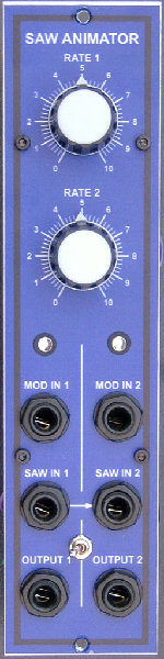

I finally finished the Sawanimator module, it is amazing.
I added the switch to join the 2 processed saws and the non processed one
in one output as Yves described in another thread.
Thanks Yves again.
Here are some pictures:
Sawanimator Front
 Filesize:  109.77 KB
 Viewed:  322 Time(s)
Sawanimator Back
 Filesize:  102.68 KB
 Viewed:  317 Time(s)

That's an interesting way of extending the board, gluing it at one end !... What I had in mind and did on my saw animator was to screw the add-on board above the main pcb using 20mm spacers

Yeah, at the beginning I tough the same, but in one side there is the power
socket, so isn't practical to have the board on top of that, and in the other side
I have those big orange caps, and no spacer big enough so I ended gluing the
2 boards together (and soldering the the 2 ground planes at the back).
