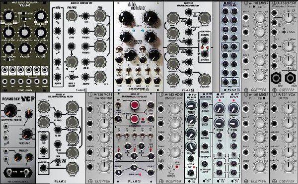

Howdy all, I'm new to this forum. I found out about it through a SOS article modular systems and I wanted learn and get some advice. I'm am new to modular synths and have an idea for a system, but I wanted to see what others thought. Thanks for taking the time to read this.
Here is what I came up with (6U Eurorack):
Top (from left to right, though I know configuration changes frequently):
Cwejman - VCO-6 (or tiptop z3000, it's cheaper) VCO
Plan B - Model 15 Complex VCO
Livewire - Dalek Modulator
Plan B - Model 24 Heisenberg Generator
2HP Blank
Plan B - Model 31 Buffered Multiples (or 2x Doepfer A-180s w/out 2HP Blank)
Doepfer - A-138 Linear Mixer
Doepfer - 138d Crossfader
Bottom:
The Harvestman - Polivoks VCF
Plan B - Model 11 Evil Twin Band Pass Filter
Doepfer - A-120 Low Pass Filter
Plan B - Model 28 Programmable Tap Clock
Doepfer - A-140 ADSR
Plan B - Model 38 & 38A Elf ADSR & ADSR Expander
Plan B - Model 37 Elf LFO x2
Doepfer A-138 Logarithmic Mixer
Doepfer A-131 Logarithmic VCA
Does anyone have any suggestions? Thanks again!

I'd second Antimon's point about Plan B. If you can get them at AH where they are reputed to be available, and if you get delivery, and if they work, then they are very creative and good modules. I haven't bought any Plan B myself, but there are so many other people offering modules that you might want to consider them.
Just curious, why did you choose Eurorack as your standard? There are many formats available, and each has advantages (and arguably some disadvantages). The Eurorack format has been criticized for being small and crowded, but that could also be seen as compact.
Also why did you choose the A-120?
If you didn't have the Plan B VCO, what other VCOs would you consider? I'm not suggesting one because I'm not sure what you're trying to achieve with your modular, other than interesting sounds.

Thanks for the replies! I started looking into the Plan B issues and that kind of scares me. I see where you're both coming from. I do have a Module 11 Evil Twin on it's way (and it is on it's way, I didn't buy it from them) that hasn't been used. It is unfortunate that Plan B is having issues, from what I have heard of their modules, they are very intriguing.
As far as why I picked the Eurorack format is because of space primarily. As you had mentioned, it is compact. Eventually I will probably build something in a different format when I move out of where I'm staying, but until then, space is key. Plus, they have the polivox and malgorithm (though I have not included the latter in my current build).
Other VCOs. I really was looking at the Livewire AFG. The thing holding me back there was that it takes up a lot of space. I wanted to make sure I had enough room for utility modules. The Tiptop z3000 and Analogue Systems r95e also looked interesting.
I am definitely up for suggestions in filters, VCOs, and utilities. The A-120 was more along the lines of "I don't know what other filter I should use so I'll stick with the standard." I am completely flexible. The only thing I have is the A-138 Logarithmic Mixer, the A-131 Logarithmic VCA, and the Model 11.
As far as what I'm trying to do. I like industrial, hardcore trance, dark electro, and stuff like that. I want to make noise, make cool bass leads, weird noises, and just really creative sounds that you can't make anywhere else.
Not sure if that helps give you an idea or not, but thanks. I look at some more options to remove some of the Plan B stuff (so I don't have to deal with what others are unfortunately dealing with).
Cheers!

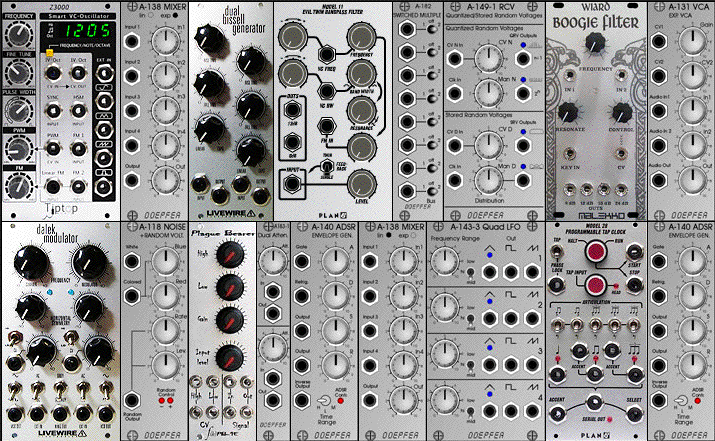

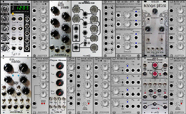

Well, I've made changes. Being leery of the Plan B modules, I removed a few. However, I already have a Model 11 and Model 28 in the mail so I'm going to keep those. Plus I really like the ELF LFO because of it's size and the multiples fit. So if I can find them not through Plan B themselves (I know that's not the name of the company but it's easier to type).
The plan is for this to be expanded so I wanted to make sure I nailed out the components I really am interested in and if I'm missing a few utilities, I can add them later. This goes for some of the other fun modules.
I dropped exchanged both VOCs for a TipTop z3000 and AS r95e (the picture shows it without the fine tuning knob). This is a slightly cheaper setup but still should give interesting results.
I decided to keep the Dalek Modulator instead of the A-114 and I added the A-118 & Dual Bissel Generator to replace the Model 24.
Moving the tap clock up, and dropping the A-120 (You're right, there are better modules out there that are more interesting), I was able to get in a Wizard Boogie Filter and a Plague Bearer.
I do not have an A-115 (Audio Divider), the A-116 (Waveshaper), or the A-136. Other than that, this seems to be a good variation of the Doepfer "Basic System 1" in some fashion or another.
So the question is, do I swap out the Plague Bearer for either the A-115 or A-136? It seems like that Plague Bearer is similar to the A-136 (not completely). Am I really missing anything without having the A-115, A-116, or A-136? I can always expand those later so I guess the question is which might be more beneficial?
Thanks again all for the help.

PostPosted: Thu Jul 23, 2009 3:47 am    Post subject: Reply with quote  Mark this post and the followings unread
Have you ever seen the ELF modules in real life? They are SMALL and way too crowded.
The Analogue Systems frontplates don't perfectly fit in a Eurorack system which results in gaps. I'm pretty sure the upper row will not fit the case because of that.
Are you sure you'll need 3 and a half (Plague Bearer) filters in your starter system?
I would also throw out the Plan B Module 28 for now.
If you planned a non-rack case I would directly go for 9U. Sooner or later you will need the space (e.g. for a A-155 sequencer) and they have a better cost-effectiveness.

Thanks for the reply.
You're right about the 3.5 filters, I was looking at it later and realized that was bit overkill and decided to tone it back down to two for now (Polivoks and Evil Twin). When I move to a larger system, I'll add in that Boogie filter, I don't need it right now.
For the Analogue Systems, you mean the faceplate is actually larger? So though they are saying on the site that the r95e is 12HP it's actually larger (by a small amount). That's not good Sad. I was actually looking forward to that module as it tracks so well. On that note, hypothetically, were I to have one complete rack of AS modules, would they not fit because they are all slightly too big?
Unfortunately the Module 28 is one of the few I have, so I'll have to make use of it.
As far as LFOs go, they do look really small, but on the other they don't take up much room. Do you have a a recommendation? I was looking at an A-143-3 for the sake of having four in one. At least in the long run, I wouldn't need to worry about LFOs until the system got significantly larger. Still though, if you have any suggestions, I would be most interested.
Rack wise, I got a good deal on a bare subrack and can get more for the same price (1/4 the cost of an actual Doepfer rack). The only thing is I have to provide my own power supply and distribution board. I bought two CGS distribution PCBs (which were like $7.50 US each) and I have a couple power supplies that I can use. So other than some minor wiring to get a switch and some mounting, I have pretty cheep racks (6U). Don't worry though, I will be expanding Wink.
If I swap out the r95e, the boogie, and the plague, what would you recommend? I can replace the ELF LFOs with the A-143-3, but is there anything in particular I could use?
Thanks again!

PostPosted: Thu Jul 23, 2009 12:32 pm    Post subject: Reply with quote  Mark this post and the followings unread
No, I'll quote Schneiders Buero:
The mounting holes on the face plate have a slightly different positioning. When mounting an ASys module next to a Eurorack module small gaps of each 2.5mm (0.5 HP) width will occur to the left and right.
I have a A-143-3 and that would be my recommendation. They are not too crowded, all jacks are on the right and they have the main functionality which I need most. When I need a more complex LFO I use my VCOs (AFG, Z3000).
That's good, they are better than the Doepfer ones because you can't put the plugs in wrong. I don't know why Doepfer don't make their distributions PCBs that way, too.
Hmm, for the Plague Bearer I would recommend Attenuators, else the CV-Inputs are totally useless.
One VCO + Weirdo Dual-VCO should be enough VCOs for the beginning, so I would just keep the r95e out without a replacement VCO.
I have added my suggestion (including a A-149-1 random CV generator as you seem to like weird stuff).
I have located all audio sources to the left (but remember that you can use filters with resonance as standalone audio source, too) and the non-audio stuff mostly in the lower right corner but if you place your PSU elsewhere you should put the non audio-stuff above the PSU.
With the placing you have to experiment a bit and see which modules you'll use how. E.g. if you use the exp mixer mainly with the filters (and not the VCOs) you should place it closer to the filters, etc. .
