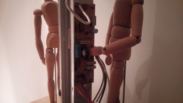

Found an organ spring tank of about 40cm in length.
The two springs are noticably of different flexability.
Even the original amplifier is attached to the tank.
I'm sure there must be some nice things to do with this item.
So, any tips and recommandations?

I love spring reverb. Those super models you have showing it off almost destract me from what a nice reverb you have there. Very Happy
I have no great recommendations. I just pipe some signal through mine and enjoy what comes out the other end. I am however very excited to see what you come up with.
They do make an extremely cumbersome analog puls to sign wave converter.
