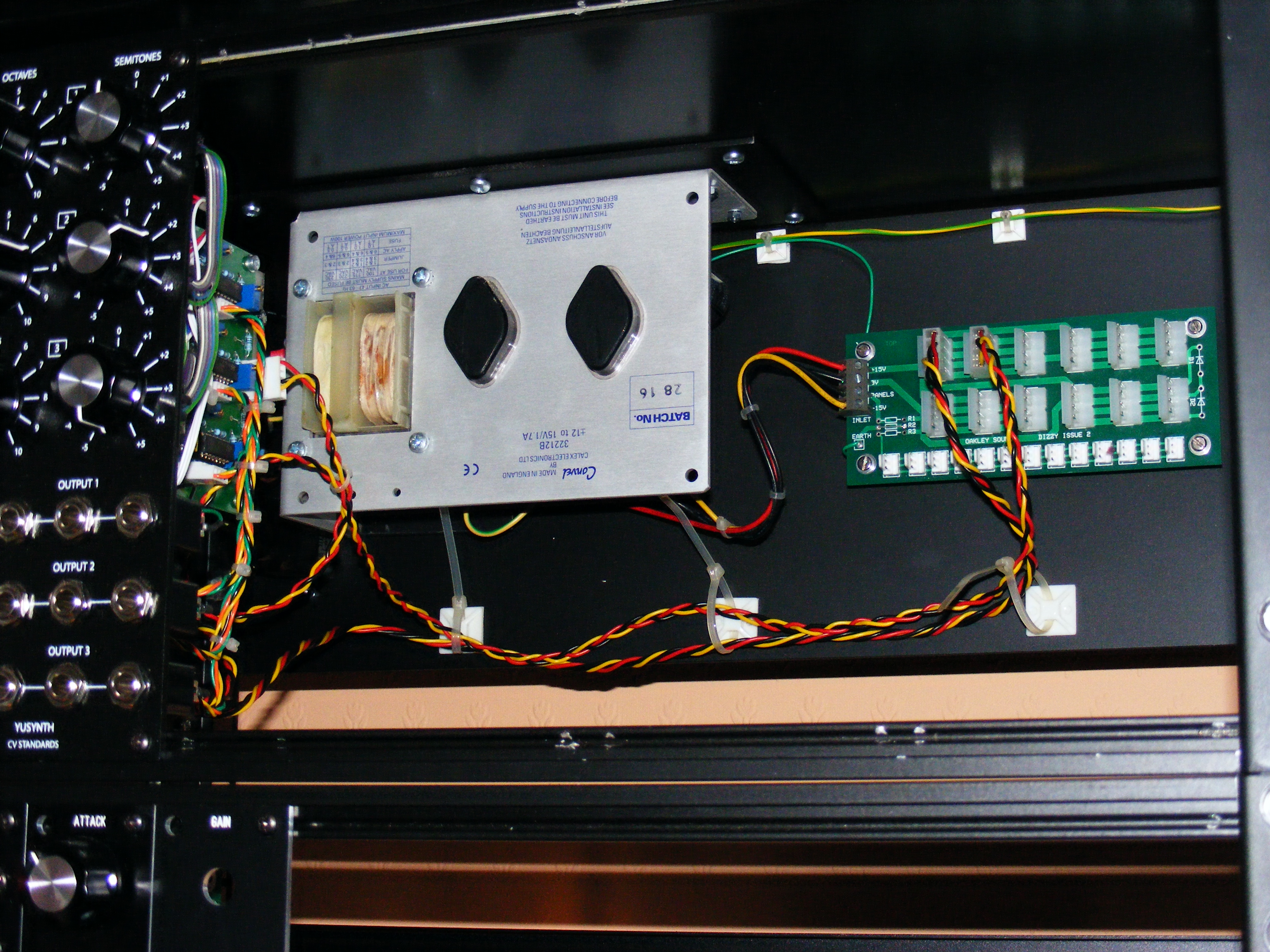

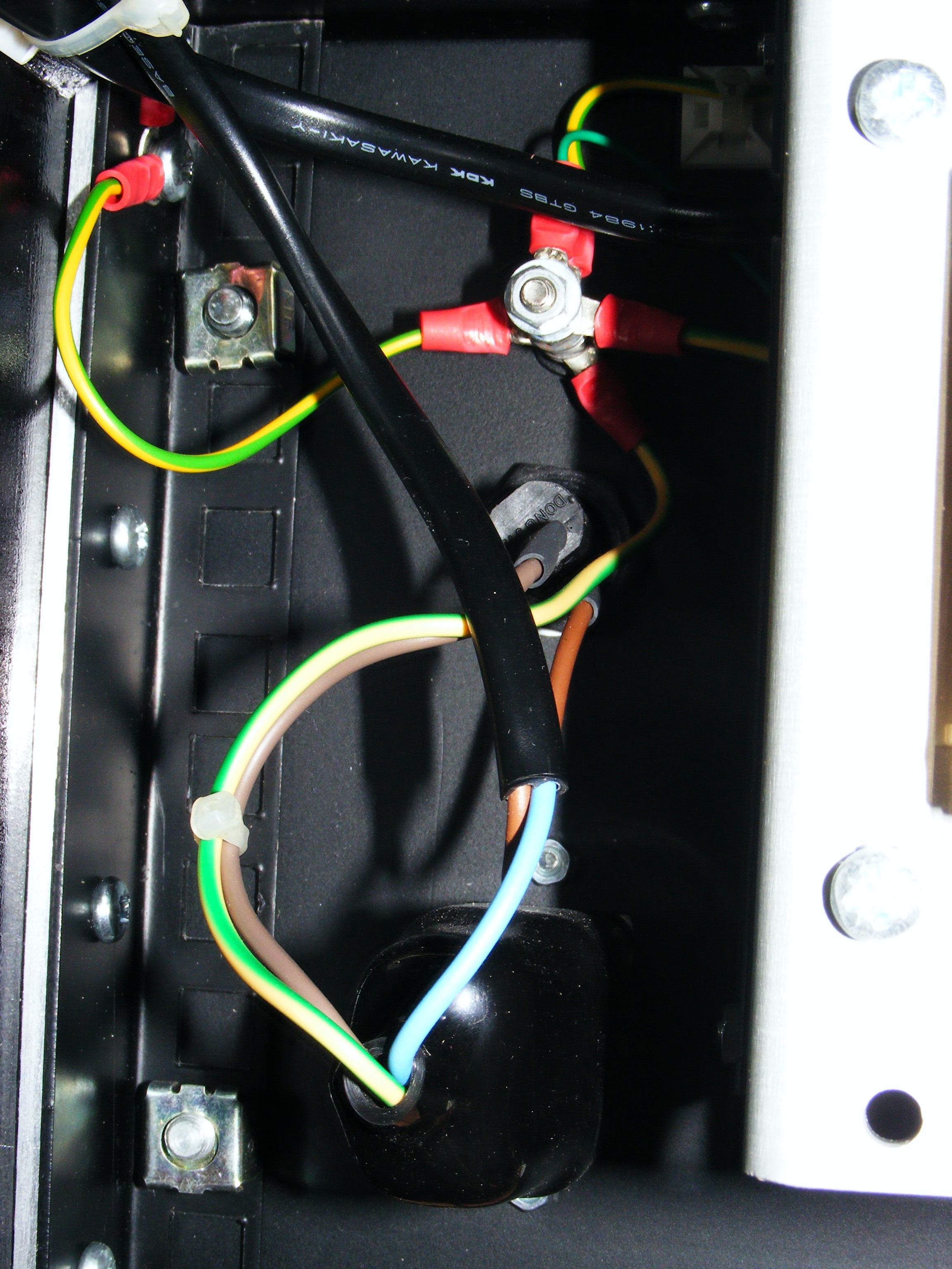

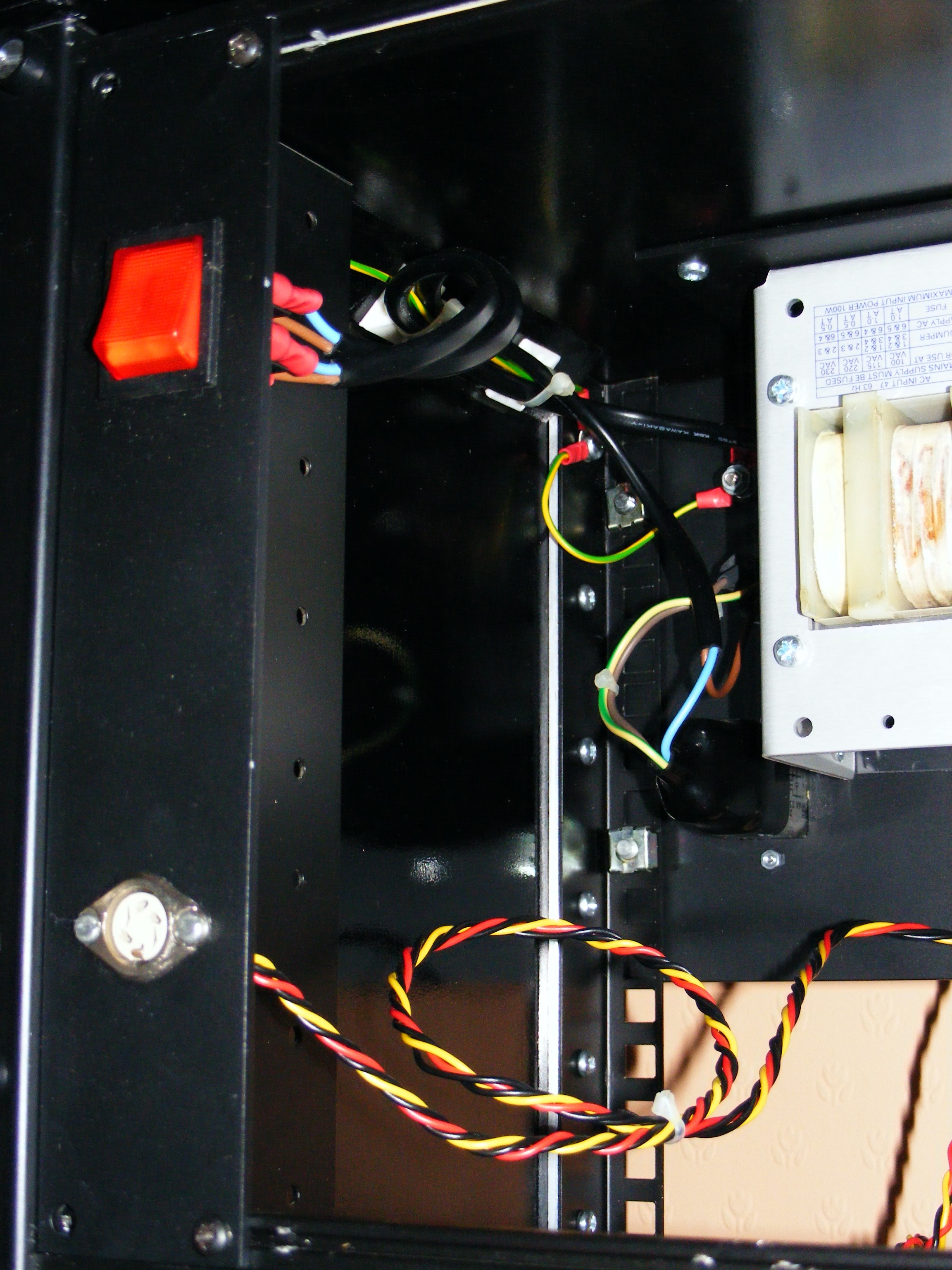

PostPosted: Wed Sep 30, 2009 9:39 am    Post subject: Reply with quote  Mark this post and the followings unread
Ali M,
This is not an easy one to answer, as I don't know your current level of electronics knowledge.
The Calex PSU is a bare chassis linear PSU, and all connections to it have to be soldered. With the one I bought, I installed an IEC mains socket, a mains fuse and a mains switch. You have to pay particular attention to having a good earth connection and all exposed connections (IEC, Socket, etc) should use insulated connections (Heat shrink or insulated crimps), you don't want to be able to touch any exposed mains connections inside your synth case (This is definately not a nice experience, BTDTGTT). All cabling should be mains rated on the mains side of the PSU (I actually stripped a mains cable to get the correct wire).
On the DC side, I used an Oakley Dizzy - distribution board.
Wiring mains power needs to be treated the way you would treat anything that can kill you.
If you don't feel competent, don't do it!!
Buy a ready made synth PSU like the MOTM 900 or 950 instead.
Hope this helps
Magman
Overall view of the PSU installation - Mains input on the left, Calex PSU, then Oakley Dizzy
Mains wiring, including power switch and a DC output DIN connector.
 Filesize:  1.18 MB
 Viewed:  410 Time(s)
This gives a bit more detail. Earth bonding at the top, fuse in the middle and IEC inlet at the bottom.
Notice the lack of any visible connections, everything is shrouded or insulated.
 Filesize:  1.17 MB
 Viewed:  382 Time(s)
Ali M
Joined: Sep 01, 2009
Posts: 96
Location: uk
PostPosted: Wed Sep 30, 2009 1:23 pm    Post subject: Reply with quote  Mark this post and the followings unread
Thanks magman,
You answered my question exactly.
Im not going to buy a MOTM PSU as they are a bit expensive for my budget.
I think I will go with the calex, as it will power a lot more modules. For less money.
Your pictures and notes help loads aswell. thanks
