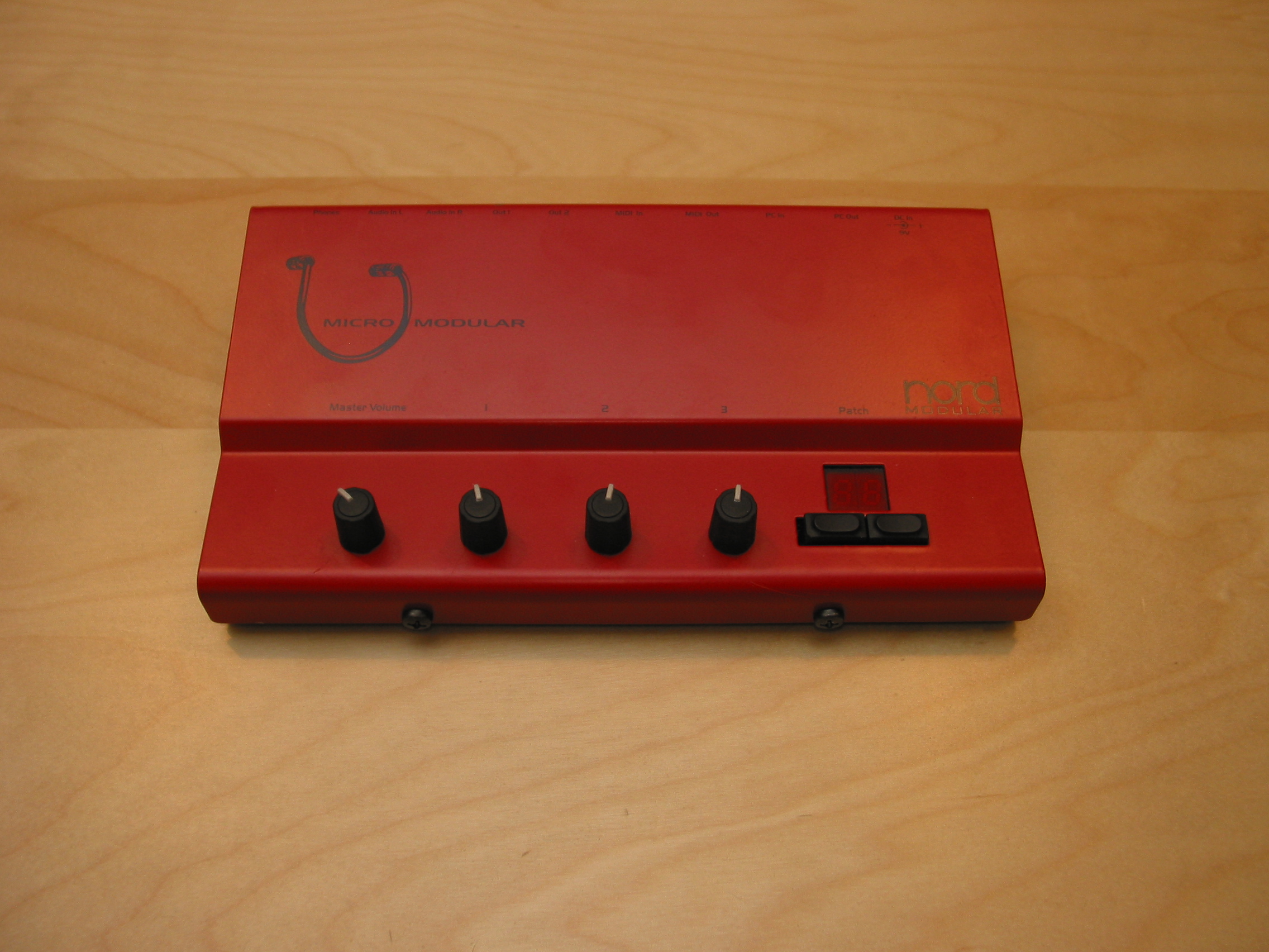

jay fuji wrote:
... i'm not giving up hope yet Very Happy
That's the spirit! Razz About spare parts... Clavia is by no means Yamaha. The building isn't that big... There was so less space, they even tried to make the synths smaller, so here a rare picture of the first Micro Modular Smile
Wout
Alpha Micro
 Filesize:  1.2 MB
