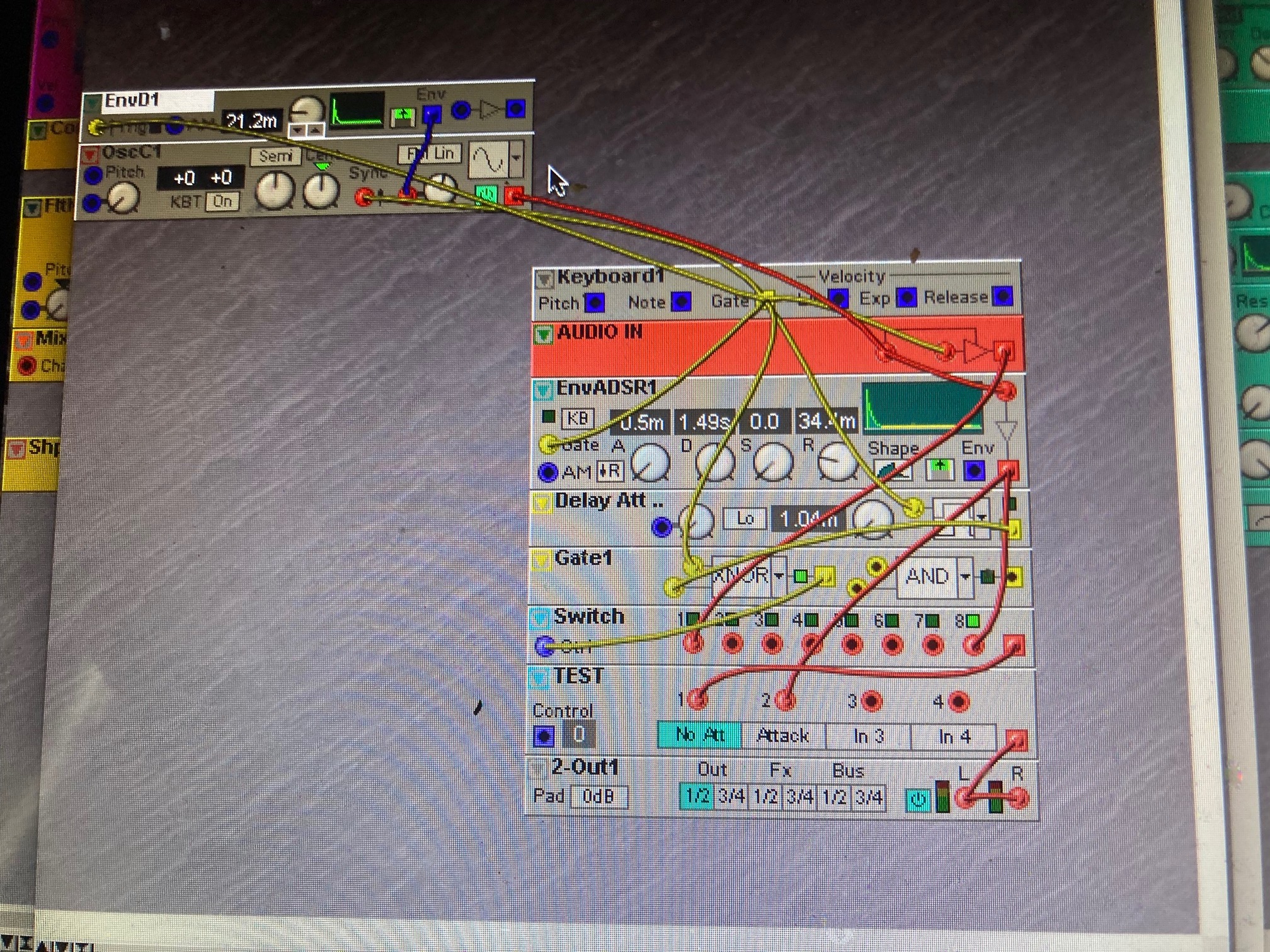

Just dug out my G2 engine from the closet and thought about this. For percussion/drum stuff I really like an ADSR envelope where you can set the Attack stage to zero but also have more control over the next stages.
The EnvD module gives you no attack time, but then you can't really control anything else but the decay, which you cant really change the shape of.
Did anyone try to build a custom ADSR envelope, that might offer this?

Okay, I tried building one with some simple logic and a switch.
It's not perfect, but it kind of works for what I like to use it for.
It plays the the sound with no attack time for 1 millisecond and
then switches to the ADSR envelope, so you can use decay,
sustain and release.
Might try another way later, but it's usable Wink
