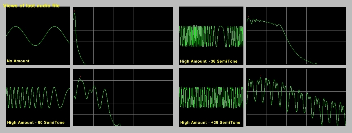

The third and last example. These were attached as *.wav, because a lot of distortion turned up using mp3.

For those interested in some visualization, here are some pics of what is going on.
Wout
Sonogram of the second example... Looks like New York at sea :)
 Filesize:  21.6 KB
 Viewed:  64694 Time(s)
Scope and Spectrum analyse of the third example at four fixed points
 Filesize:  199.13 KB
 Viewed:  1167 Time(s)
