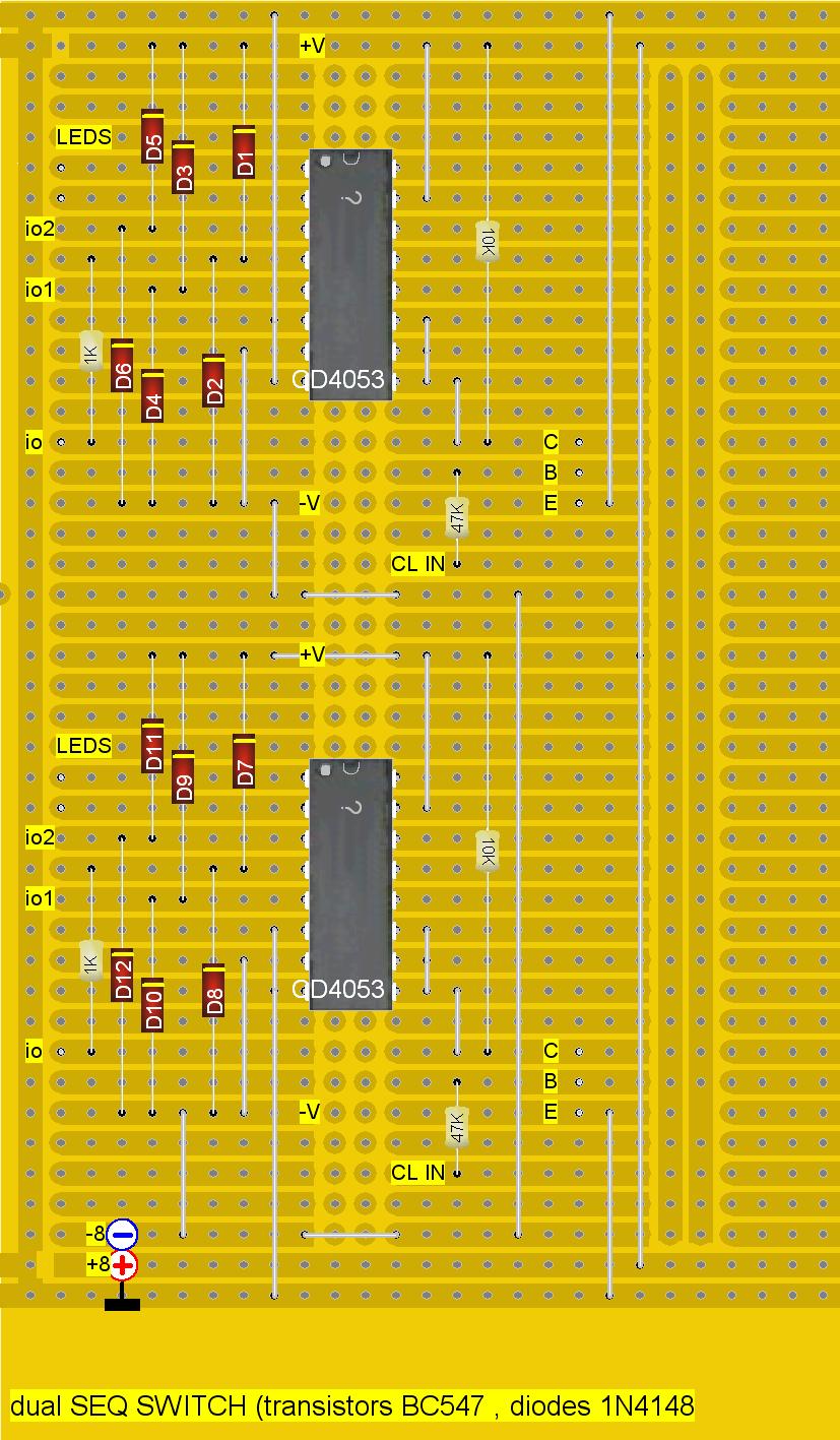

This is a seq switch from this http://www.msc175.de/module/dokumente/dual_vcs/DUAL_VCS_-8V-%2B8V.pdf schematic ,i didn't included the voltage regulators as there are already +/-8 V on my PSU , building it right now and haven't finished it yet to say it's confirmed layout . Greetings

Pretty simple design. Let us know how it goes!

it works Smile .. nice for control voltages with audio signals is not so good but that's enough for me .. switching between lfos and similar is useful ,maybe sometimes ..so it's working but anyway .. i'd check the layout again before building it i know myself and i make errors often
