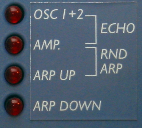

The Arpeggiator was renewed by adding the Echo function, which was coupled to the Morph to change its sound with each step. Also the Random feature was introduced. The Panel text is changed using a sticker.

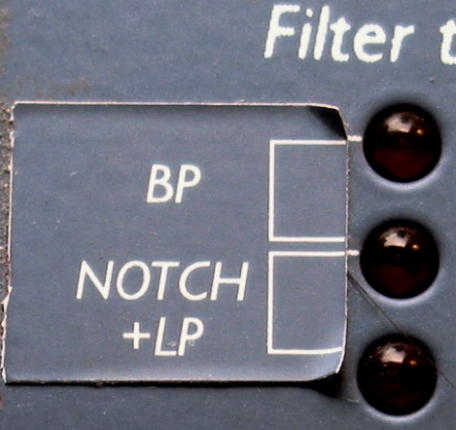

The Filter section was renewed by the introduction of the Notch+ LP Filter.
Here also a sticker changes the names and location of the Filters.

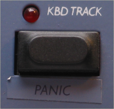

Not in the flyer text, but adapted on the Panel, was the [Shift+KBT Track]
as Panic escape. Why mention it when Nord users will never be in panic, will they?

Sticker at the Arp section
 Filesize:  148.71 KB
 Viewed:  5188 Time(s)
sticker Filter section
 Filesize:  131.01 KB
sticker Panic
 Filesize:  114.97 KB
 Viewed:  5189 Time(s)

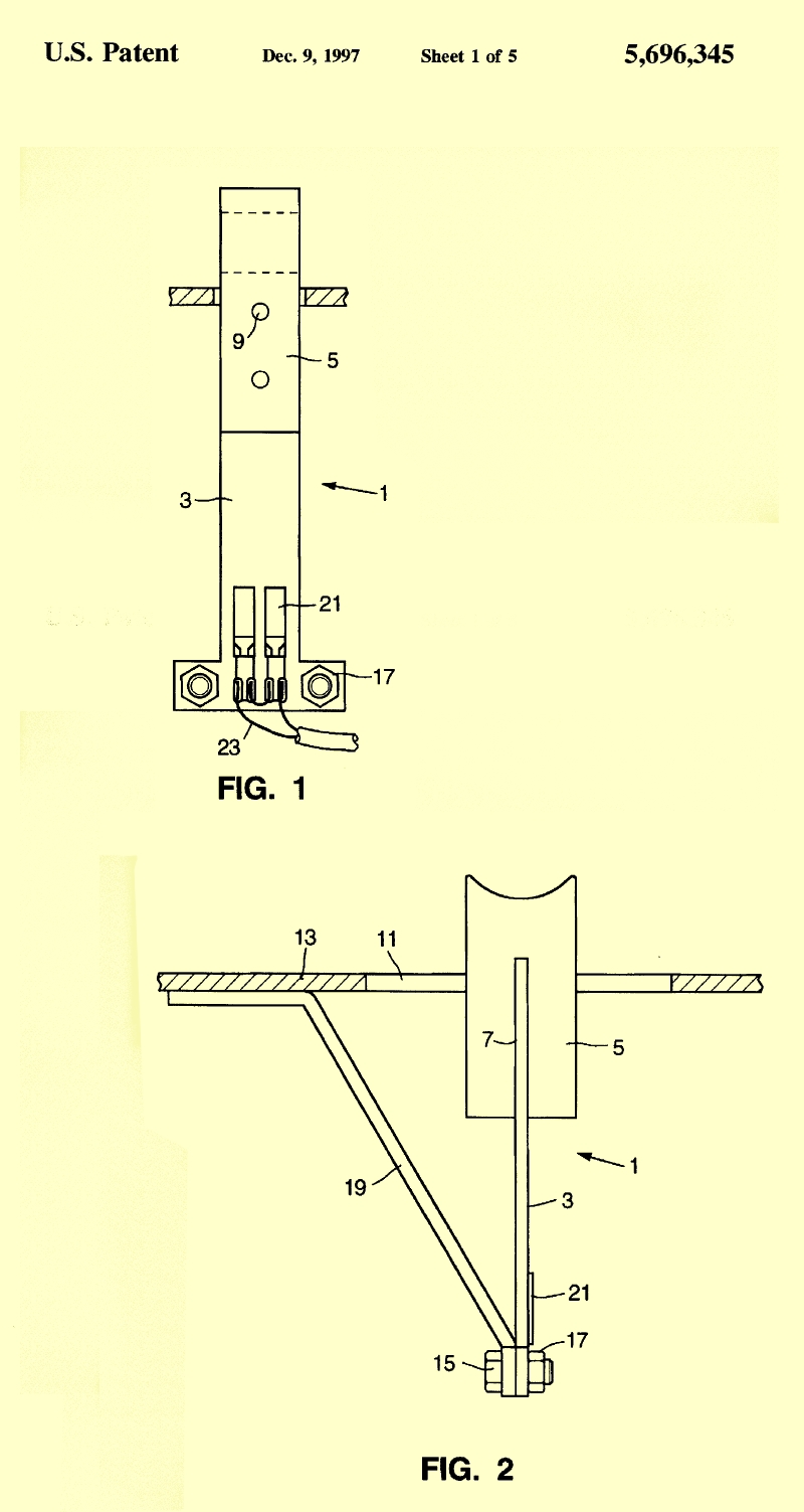

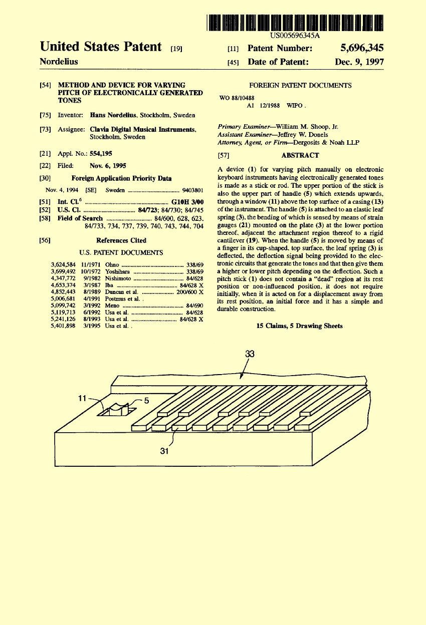

And for more history about the Nord the patent of the PitchStick.
Wout
 Filesize:  518.4 KB
 Viewed:  349 Time(s)
 Filesize:  298.5 KB
 Viewed:  343 Time(s)
