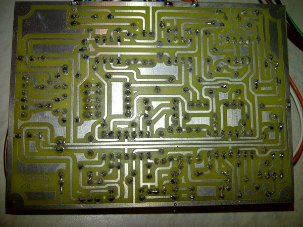

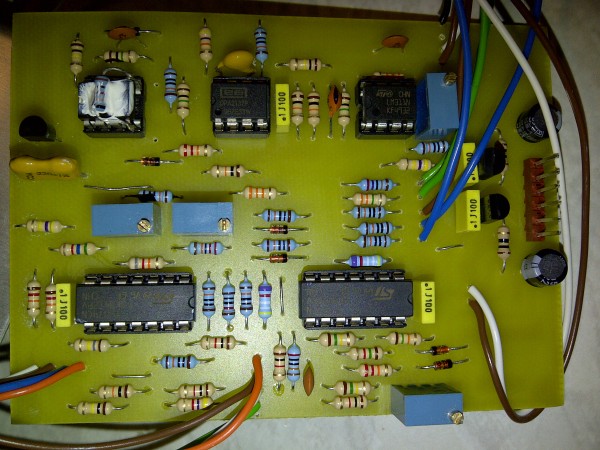

Hello everyone! I'm new to the forum and to making DIY modules and hope someone can help.
I've built a YuSynth VCO (the SSM2210 version). It mostly seems to work fine, I have good wave shapes, I've not adjusted the tracking or tuning yet as I need to buy a tuner. The frequency is a little unstable however, it does seem to vary a bit if I leave it on for a while. I'm not too worried about this for now but may be a pain later on.
The main concern I have (and may be related to the unstable frequency) is that when I plug the power in, the input voltage changes from +15V -15V to +15V -29V. The power supply unplugged gives a normal +15V -15V and is stable, it's only when I power the module I get -29V. I had the same issue in the first VCO I built, but I put this down to me using incorrect components and thought I'd blown something so started again after a few days of troubleshooting.
Here's some pics that I hope may be of help:

Waveforms:
http://www.mediafire.com/download.php?v9tirb5792hm2m8
http://www.mediafire.com/download.php?2zb9y3k9i29dfs1
http://www.mediafire.com/download.php?moca1te1f4o4zf4
Any help is much appreciated,
Thanks, Phil

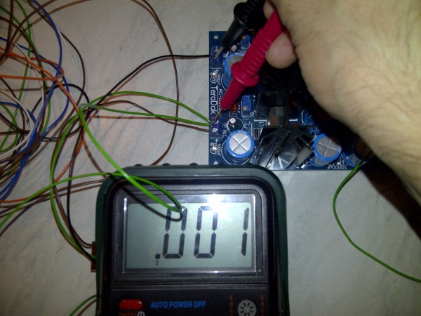

Can you post a detailed view of your power-supply and how the the various poles of the PSU are connected together ? Is the positive pole of the negative supply (back) is connected to the negative pole of the other (front).
I doubt they are internally connected, this is why you measure -29V because the common point (0V) is missing . This means that the two PSU circuit are independant that is the positive pole of the negative PSU circuit is not connected to the negative pole of the positive PSU circuit _________________ Yves |
djfill
Joined: Jan 10, 2012 Posts: 26 Location: Cardiff, Wales, UK
Posted: Sat Jan 14, 2012 12:47 pm Post subject:
Hello Yves, thanks for the reply...
I've connected the + rail of the negative supply to the - of the positive supply as seen in the pic below. I've been lead to believe this 0V rail needs to be earthed...is this correct? As seen in the other pics, I've done this by connecting this 0V rail the mains plug earth...is this correct also?
I have more information...
I realise this -29V problem only occurs when my oscilloscope is attached. So I took my VCO out of the equation. When the earth from my oscilloscope is connected to the earth of my power supply, I get the -29V!?! So i figured the 0V rail is not earthed correctly. So I left 0V rail earthed to my power supply and adjusted the pot on my power supply to get -15V....then I got smoke, bad smells coming from the - supply.
I know this problem is now outside the remit of your VCO design, so any further help is very much appreciated. Maybe I should pay now for a long term power supply solution?
Thanks, phil.

That's what I suspected the two PSU are independent you must interconnect them to define the 0V reference.
On your PSU you have one output labelled+ that you left free. You must connect it to the 0V of the modules that is connect it to the point where is attached the green wire (0V of the other PSU line). _________________ Yves |

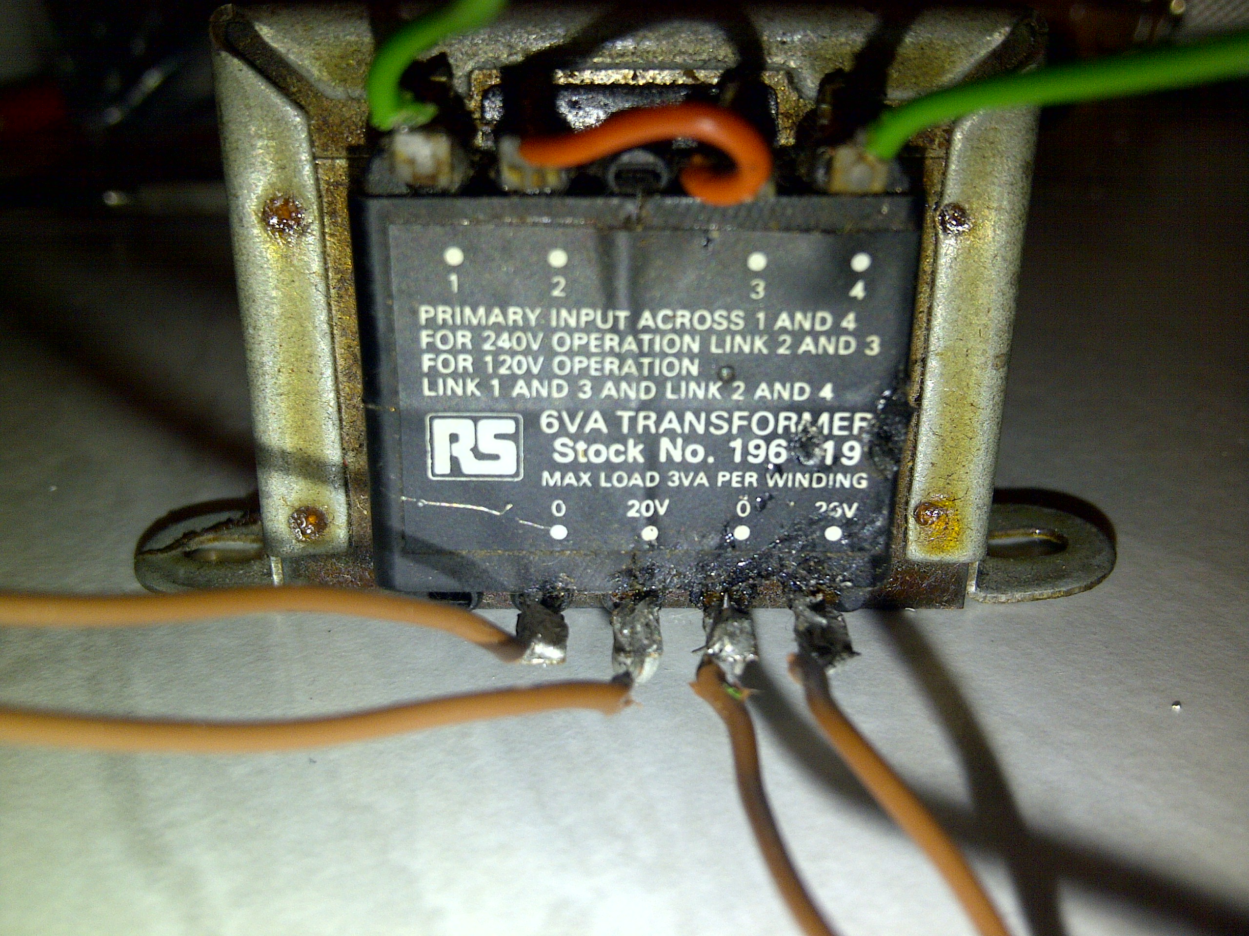

p.s. do you think this supply and transformer is suitable? Do you have any suggestions for a good power supply for around 22 modules?
Thanks. |

6VA means 6watt...
max load 3VA per winding!
if its true than this PSU really small to drive 20 modules.
you need around 50VA 2x 18V/// if you need a stable +/- 15V
i bought some toroid from this distributor>>>
http://www.tme.eu/html/EN/toroidal-transformers-with-dual-output-voltage-55xxx-p1s2-series/ramka_6812_EN_pelny.html
55122-P1S2
some calculation:
50VA > 50Watt
50VA/18v= 2.777777778Amp
2.78/2=~1.39Amp
than you have 1.38amp/rails
this toroid would be good for drive more than 20 modules.
hope this hlp! _________________ Allow theex.nl |

djfill wrote: | I've already done the internal connection. I've highlighted this now on the picture above. I'm just not sure if I've earthed this point correctly. |
You'd did it but have you checked with an ohm-meter (at power off) that they are actually connected ? You should measure 0 ohm between the two expected common poles. _________________ Yves |

Concerning the power of the transformer it is certainly too small, you need at least a 2x18V 26VA for 22 modules.
You can calculate exactly what you need for yusynth module with this spreadsheet :
Excel spreadsheet _________________ Yves |

Maybe...at least I know my board is good, so I guess I'll move on to looking for a more permanent power supply as I'm starting to build the case soon. Any suggestions Yves?

*** FAULT FOUND *** Subject description: Issue resolved |
Thanks for all your help and responses, I've found the issue with this supply.
The 0V rail on the power supply was not earthed. Not only that but the negative regulator was earthed instead. There are two rails next to each other that I thought were joined and a hole in each rail that I thought I could take my pick to put the earth wire in. No! Not the case. They were not joined and i earthed the wrong rail.
I will highlight the picture showing the underside of the supply. On the right, I've circled the incorrect place for the earth wire in red and circle where it needed to go in blue.
