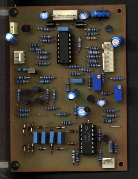

PostPosted: Thu Jan 05, 2012 7:32 am    Post subject: Reply with quote  Mark this post and the followings unread
dear yves
please take a look on the pcb, maybe i did some mistake
 Filesize:  225.97 KB

PostPosted: Fri Jan 20, 2012 5:25 am    Post subject: Reply with quote  Mark this post and the followings unread
dear yves
did you have a chance to look on the scan?
i still didn't manage it to work
i've scoped the output - it gives a sine output on any input
and increasing the frequency increases the amplitude, then it starts distorting (and becoming a very loud square, for sure)
thank you

PostPosted: Sat Jan 21, 2012 2:25 am    Post subject: Reply with quote  Mark this post and the followings unread
Sorry Roman
I have been rather busy these last days with the official announcement of the MiniBrute and I spent most of my spare time answering questions about it.
I'll your photo today...
Yves
