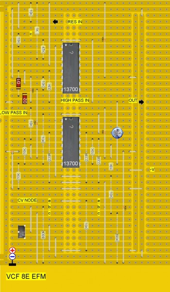

layout for the MS20 type vcf from E4M with VC Resonance , i haven't built this thing yet ,i believe the layout is correct and this vcf seems interesting ,plus the vc resonance ,the schematic is here :
http://www.modular.fonik.de/files/EFMforum/VCF8Esch_mods.gif
cheers

youve posted a load of cool things recently, thanks. Must give them a try. >Very Happy
many thanks
Merry christmas.
