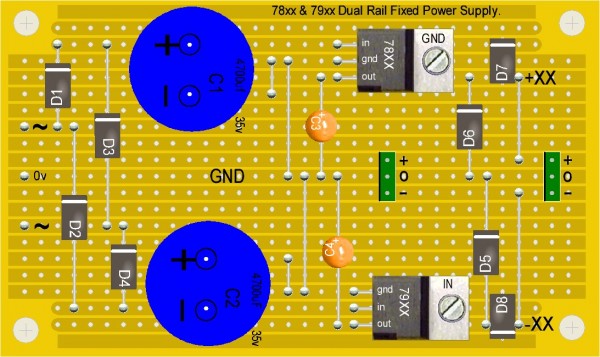

I needed a simple fixed dual rail power supply for a project, so I made this on a stripboard. I used a 'Stripboard - Small': Part Code: 'STPBRD2' which you can easily get from Futurlec.

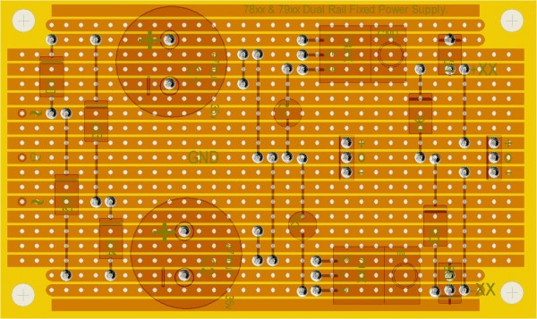

The underside of the board with heat-sinks and the regulators vertically mounted.

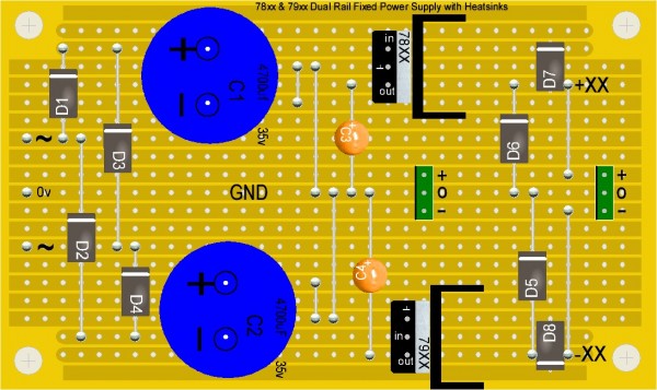

With heat-sinks and the regulators vertically mounted as the board is quite small, you can pull a larger current. I would in addition put some extra tinned wire underneath where needed. In an etched PCB the tracks would be thicker there.
If you do not want to pull a large current say < 200mA, you can just lay the regulators flat or for 100mA use 78Lxx and 79Lxx 100mA regulators, but the TO-220 versions are more robust and about the same cost (shown here).

Would it be a good idea add heat sinks to the 78xx and 79xx?

Yes if you pull a large current, say you wanted to use > 200mA on each rail, I definitely would. I mentioned that under 'Parts Overlay', where if you did do this you would probably also need to run heavier wires underneath to the diodes and out from the regulators as you approach 1A. Otherwise you don't need to for a few filters. For a few low power circuits, you could actually use 78Lxx and 79Lxx 100mA regulators, but I don't see the point in using these, when these TO-220 1A versions are about the same price, and way more robust.

Hello and thanks for this, i noticed a small error i think? D7 seems to be connected to a strip that isn't used. Or did i understood the schematics incorrectly?
/m
Posts: 5868
PostPosted: Wed Apr 17, 2013 5:14 am    Post subject: Reply with quote  Mark this post and the followings unread
you're correct, if you look at the bottom view then top of D7 needs to be soldered in one strip lower (or you could connect the two together).

PostPosted: Wed Apr 17, 2013 5:27 am    Post subject: Reply with quote  Mark this post and the followings unread
Yes, it was a sort of typo, D7 has now been fixed on the board overlays above. The circuit works fine, it was a prototype for a simple +-10v PCB board I later made for a MiniMoog VCF Clone.
