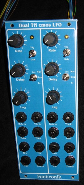

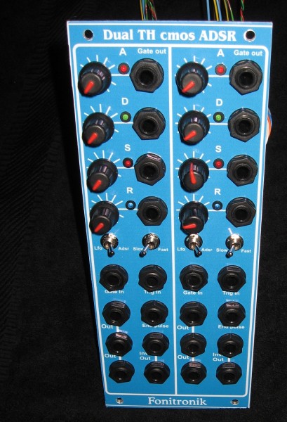

I finally got round to populating these boards I ordered from Matthias a few years ago and they are now in the modular & working Smile .
The TH cmos 555 ADSR .... - before I started populating I had a look at several interesting posts here on EM and other forums , I used TLC555 & CD4052B on both boards & the 2 x 47K to pin 6 - resistor mod .
The TH cmos 555 LFO .... - For this modules Controller wave select switch, I got my on-on-on toggle switches from a guitar shop they are popular for selecting neck/ middle / bridge pickups.
When I got the switches home, I used a multimeter to find the switch middle position up/down contact layout and mine were a mirror image of the connect diagrams in the forum threads.
Here is a couple of pics of the modules.
 Filesize:  368.23 KB
 Viewed:  535 Time(s)
 Filesize:  284.97 KB
 Viewed:  519 Time(s)

I built these using the bright red pcb's , Matthias sold a few years ago.
The 47K mod , on Mw site , I followed the cmos555 ADSR thread by Matthias and near the end pages there is a discussion about the lfo function , on my unit when I first built & tested it had the same problem when turning the attack or decay back to CCW and it froze the lfo , by bending pin 6 of the opamp up from my socket and soldering a 47K to ground and another to +V it made that section into a comparator and allowed the lfo to not freeze Smile.
