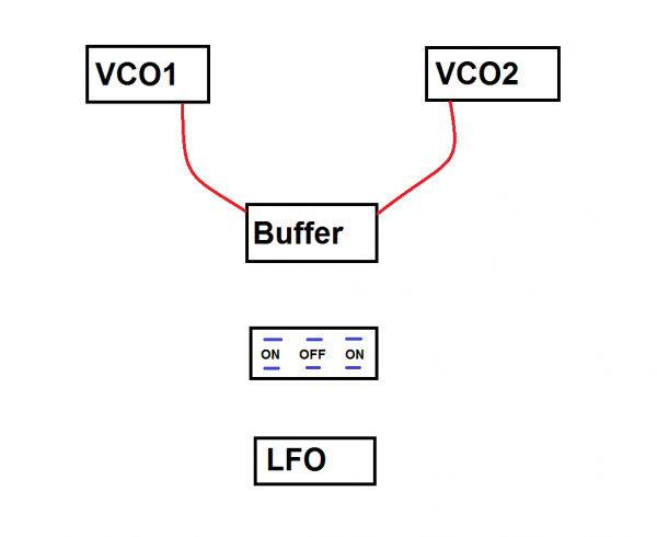

Hi guys.
need help with in wiring Embarassed
building a new synth and i want the ability to send one LFO to the 2 vco's separately and together, meaning...
using on-off-on toggle switch:
left side "ON" will be VCO 1
right side "ON" will be VCO 2
center "OFF" will be VCO 1 and 2.
is it possible to do?
i was stayed up late trying to drew this but didnt got to any solutions.
if you guys have any idea of how to do it i'll be happy to hear, as long as its with 3way toggle switch.
attached is the basic idea.
the buffer is for the 2 vco's from one LFO.
cheers.

As you can't route a signal thru an "off" position directly you need additional logic like electronic switches driven by the "on" positions and an inverter in the "off" case.
Easier way would be to use a three position rotary switch Razz

I though it would be the answer.
I don't have space for additional rotary switch.

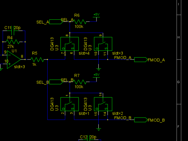

This is my circuit to do exactly what you're talking about, not fully tested yet though.
Replace R5 and the circuit to the left of it with your LFO output.
SEL_A and SEL_B are connected to each end lug of the switch, center lug is connected to ground.
When the panel switch is open, R6 and R7 pull up the control inputs to turn on the LFO to the VCO's. When the switch is closed one way or the other, that control input is grounded turning off the LFO to the corresponding VCO.

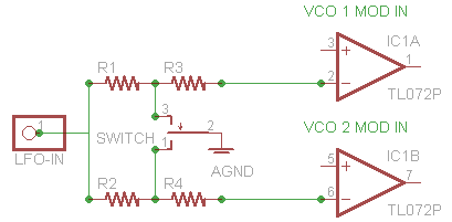

Connect the LFO to both VCOs throught a resistor, then use a common on-off-on switch, extreme pins conected to VCO mod inputs after de resistor, and middle pin connected to ground. So when the switch is in the middle both VCOs have the LFO modulation, when you move the switch to one side, the input goes to ground and that VCO will have no modulation.

Hi Sebo.
You got me confused.. Confused
Any pic to follow your description?

Something like this:

Thanks for the scheme Sebo!
As I understand it's not an DPDT switch?
What would be the appropriate values of R1,2,3,4? 1k for each one will be ok?
Last question...
I see what you mean by center position will be both vco's.
But if I'm not mistaken when the switch position will be up for example one path will be passing smoothly, the second path will short with ground but part of it wouldn't go to the vco? I'm asking cause eventually I see it's connected to the vco through a resistor but still connected.

The switch is a common on-off-on switch.
The values for R1, R2, R3 & R4 depends on the value of the input resistor of the VCO CV summing network. Usually this resistor is 100K. You have to remove the original resitor and use R3/R4 instead. In that case a good value will be 51K for all resistors. If you don't want to remove the resistor on the VCO, ommit R3 & R4 and try a small value for R1 & R2, something like 10K will work (I think), but the modulation deep will be a little less than normal...

Ok, now after sleeping all make sence to me.
Yes, I'll remove the 100k from the vco's.
The only thing I'm nor sure about is how/where to connect the 100k amount pot.
I think I'll put it from the LFO out before going to the switch.
like the attached pic, what do you think?

That's right.
