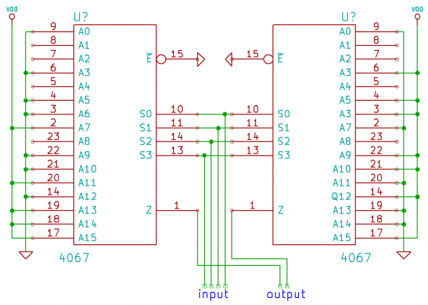

I want something that can take in some number of logic highs and output how many there are as a binary number.
Lets say I have 4 separate 1-bit inputs. I want to convert this two a two-bit binary output. If all four inputs are high, then I want to put out 11, if three are high then output 10, if two are high 01, if none are high 00.
Here's where I am getting really stuck though: it needs to be able to do it no matter which inputs are high or low. ANY two inputs have to make it put out 01. ANY 1 input results in 01 out.

You could do it straight forward and calculate the terms for the two binary output digits you want. This will likely result in a rather complex circuit with lots of gates.
However, instead of using logic gates you could try to break the two boolean functions down into terms with only two inputs and use 4052 chips to implement it FPGA style. The analog mux inputs could be hard-wired to Vdd/Vss to implement the truth table and the two inputs select the output from it.
Another approach is to do it the analog way. Add the input bits with a resistor network and evaluate the resulting output voltage using comparators.
From your description it is not clear to me what exactly the output should be. There are 0 to 4 HIGHs possible, but with two binary digits you can only represent the numbers 0 to 3. If you can describe what you intend to do with that function, there may be more ideas.
Yes! Can't believe I didn't think of this! I could just use a summing amp and a few window comparators!
I'm trying to make a sequencer that "adds" together square waves that will make up the rhythym. I have a sequencer that is just a mux so I wanted an output compatible with that.
that would give:
DCBA - XY
0000 - 00
0001
0010
0011 - 01
0100
0101 - 01
0110 - 01
0111 - 10
1000
1001 - 01
1010 - 01
1011 - 10
1100 - 01
1101 - 10
1110 - 10
1111 - 11
what should the output be if only 1 input is high ?

If you don't mind using chips in the TSSOP24 package, you could just use two 4067 ICs like this. (Showing only the wiring for the truth table that PHOBoS built so far)
 Filesize:  36.09 KB
 Viewed:  359 Time(s)
I was silly and thought "2 bits = 4 values, thus: 2 bits = 1-4" when two bits would only handle three inputs.

I have never looked into the 4067 before, but I'm going to have to pick up a few now!

Use an lm3914 for your comparators. Then you can have 2 modes of opteration by switching between the line and dot display modes.
Good call! I have a bunch of spares kicking around!
