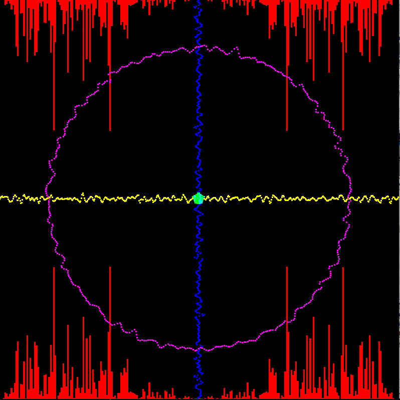

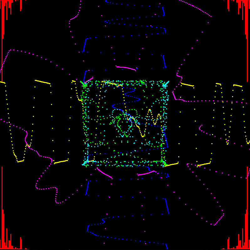

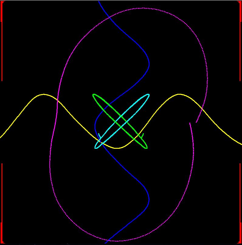

A team of my students is currently designing and extending a very basic waveform visualizer that I drafted in the Processing language. I have been using my NYE recording as a test driver. Attached are 3 screen shots, and I'll attach 3 more in a follow-up post below. The yellow and blue are time domain plots of the recording, and the green and cyan are Lissajous. Either I had no stereo difference or the input software is screwing me on left-right separation, so I phase shifted the right channel by 10 samples to get the Lissajous patterns.
The magenta trace is just time domain plotted around a circle 3/4ths of the way out from the center. We are designing this for use in the planetarium. Finally, the red bars in the corners are mirror images of the frequency domain plot.
I'll talk a bit more about the planetarium in the post below. In terms of zero-input mixer, I found watching these waveforms very useful in helping get into playing the instrument. For NYE I didn't have time to look at them, but I find them mesmerizing now. These still shots don't do justice to the transitions, any more than a 1-second recording would to music. Another of my student teams is planning two 3-minute promotional videos for the planetarium-as-instrument. One will use a game-for-play-in-planetarium that we are developing, and the other will use the final version of this visualization software driven by zero-input mixer.
a simple waveform
 Filesize:  227.62 KB
 Viewed:  934 Time(s)
more interesting
 Filesize:  295.18 KB
 Viewed:  890 Time(s)
the piece devlopes
 Filesize:  351.11 KB
 Viewed:  850 Time(s)
