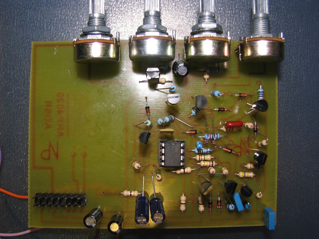

ADSR board built and working... sort of Rolling Eyes But it is useable.
The only problem is that there's some kind of voltage overshoot. With all pots at minimum, I'm getting an offset voltage from the decay control - it's not noticeable when you use the ADSR to modulate either the VCF or VCA, but definitely shows up when you modulate a VCO... Hmmm, strange - I need to look into it further.
Maybe it's the fact that ARP delay their keyboard trigger pulses, or my gate to trigger converter isn't as good as I thought or a bad transistor substitution or maybe the Moon is in the wrong phase Wink

Thats a fun looking build! Should be room for 2 EG's on the same board there perhaps?
About the voltage overshot, i cant say much, but the 2600 do have something going on regarding this. Its definitely noticeable on all the drum patches ive heard/made on it. Makes it very special, and also one of the big reasons i dearly want it!
Good work Andy! Smile

Regarding the length of the complete ADSR cycle of an unmodified 2600, and the unwanted behaviour you're talking about, the section about the 'Contour generators & vca', in this article, may be of some interest (it's an exhaustive comparison between the original synth and its virtual counterpart):
http://www.soundonsound.com/sos/jun05/articles/arturia2600.htm
Hope it helps !

So as far as I can tell, the ADSR I've built seems ok although I'm going to tinker with it for a while to see if I can improve anything... or maybe just leave well alone as it has a certain character Smile
