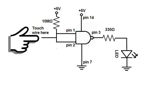

My mind went to having 8 switches, which could be coded to binary using a priority encoder making a sort of primitive keyboard, that would play the 8 pitches determined on the sequencer panel. Of course I could just solder up some momentary switches, those big arcade style buttons say but I've always been into the Buchla touch keyboard. I thought I may be able to do a lunetta version of that. I like the idea of single touch pads, rather than gaps bridged by the finger so I found this circuit (attached image): http://www.learningaboutelectronics.com/Articles/Touch-sensor-circuit-with-NAND-gate.php
Which claims to generate a touch sensitive switch from a 4011 NAND gate.
It works when you wire it up and sure the LED lights up on touch but on probing what's actually going on at the output it's actually a fast moving square wave (obvious when you patch it to a gate in or clock in). So what's going on here? The explanation on the page...
When we touch the touch wire, we are essentially acting as a resistor, creating a voltage divider circuit. Our body resistance can range anywhere from 100KΩ when dry to anywhere to about 1KΩ when wet. Either way, our body's resistance is much lower than the 10MΩ resistor. So it only a small amount of the 5V falls across our body. Doing the math, the voltage that falls across our body would be V= (5V)(100KΩ)/(100KΩ +10MΩ)≈ 0.05V, which is essentially 0 volts. The NAND gate reads this as a logic 0. (0.05V is way under half of the power supply voltage, which is 5V). So the logic level now at the inputs of the NAND gate changes to LOW (or 0). According to NAND gate logic, 2 LOWs at the input produce a HIGH logic level at the output, so the LED now powers on.
...doesn't seem right to me. Is it that you're finger touching the gate input is just creating interference? Just static confusing the input? I tried essentially the same circuit with a 40106 and got a similar result.
Anyway, I'm been wondering if this could be exploited - rectifying the square wave to a consistent high signal? Is that possible? Or connecting it to a re-triggerable monostable to get a high signal until the finger is released - I simulated this in falstad and it worked but I haven't got a monostable chip (e.g. 4098) to try it for real.
Or is all that just pointless - I should just mix in a proper capacitive touch circuit with an arduino. I've been looking at the adafruit breakout which gives 12 switches on one board, or there's heaps of pre-made ones on ebay for pennies. I know that isn't strictly lunetta so I won't ask anything more about that circuit here.

I'd expect the frequency of the signal to be at 50Hz (or maybe 100Hz), which is the net frequency in the UK.
It's also what you hear if you touch the end of a cable that's plugged into an audio input.
You can filter it and use flip flops to turn it into a useful signal and there are probably some example of that online.

Many thanks PHOBoS - dependable as ever. I didn't think the explanation given was right - so you're picking up an alternating EMF from the power lines and the CMOS input picks it up and turns it into a square wave? Interesting.

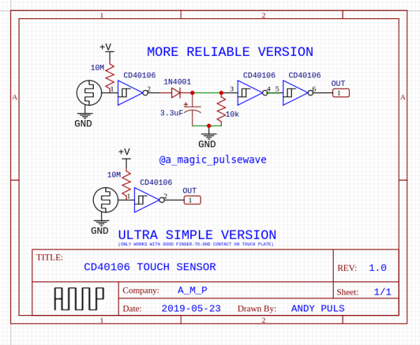

Here are some CMOS touch switches I've come up with and used quite a bit.
The 40106 ones just output a high logic when the touch plate is touched. To work, your touch plate needs to have two conductors, one to cmos input and the other to gnd, which are bridged by your finger. The simple version actually works very reliably as long as you have a pretty narrow gap between the two conductors.
The more reliable version actually works pretty decent even without good GND contact because it will take the 60HZ buzz you are inducing and then filter out the low side of the wave for a continuous positive output while touching.

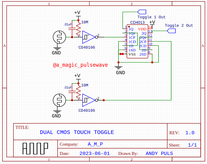

The toggle one uses a similar 40106 touch sensor as an input but uses a 4013 to output an alternating signal for each time it is touched. The .01uF capacitor on the input helps cut noise/debounce for a more reliable toggling experience.
EDIT: also reading your plans for your synth/sequencer more closely, you might want to check out the Touch Tones and Melody Oracle (and Star Song which I just posted about). All of them use a 4051 pot switching scheme, and expand it into octave divisions using a 4040.

Ah thanks - I'll check those out too. Interesting to see how to the 60hz pulse wave can be rectified with the 4013 flip flop.

all circuits shown here are missing ESD protection ! Do yourself a favour and add a >=100k series resistor between CMOS input and touch input components. A 4000CMOS is "ancient technology" and you can easily destroy a chip by e.g. walking with rubber/plastic sole shoes and then touching an unprotected input. Often chip failure happens 1..2 years after the ESD event. Many companies learnt this the hard way, although information was already available in the early 70s data books.
