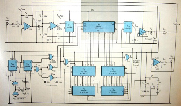

yeah.......youll find some old school RAM chips and other general logic usefull for making your own digital delay
digital delay
