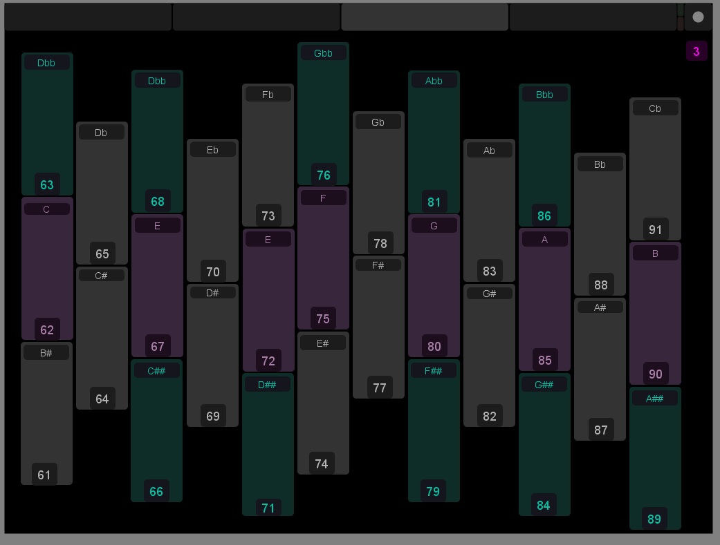

It's amazing where the circle of 5ths turns up... (yes this is going to get into some heavy-ish music theory!)
The layout I used on my microtonal keyboard (31 notes per octave which I'll be using as an equal temperament) is arranged so when you move a given distance in a particular direction, you will always get the same change in pitch (it's isomorphic).
vertical = 1 step
right&up diagonal = 3 steps (diatonic semitone)
left&up diagonal = 2 steps (chromatic semitone)
along a row (e.g. from one white key to the next) = 5 steps (whole tone)
A lot of the other microtonal keyboards I've been influenced by have this feature too. But I've noticed something special about these designs that have the staggered rows of keys. (I don't know who was the first to spot this, but here we go anyway!)
The 1st diagram out of the four shows an octave of the keyboard with all 31 notes being used. The label (1,31) on the key means for example that C is the first of the 31 notes in the octave. The D key is physically exactly half way between the top and the bottom of the keyboard. I've written out a circle of 5ths to the left of the octave with D in the middle.
So to the point of this post:
It turns out that with these keyboards, the vertical position of each key corresponds with its position in the circle of 5ths. D is exactly on the centre-line, G is slightly higher, then C, and so on. The notes that would sound more exotic or dissonant if played against a nice safe white-key mode like A minor, are the ones further towards the top and bottom of the keyboard.
Onto this keyboard you can map scales with fewer notes per octave (see the mappings below of 29, 19 & 17 notes, which are some of the best numbers for tonal/diatonic music). While writing this I'm genuinely surprised to find that the 19 mapping seems to be isomorphic - I didn't expect any of them to be.
Anyway, the fact that the key positions fit the circle of 5ths has a useful consequence. To find a mapping for an odd number of notes simply leave out keys, starting with the very highest (Gbb) and lowest (A##), and working your way in towards the middle until you only have left the number of keys that you need. To get an even number of notes you have to assign Ab and G# to the same pitch, which is useable if not perfect.
Having D in the middle (and Ab and G# ennharmonic in an even-number scale) goes with the fact that the octave is a symmetrical sequence (palindrome) around D - in terms of both the colour and the vertical position of each key. And I'm fairly sure this is true for any scale you map to this keyboard by the rules above.

I went ahead and rendered the 31 division as a TouchOSC template. Hopefully Gordon will return long enough to give his assent and receive proper credit.
