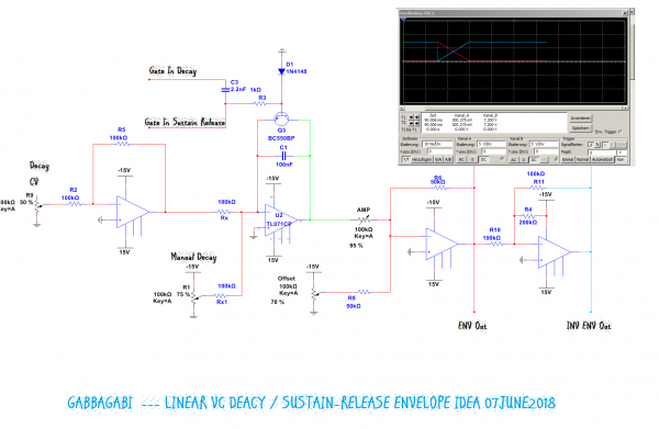

Hi All,
I'm looking for a nice voltage controlled decay/release schematic for a percussive synth that i've been thinking lately.
No need for attack, since it's for a drum synth.
Anyone knows of a good schematics for this?

Find attached an idea for a linear Decay or Sustain Release VC Envelope.
ate logo, gabbagabi

PostPosted: Thu Jun 07, 2018 10:55 am    Post subject: Reply with quote  Mark this post and the followings unread
oh a nice one, and once you have a linear one with time control .. feedback from the output to the time control inputs will give you an exp curve, and hey .. you have an inverted out too .. for log curves :-)

PostPosted: Thu Jun 07, 2018 11:10 am    Post subject: Reply with quote  Mark this post and the followings unread
what?
i didnt know that at all!
thats crazy, is there a name for that kind of feedbag(ck)?
in the simu it works a little bit, but i get not that what iam used to from cap discharging curves, but it worth investigating.
what a perfect surprising evening!

Posts: 24499
PostPosted: Thu Jun 07, 2018 11:19 am    Post subject: Reply with quote  Mark this post and the followings unread
I have no name for it - invent one :)
You may have to fiddle a bit with DC levels maybe?

PostPosted: Fri Jun 08, 2018 7:52 am    Post subject: Reply with quote  Mark this post and the followings unread
here is an idea for a AD / ASR
incl. the 2TIMES-LIN-IS-EXPO-mod, which works - the release rollout is not exacly like from a cap discharge - but its only a simulation
i included a fastness pot cos i guess it could be usefull if not nessesary to get fast attacks
so far,
gabbagabi
