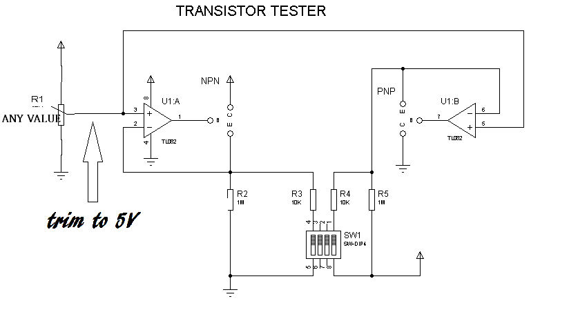

Im trying to match trannies following the attached Ian Fritzs circuit, but I get nonsense readings. Like 1.4V and going up throught until 1.6V. The readings keep rising over the minuts and never stops.
I understand it should be reading around 0.6/0.7V correct?
Now Im planning to breadboard this:
But I dont have the zener. Could it work without it?. What´s the zener function here?. I can use a regulated power supply to put exactly some random voltage to the circuit, so if it needs 5.1V I can supply exactly this.
Where should I put the probes in the opamps circuit?
Im a bit lost. Thanks!

You really need the zener diode as it makes the reference voltage needed for the measurement. And also do use a 5v1 one, as around that zener voltage the zener's temperature dependency is as small as possible.

as the zener is working to produce a stable and supply-voltage-independent voltage-reference @5V, and it is only connectet to the positive inputs of the opamps - u could just use a trimmer to produce that 5V

That´s a sweet idea. I have a bunch of zeners coming, but maybe Im breadboarding this so I can finish some building
I will try with a 50k pot
Thanks g.gabba!

Ok, while breadboarding I have realised that this tester is for single +- supply.
I have modified it for + ground - supply, so the zener is not needed.
I have also added where the probes goes for newbies clarification. Now it reads perfectly.

That is a good solution too - great you got it working :-)
