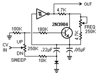

The circuit I suggested and posted here http://electro-music.com/forum/post-203237.html#203237 gave me some trouble. Not only was upward sweep much greater than downward, but no matter how I tinkered with the values, with the Sweep potentiometer centered (zero sweep, equal amounts of "up" and "down",) I couldn't get the frequency to stay the same with maximum CV and zero CV.
To deal with down sweep depth being not as great as up, I thought instead of having the bottom transistor affect a single capacitor, why not have it add a varying amount of a second cap? It turned out that the second, "down" cap had to be about 4 times the "up" cap. This sort of worked, but "down" still didn't go as low as I wanted. I eliminated the lower transistor and instead used a diode. Surprisingly, this worked much better than the transistor. How it works is, as the voltage rises and the diode conducts more heavily, its "dynamic impedance" decreases, connecting "more" capacitance to ground. (Or something like that. Think of it as similar to the variable resistor of a cheesey 1960s phonograph's "Tone" control.)
All that remained was to get the centered position of SWEEP to give the same frequency with or without a CV applied. A resistor to ground at the "up" end of the pot, forming a voltage divider, took care of that. (A trimpot here to get zero sweep precisely in the center of the pot's rotation might be a good idea.) Values shown are for a 9V supply. It's highly probable that values will need adjusting for a lower or higher supply voltage.
If the modulating signal is an LFO's triangle or square wave, there isn't much difference between up sweep and down. But if the modulation is a ramp (sawtooth) or, better yet, an envelope, then adding the extra few components becomes worthwhile.

Thanks, loss. I wasn't too interested in expo-control for my purposes, but that circuit certainly looks simple enough to try. But it's bipolar. Can it be made single-supply?
As for having up/down sweep, I wanted to keep an already simple circuit simple, and not resort to an op amp attenuverter, which I didn't know how to do in single-supply anyway -- until recently.
Yes 'monger, I knew there's a triangle at the gate input, but I thought it had to be buffered by a high-impedance op amp. I assumed a garden-variety transistor wouldn't be good enough. I'll have to try that, too.

A little modification I need to test but I think it should work
looking at it now tho, the CV in bit looks a bit weird
Just read this one, now.
The CV input, has 2 separate inputs. 1 is from external to the VCO. The other, is a voltage divider between + voltage and Ground. It's the VCO's 'Frequency' / 'Pitch' control. Smile

The resistors' values were painstakenly selected so that with the Sweep pot centered a CV will not send the freq up nor down. Move the voltage divider pot out to the 100k and the changes might work.
