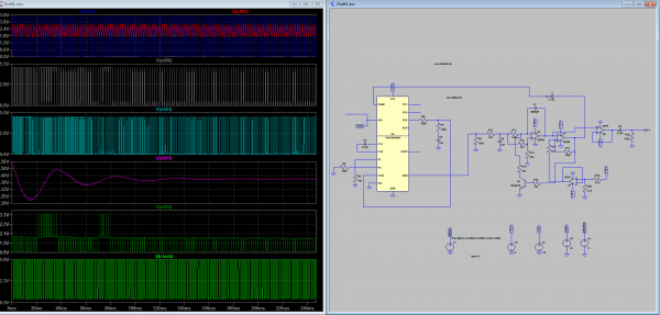

krainov
Joined: Feb 26, 2015
Posts: 20
Location: Nowhereland
PostPosted: Thu Nov 07, 2019 5:18 am    Post subject: Reply with quote  Mark this post and the followings unread
Yeap! Works as expected...
LtSpice sim screenshot
 Filesize:  102.06 KB
 Viewed:  333 Time(s)
CD4046 VCO.zip
 Filename:  CD4046 VCO.zip
 Filesize:  17.21 KB
 Downloaded:  197 Time(s)

PostPosted: Sun Nov 10, 2019 9:34 am    Post subject: Reply with quote  Mark this post and the followings unread
Cool! Glad to see that someone is doing something with this. I intended to, but never got around to it.
What is in the zip file?
JacobWatters.com
krainov
Posts: 20
PostPosted: Sun Nov 10, 2019 9:37 am    Post subject: Reply with quote  Mark this post and the followings unread
LtSpice simulation
