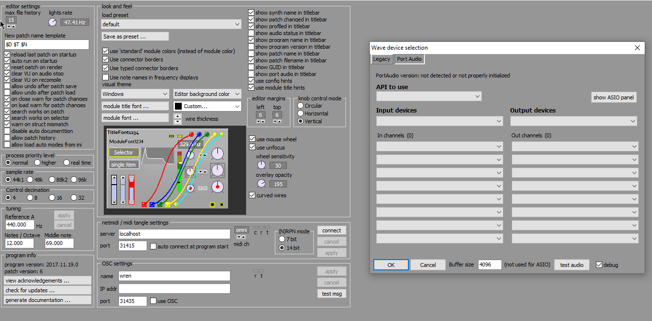

Although unfortunately I am unable to get it working. I read your stuttering explanation under FAQ and I just can't figure it out.
I am using Windows 10 64, and my hardware consists of a Motu PCI 424 card that is connected to a 1999 audio interface Motu 2408 mk2. Sample rate running at 48k, usually buffer is set to 512, and the driver I have selected in my DAWs is 'Motu PCI Asio'.
I also attached a photo of what options are available for me in Wren. What could I be overlooking?

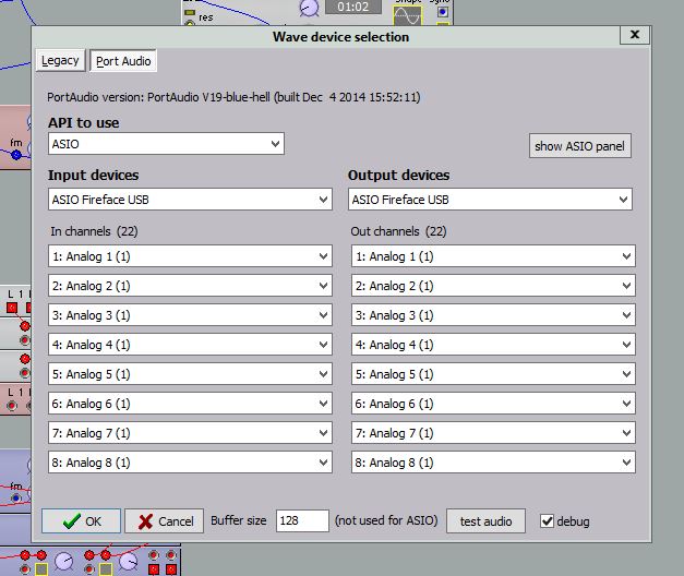

I see that in the device selector you are only getting the legacy devices and not the port audio ones.
Assuming that you downloaded the wren zip file and have the port audio DLL in the same folder as the wren executable ... it then seems to be the case that the port audio DLL gives errors on startup.
Wren makes a logfile, there may be clues in it, maybe you can post it here? This would be "wren.log" and it is located in the wren folder.
What I've heard about is that on Win10 the port audio DLL is not working well with some of the on board audio devices. I've never had this issue myself though so not quite sure how to fix this ... well probably I'd have to supply a new DLL .. but maybe (just some stuff I would try myself, but never heard about anyone actually trying) it would be possible to:
a) disable the onboard sound devices in the device manager.
or b) Use a port audio DLL obtained from somewhere else
EDIT: things could still work with the legacy devices, but you would need a far greater buffer size than 512 then.
The device selector when using ASIO should look something like :

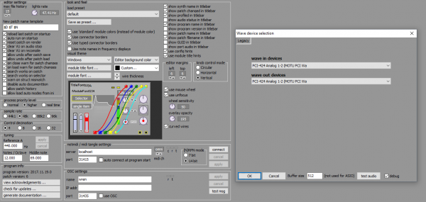

Actually the Port Audio tab did exist up until I uninstalled FL Studio ASIO, I did not uninstall FL Studio itself.
I also have a laptop with Windows 10 and a M-Audio 410 Firewire interface. When running Wren I was experiencing the same stuttering. I then uninstalled FL Studio and FL Studio ASIO altogether and the stuttering had disappeared. Although I wasn't able to repeat this reaction. I wanted to know if it was FL Studio or FL Studio ASIO that was causing the trouble and after installing both, the stuttering had returned, although stuttering persisted after uninstalling both applications again. I even tried to reboot without the audio interface but this didn't help and the Port Audio tab was still unavailable. I don't remember if Port Audio tab existed without the stutter.
I tried Wren on a 3rd Windows 10 PC that has never had any DAW's installed. Wren worked without issues and Windows DirectSound selected in Port Audio.
Returning to my initial PC with the Motu interface, I tried your binary advice. 'libportaudio32bit.dll' had stuttering and the log was identical with your DLL, and when I tried 'libportaudio64bit.dll' there was still stuttering but the Port Audio tab had returned and the log had errors.
Also another thing to note, in all cases if the Port Audio tab was present with stuttering, none of the drop boxes had any options and the Asio Panel button doesn't do anything. I attached a screenshot of how this looks like along with the logs.
Audacity works as expected.
Just a guess, I don't think it's Windows 10, or the DLL itself, perhaps there is some conflicts between software and drivers?

In you screenshots I saw you used a buffer size of 4096, setting it to zero and let PortAudio decide on the actual size has been working better for me.

00:00 034 [STARTUP ] PortAudio: probing DLL presence, looking for "portaudio_debug.dll"
00:00 035 [STARTUP ] PortAudio (portaudio_debug.dll): found in path as [C:\wren\portaudio_debug.dll]
00:00 041 [STARTUP ] PortAudio: PortAudio DLL found one or more times, the first instance found should be the used one
00:00 041 [PORTAUDIO ] PortAudio: trying to set debug callback
00:00 045 [PORTAUDIO ] before paHostApiInitializers[0].
00:00 144 [PORTAUDIO ] after paHostApiInitializers[0].
00:00 144 [PORTAUDIO ] before paHostApiInitializers[1].
00:00 165 [PORTAUDIO ] PA - PlatformId = 0x2
00:00 165 [PORTAUDIO ] PA - MajorVersion = 0xa
00:00 166 [PORTAUDIO ] PA - MinorVersion = 0x0
00:00 167 [PORTAUDIO ] PA - PlatformId = 0x2
00:00 167 [PORTAUDIO ] PA - MajorVersion = 0xa
00:00 168 [PORTAUDIO ] PA - MinorVersion = 0x0
00:00 185 [PORTAUDIO ] PA - PlatformId = 0x2
00:00 186 [PORTAUDIO ] PA - MajorVersion = 0xa
00:00 186 [PORTAUDIO ] PA - MinorVersion = 0x0
00:00 203 [PORTAUDIO ] PA - PlatformId = 0x2
00:00 204 [PORTAUDIO ] PA - MajorVersion = 0xa
00:00 205 [PORTAUDIO ] PA - MinorVersion = 0x0
00:00 206 [PORTAUDIO ] after paHostApiInitializers[1].
00:00 206 [PORTAUDIO ] before paHostApiInitializers[2].
00:00 242 [PORTAUDIO ] ASIO names[0]:ASIO4ALL v2
00:00 805 [PORTAUDIO ] PaAsio_Initialize: drv:0 name = ASIO4ALL v2
00:00 806 [PORTAUDIO ] PaAsio_Initialize: drv:0 inputChannels = 2
00:00 807 [PORTAUDIO ] PaAsio_Initialize: drv:0 outputChannels = 8
00:00 807 [PORTAUDIO ] PaAsio_Initialize: drv:0 bufferMinSize = 64
00:00 808 [PORTAUDIO ] PaAsio_Initialize: drv:0 bufferMaxSize = 2048
00:00 808 [PORTAUDIO ] PaAsio_Initialize: drv:0 bufferPreferredSize = 512
00:00 809 [PORTAUDIO ] PaAsio_Initialize: drv:0 bufferGranularity = 8
00:00 810 [PORTAUDIO ] PaAsio_Initialize: drv:0 defaultSampleRate = 44100.000000
00:00 810 [PORTAUDIO ] PaAsio_Initialize: drv:0 defaultLowInputLatency = 0.011610
00:00 811 [PORTAUDIO ] PaAsio_Initialize: drv:0 defaultLowOutputLatency = 0.011610
00:00 811 [PORTAUDIO ] PaAsio_Initialize: drv:0 defaultHighInputLatency = 0.046440
00:00 812 [PORTAUDIO ] PaAsio_Initialize: drv:0 defaultHighOutputLatency = 0.046440
00:00 829 [PORTAUDIO ] ASIO names[1]:FL Studio ASIO
00:01 244 [STARTUP ] PortAudio: crashed in Pa_Initialze [Floating point division by zero]
00:01 245 [STARTUP ] PortAudio: Pa_Initialize returned error -10000
00:01 246 [STARTUP ] PortAudio: Pa_Initialize returned error "PortAudio not initialized"
00:01 247 [STARTUP ] PortAudio: No DLL found, or it's initialization failed, see messages above. Wren can not do any audio IO

2020-06-23 22:03:42:401 [AUDIO ] creating PortAudio devices
2020-06-23 22:03:42:401 [AUDIO ] starting PA [api: "", in: "" ch: 0, out: "" ch: 0], patch "2020-06-23 22-03-42 01" at 88.2 ks/s with buffer size 0 frames
2020-06-23 22:03:42:402 [AUDIO ] error opening PA stream: PortAudio not initialized
2020-06-23 22:03:42:416 [STARTUP ] ... done with TFormWren.FormShow, all seems OK

Posts: 24476
PostPosted: Tue Jun 23, 2020 3:37 pm    Post subject: Reply with quote  Mark this post and the followings unread
Great, thanks!
this makes it clear the issue is in initializing FL ASIO. And that also makes it clear that PortAudio could be changed to not give up searching on such a crash - but instead skip it .. as ASIO4ALL seems to be detected fine.
Could this be a 32 / 64 bit issue? As in FL ASIO being 64 bit only where Wren is 32 bit only .. currently.
Posts: 24476
PostPosted: Tue Jun 23, 2020 6:22 pm    Post subject: Reply with quote  Mark this post and the followings unread
Made a new thread for FL ASIO and Wren, for FL issues .. please go there : http://electro-music.com/forum/topic-71936.html
I'm going to lock down this one, for other issues pleas open a new thread.
