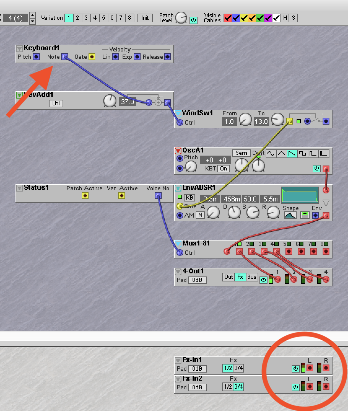

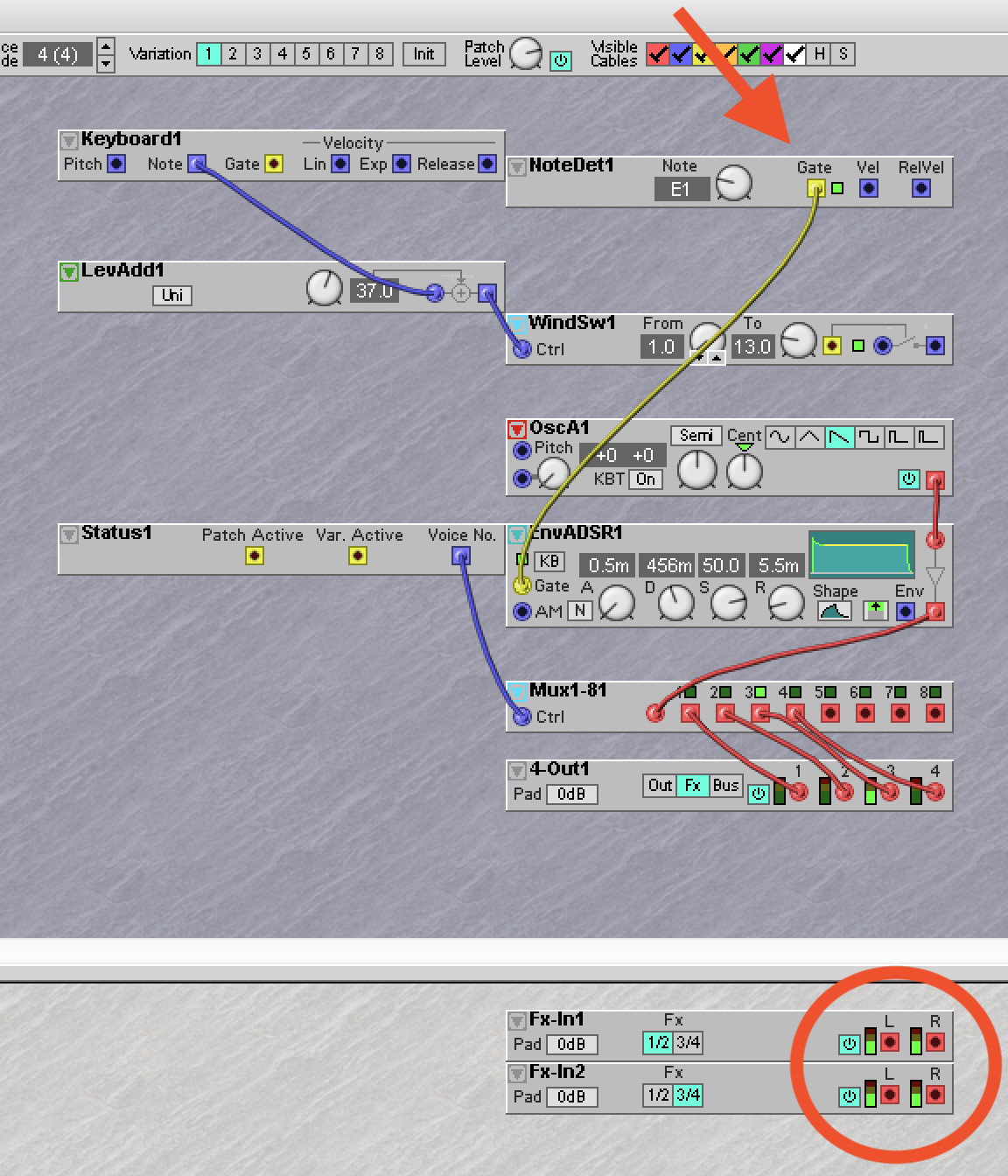

Hi. I have a query about voice allocation so I thought I'd add to this thread rather than start a new one.
I would like to play all the voices at once each time I press a new key, but I find that what happens is the G2 selects only one voice at a time. Is there an easy way to play all voices at once from the keyboard? The Note Detect module works (as shown in the screenshot below) but obviously I can only play one note and I would like to be able to assign several notes to the oscillator & envelope.
I do have a work around which involves routing the gate signals from another slot, but its not very elegant or cheap and I can only achieve six notes polyphony.

Hi TEMAS,
Unison building block try to acheive the same task I think. This one don't use other slot :
http://electro-music.com/forum/post-364242.html#364242
Others solutions are available too (with more than six notes polyphony) if you can use other slots.
