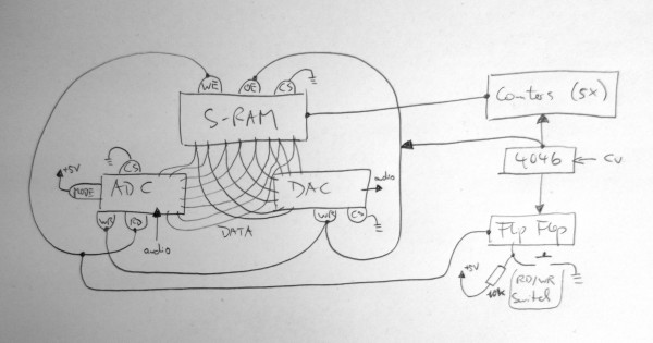

the idea: a simple 8 bit voltage controlled sampler using S-RAM for sample storage…audio/synth signal into ADC -> S-RAM -> DAC - mixer -> audio out…
control mechanisms:
1. voltage controlled clock (4046) timing the counters / ADC / S-RAM / DAC…
2. RD/WR switch using a d-flip flop to align the switch timing with the clock
I got most of the device working…almost 20sec of relatively clean audio looping
the issue: whenever I use the RD/WR switch to insert / record audio, there’s an audible pop in the sample (1x press/start + 1x release/end)…it is only audible in quiet passages, but just too annoying…

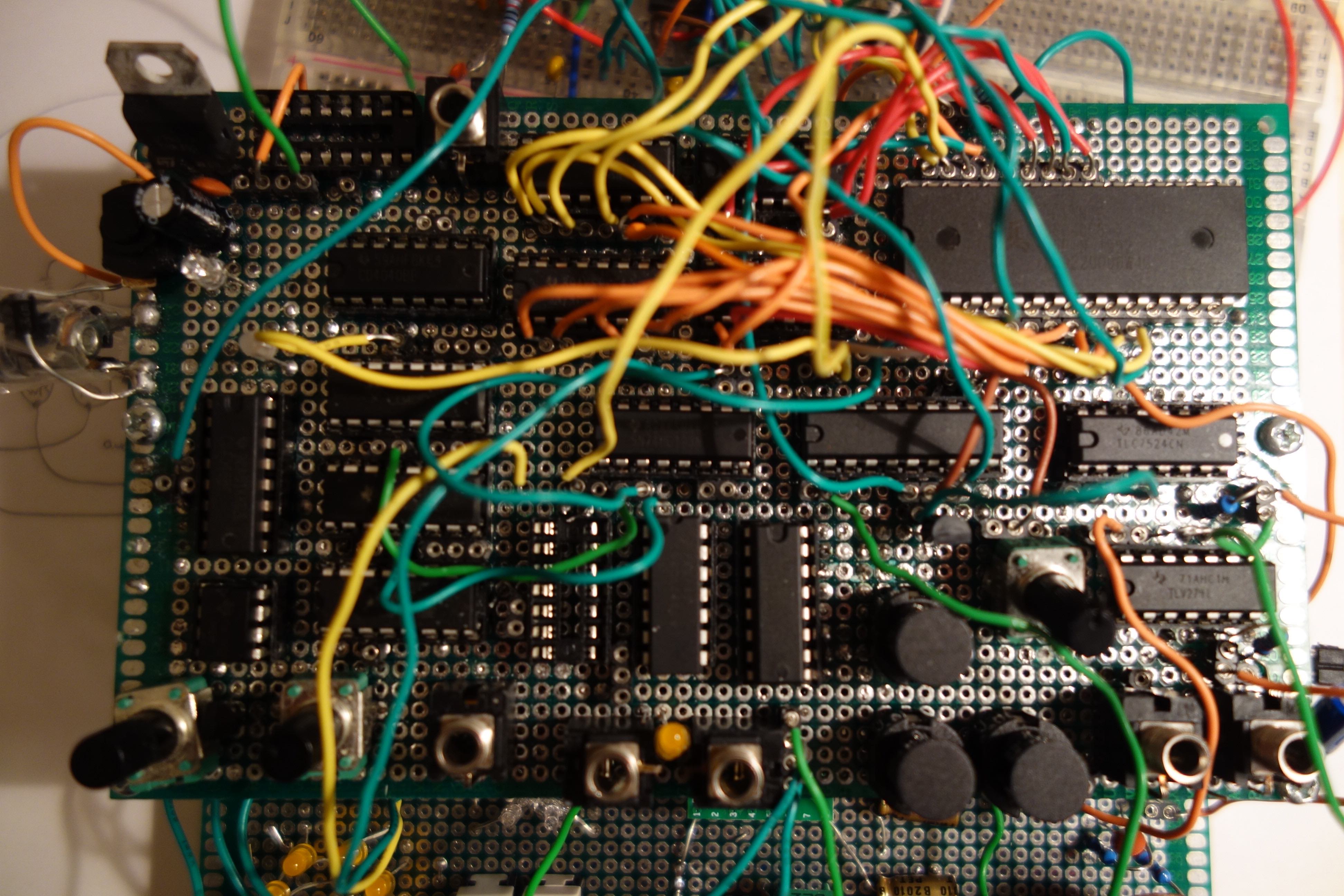

the whole device is build on protoboard (mostly soldered) and has many long overlapping wires between the ICs…see photo…(I assume this could be an issue, but everything else works fine) it runs on 5V provided by a 9V wall wart (high quality) through a voltage regulator (1A)…all the ICs have bypass caps…
I read about timing issues in the nanoseconds between the ICs…I still have to make a timing diagram (was hoping it wouldn’t be necessary)…I first thought the S-RAM is switching the WR ON too early and OFF too late so that the data from the ADC is not valid yet…but there might be something else wrong…

the simplified schematics obliterate audio in/out opamps, detailed connections bet counters and S-RAM, voltage control, etc…the 5th counter has 2 unused output pins…should I ground them?

Not knowing the detailed circuit my first suspect in those cases are triggers without plop filters / capacitors / debouncing.

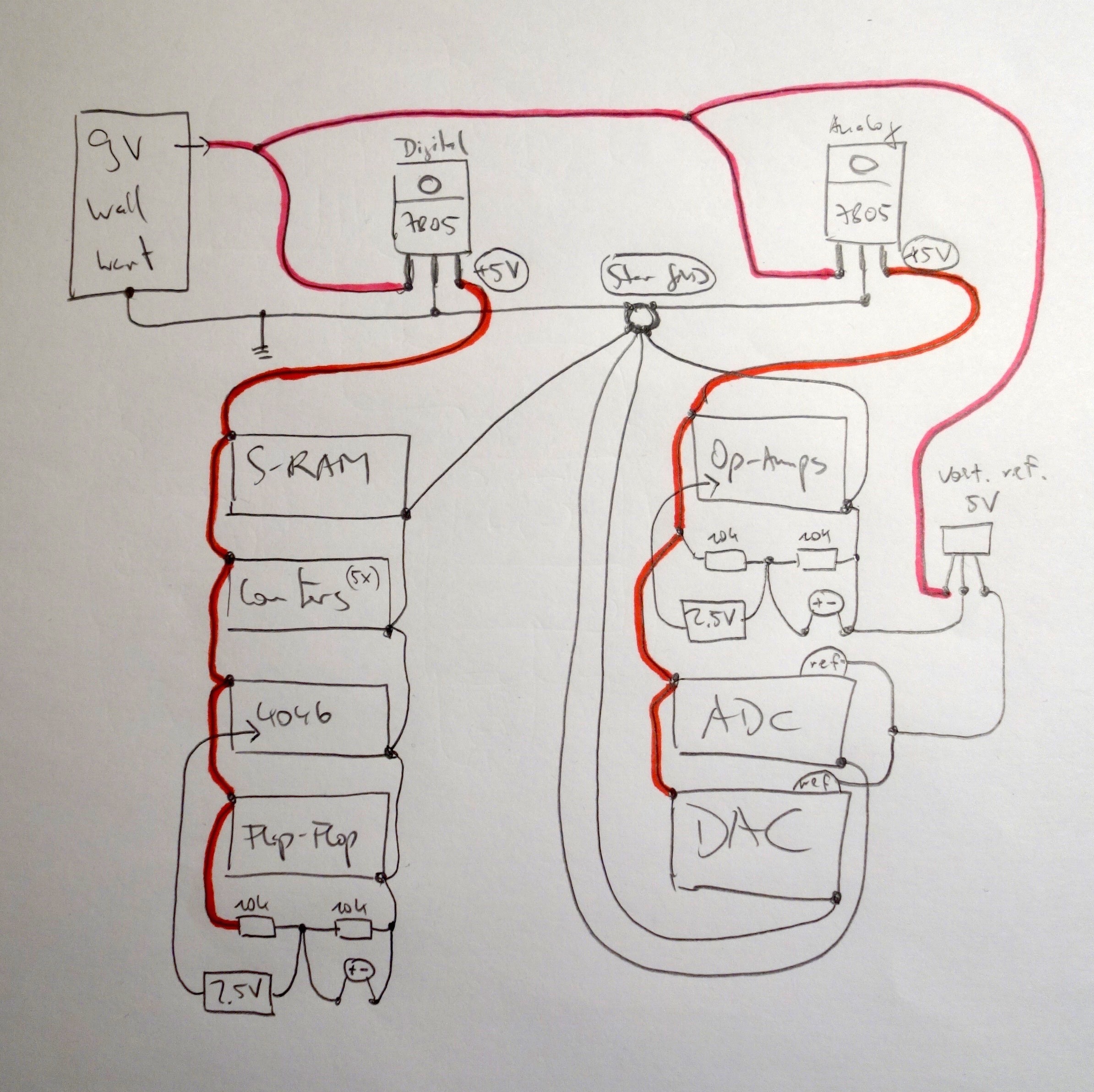

PostPosted: Thu Nov 11, 2021 11:28 pm    Post subject: Reply with quote  Mark this post and the followings unread
thx everyone for the quick responses!
electrouwe: I was not aware of having to separate the digital (logic) and analog (opamps, etc) power/GND lines...(i.e. the ADC/DAC I am using do not have separate grounds)...this project "grew" over a long time, so its a little messy and will take time to separate...do I need to put the opamp for the CV (for 4046) on digital or analogue power/GND...I also found I forgot a few decoupling caps, but most ICs have one...just to make sure, I attached a drawing of the power/GND lines...

Joined: May 27, 2012
Posts: 146
PostPosted: Fri Nov 12, 2021 2:23 am    Post subject: Reply with quote  Mark this post and the followings unread
google for "star ground" and you will find lots of information, why separate GNDs and VCCs are important and how to do it.
Your RAM will probably draw >100mA spikes when switching modes/access.
If these fast current spikes turn into voltage when flowing through a inductance ( which your GND wiring is) , you will have it everywhere on your board. So please take your time and do the right power line routing.
And yes, opamp GND must be analog GND.

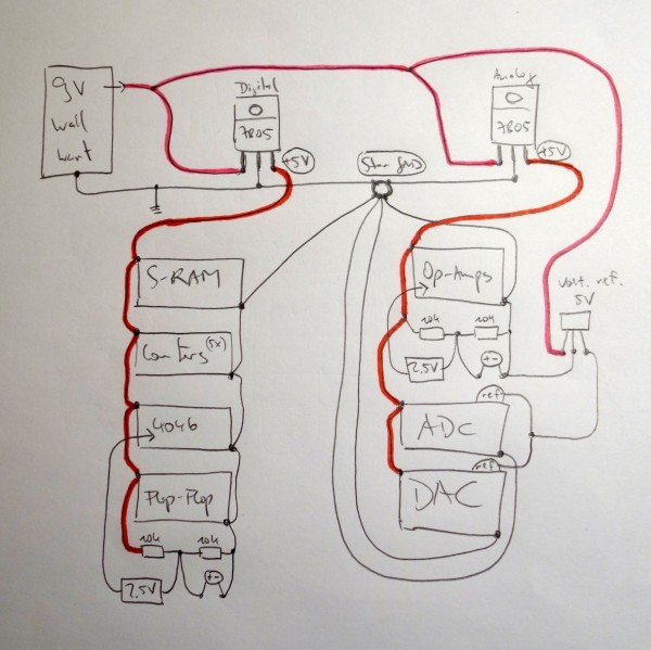

PostPosted: Sat Nov 13, 2021 8:53 pm    Post subject: Reply with quote  Mark this post and the followings unread
thx electrouwe for the "star ground" idea...I did a lot of reading on this but still have a few questions (pros/cons of star ground vs. separate ground planes)
1. ADC/DAC are considered analogue, right?
2. the voltage reference for the 4046 should connect to digital ground, right? do you suggest using a voltage reference IC too? (instead of a simple voltage divider)
3. a star ground would implement routing EVERY ground connection to a central point? OR combining all analogue and all digital grounds and then letting those meet at a central point (isn't this like having 2 ground planes?)
4. what about the power lines? they should just be linked separately (1x combined analogue / 1x combined digital) right?
5. some designers even suggested having 2 separate power supplies for analgogue / digital (1 voltage converter for each?) like dividing the power input (9V) to 2 voltage converters (and then having basically 2 grounds)?
any advice would be highly appreciated....thx

PostPosted: Sun Nov 14, 2021 5:16 am    Post subject: Reply with quote  Mark this post and the followings unread
yes. But because both are also digital and produce current glitches on GND, I would route them separatly to the star GND point to avoid coupling this noise into other analog parts
need detailed schematics to answer more specific.
that would be an overkill - we talk about 8bit electronics. I guess you can use serial VCC and DGND wiring for the digital glue logic, which is then routed to the star ground point with a single wire. Same applies for analog "reference" GND, like noninverting opamp inputs. If analog components don't draw excessive current , which would cause DC offset voltages on GND or they don't produce switching noise, I would route them from point to point and then route this AGND to star ground.
Loops in general should be avoided, which means that VCC and GND nets should be routed as close as possible minimize the loop area.
I would try to "copy" the DGND wiring topology also for VSS, and also route analog VSS close to AGND wires.
I would consider 2 power supplies, or do extra LC filtering for critical parts with single supply, for a 12 or 16bit design. But it woulde be easy to add a 2nd voltage regulator later , because you should have separate analog and digital VCC routing anyway

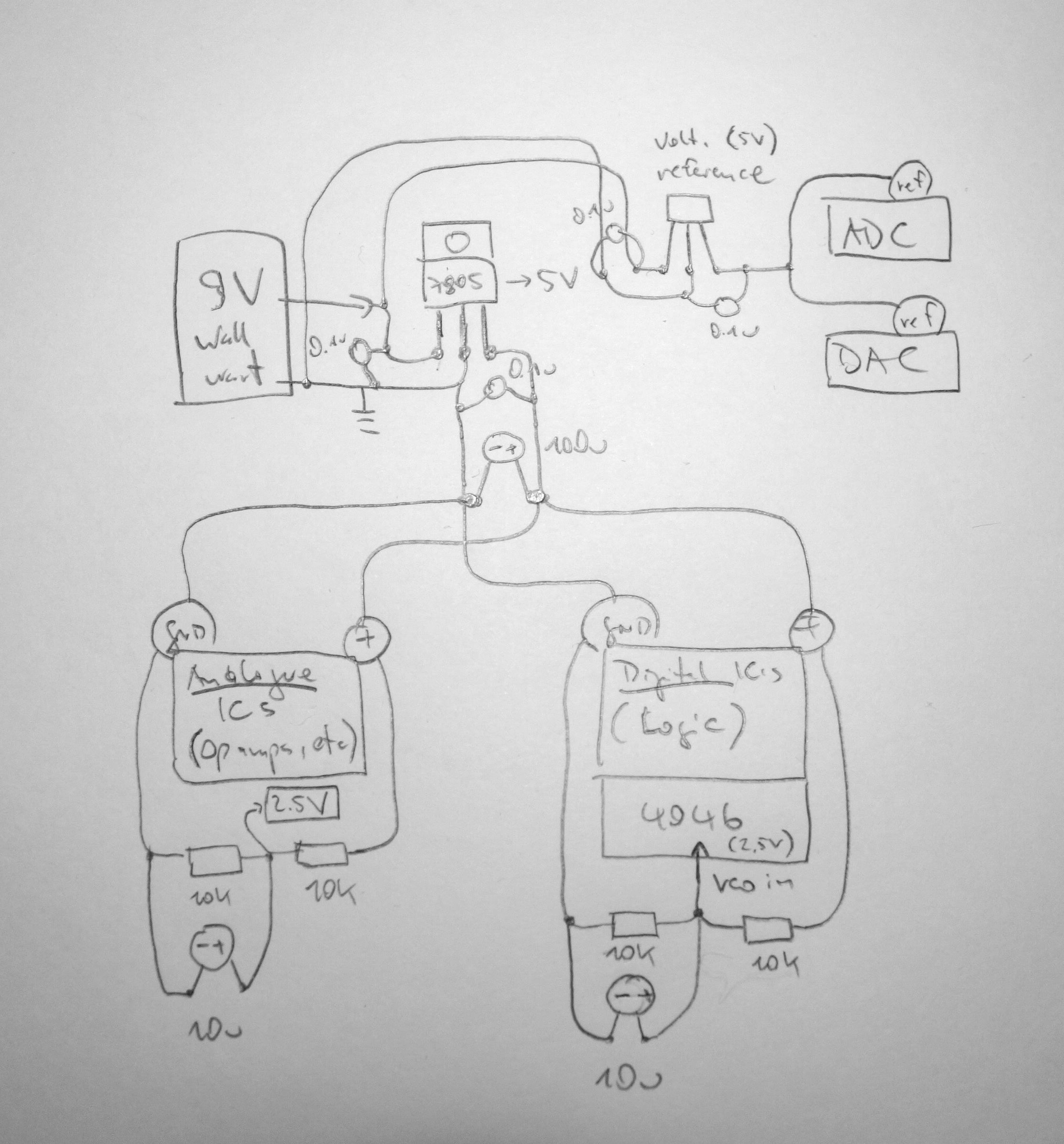

PostPosted: Mon Nov 15, 2021 11:27 pm    Post subject: Reply with quote  Mark this post and the followings unread
thx for the info...I just wanted to mention that I am only using a single sided supply (no +/- voltages)...I have a few more questions regarding your answers:
1. ADC/DAC: do you recommend routing the VCC separately too?
2. the "voltage reference" is a little IC looking like a transistor...I use it for the reference voltage (5V) for the ADC/DAC
5. is it making sense to use 2x +5V voltage converters (to separate digital from analog)? see picture (can you check if the routing makes sense? I intentionally left out all the caps)
new question: should I also route the S-RAM separately, since it seems to be the source of the popping issue

elektrouwe
Posts: 146
PostPosted: Tue Nov 16, 2021 2:23 am    Post subject: Reply with quote  Mark this post and the followings unread
give it a try, soldering 1 wire takes less time than our discussion Wink
You will gain design experience if you check out different ideas. Take advantage of having a breadboard and not a PCB !
I doubt that you need a TL431 or similar for an 8 bit audio design. We talk about 5V/256 = 20mV/bit. Your analog 7805 should have much less than 20mV noise, so it should be fine. 5V temperature drift is also not an issue here, because long time drifts will appear as inaudible "milli dB" amplitude drifts.
Same for the 4046 reference: good filtering keeps VCO Jitter low, but there is no need for high absolute precision
see 1. Smile
I would do it; but again - see 1.
now warm up your solder iron and tell us about your findings !
