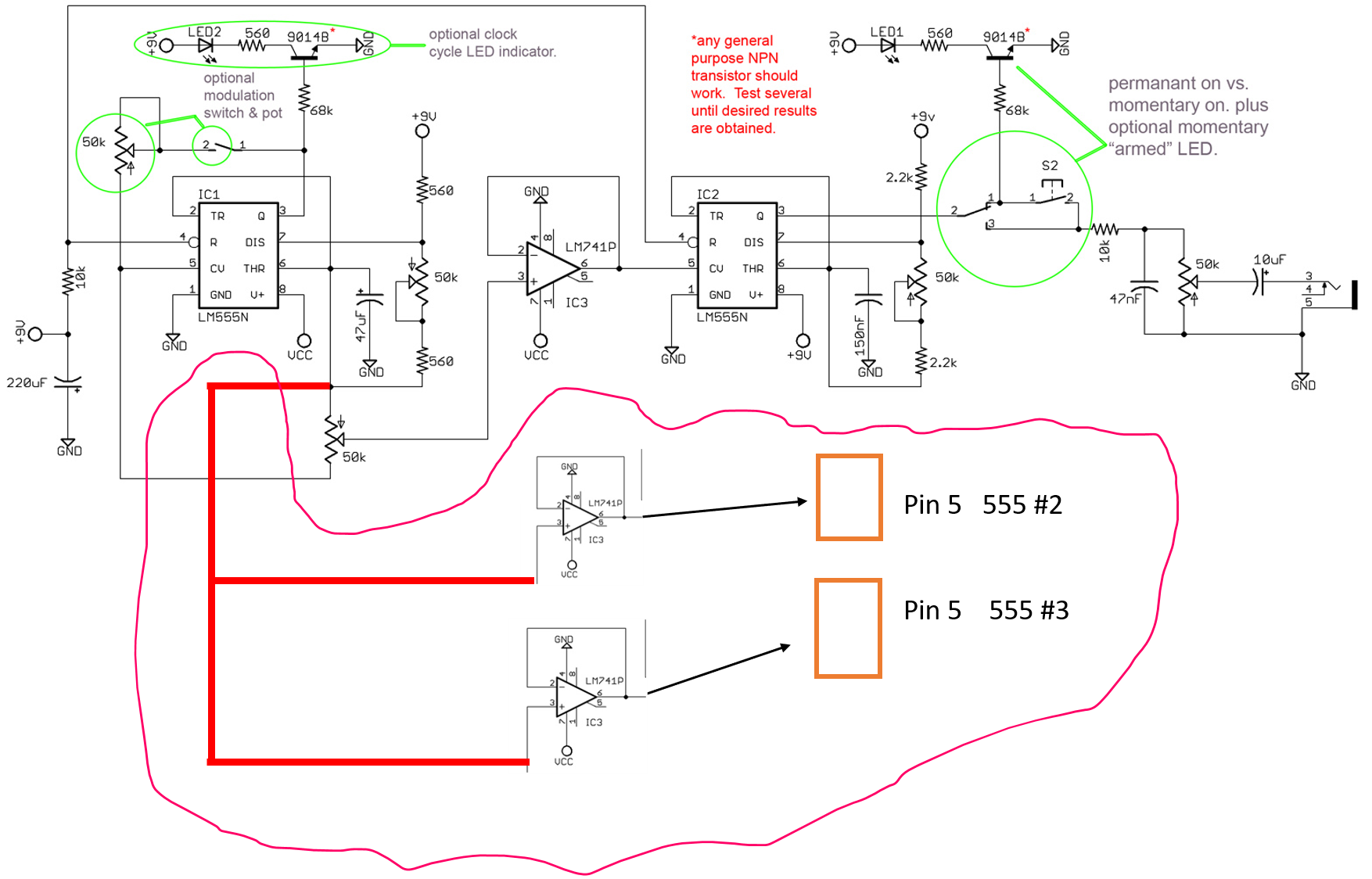

I've been trying to work out how to drive 2 of 3 different 555 control voltages from the same sourece. From the same sequencer, or as in the attached, from the same modulating frequency in a dub siren.
The dub siren circuit is the upper part--their is a LM741 stage between the modulator and oscillator.
It seems like you could drive several 555 CVs, simply by running each through it's own LM741 buffer stage (and a pot, if wanted).
If I split the output of the first stage into 3, all 3 should be at the same voltage. But I'm assuming the reason the op-amp stage is in there is to isolate the 2 circuits, and provide a current source.
Is my thinking on that correct? I think it would be interesting to run a couple of oscillators, which would be perfectly synched with the siren effect.
I'm sorry for all the dumb questions lately. When I started building, I just wanted to find schematics and wire up whatever the device was. As I'm revisiting this project, it was clear if I really understood the cirucuits I would be able to have a lot more freedom.
