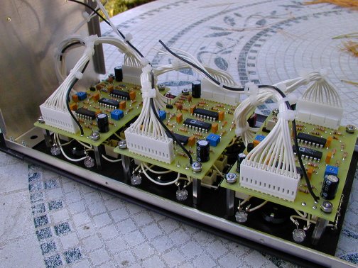

PostPosted: Sat Oct 21, 2006 8:19 pm    Post subject: Reply with quote  Mark this post and the followings unread
Here is part of a prototype I have been working on that illustrates the type of connectors that will be used on the SN-Voice circuit card assembly.
These happen to be three high quality SSM2164 based VCA's prototype boards as part of a larger RISC-Controller based modulator I have been building.
Bill
