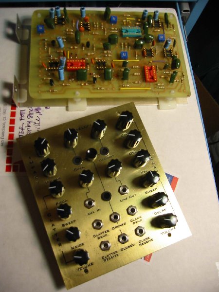

PostPosted: Thu Oct 25, 2007 7:47 pm    Post subject: Reply with quote  Mark this post and the followings unread
Heres where things are at with my recent clangora build. Panel wiring to begin this weekend. Won't be pretty back there...maximum control density Shocked

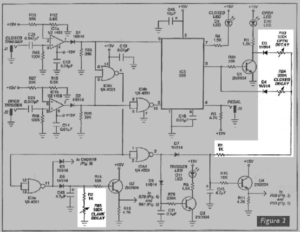

PostPosted: Sat Oct 27, 2007 3:39 pm    Post subject:
Subject description: clangora wiring question
Hi
I'm in the midst of wiring my clangora panel. I've spent the better part of the afternoon making a wiring diagram, and I have a quick question:
I need a bit of clarification on the envelope generator portion of the schematic (fig.2, attached below). Pots R83, R84, & R85 (all decay controls) are shown schematically as not having their wiper connected to anything. Should I assume that pin 3 and pin 2 on the pots are jumped together?
So following this assumption, R85 pins 2 & 3 would get tied together and connected to ground and pin 1 would go to the board (to R2).
For the other two (R83 & R84), Pins 1 on both pots are tied together and connect to the board (to R1) and Pins 2 & 3 get jumped together and connect to their respective board connections (the two diodes D3 &D4)
Are these sound assumptions?
Thanks a lot
Peter

PostPosted: Sat Oct 27, 2007 4:22 pm    Post subject:
Yes, the notation is for a variable resistor which is a pot with only one end and the wiper connected. And indeed it's better to connect the wiper to one of the ends, as the 1st terminal, and use the other end as the 2nd terminal. So when there is a bad wiper contact the resistance will not go to infinity.
PostPosted: Sat Oct 27, 2007 4:49 pm    Post subject: Reply with quote  Mark this post and the followings unread
That symbol is confusing, because it looks like either end of the resistance is connected, and the wiper is not connected to anything, but, it's just a symbol. Conventions sometimes get in the way of understanding.
Photon
Joined: Mar 22, 2005
Posts: 363
Location: Boston
PostPosted: Sat Oct 27, 2007 6:01 pm    Post subject: Reply with quote  Mark this post and the followings unread
Thanks for the help. It makes sense now. Maybe I'll actually finish this tonight (!)
