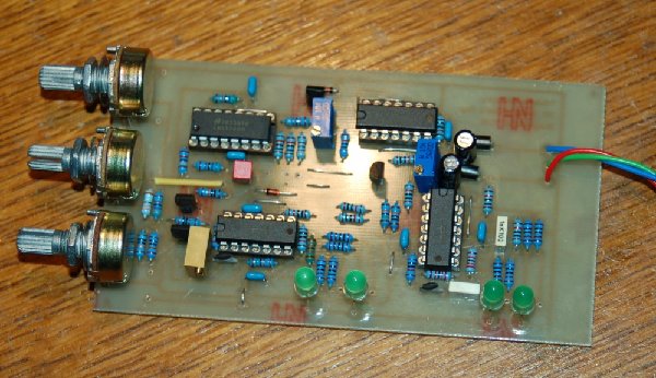

Finished mine
TH Quadrature Generator
 Filesize:  161.3 KB
 Viewed:  368 Time(s)

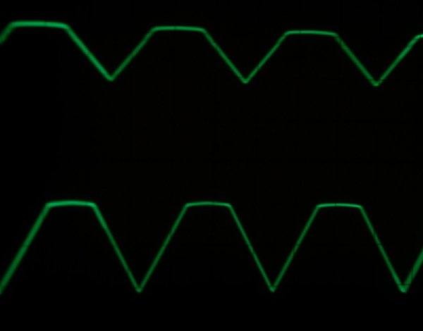

Still need to debug though, as all waves are clipped at +2V. Below are the 180 and 270 outputs:
Clipped Waves
 Filesize:  32.19 KB
 Viewed:  346 Time(s)

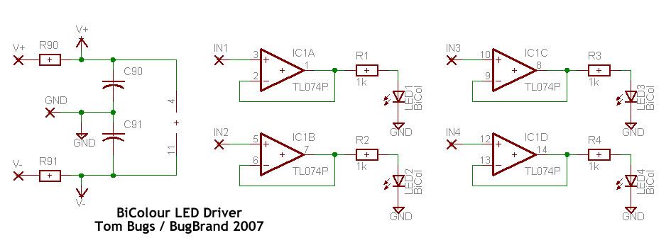

And I'd forgotten that I was also going to recommend a bicolour LED driver add-on too... Like what I did for the Mankato - BiColour leds are mesmerizing to watch! This is the super-simple circuit I employed for that::::
Simple driver for Bicolour LEDs
 Filesize:  50.75 KB
 Viewed:  490 Time(s)

No need to debug, it was just me being silly. Because it was easier, I hooked up the scope input to the legs of the LED. The clipping is just the LED conducting. The real outputs are all fine.
So I can now report a confirmed build. The PCB is fine.

Does everything fit ok? I notice things look quite tight around the supply input beads / offset trim - - - - is a bit more space needed there, perhaps?
http://www.bugbrand.co.uk
etaoin
Joined: Jun 30, 2005
Posts: 761
Location: Utrecht, NL
PostPosted: Wed Oct 31, 2007 4:43 am    Post subject: Reply with quote  Mark this post and the followings unread
Yes, that is very tight. Caps didn't fit in between the beads (they stick out on top) and C13 and R39 bump into IC3. I guess you intended smaller trimmers anyway (Bourns 3266W?) as the ones I used didn't really fit anyway.
