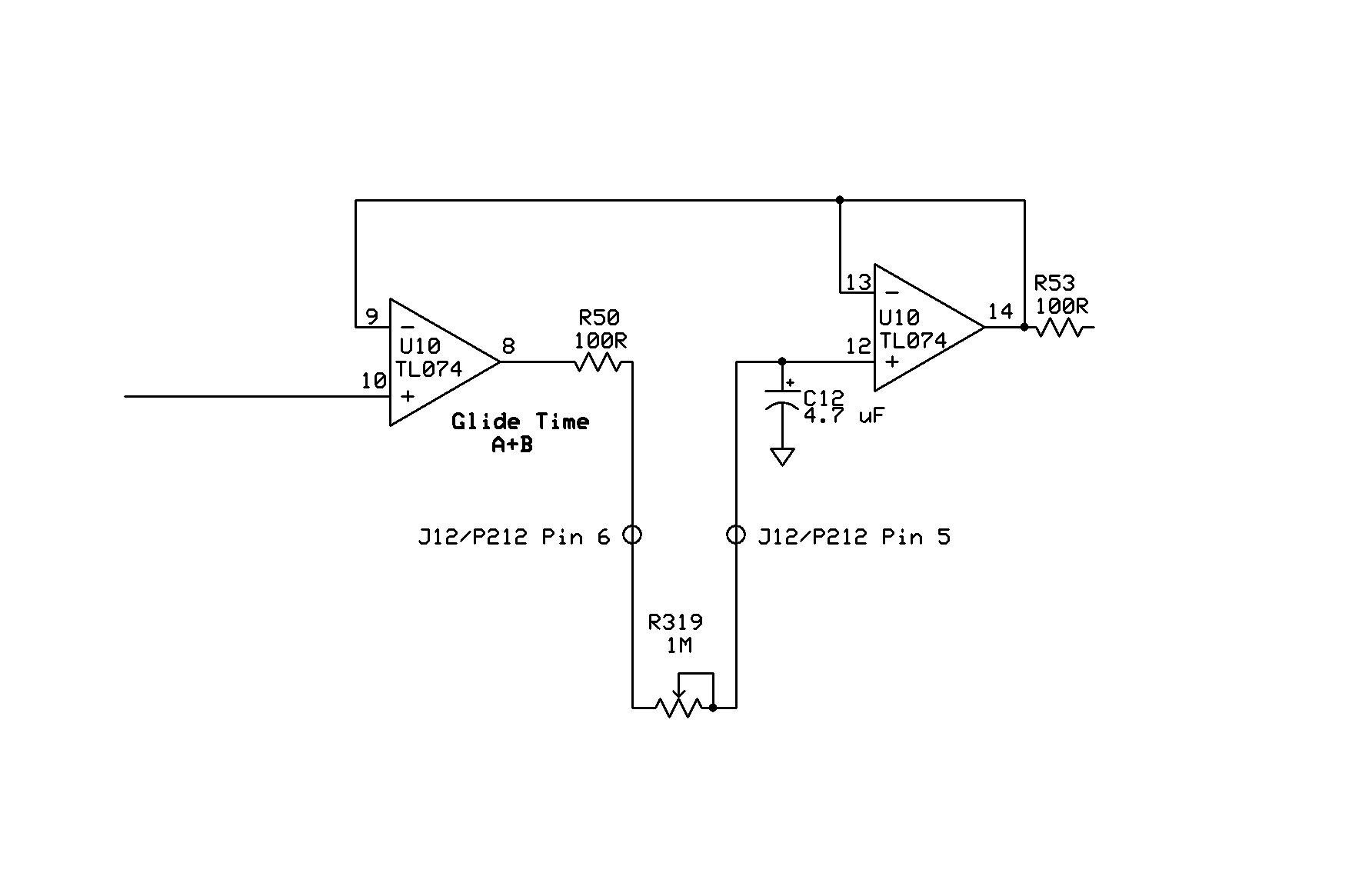

my klee2 run like a charm, almost from the first powering up!
however, unfrequently the A&B output behaves not as it should: the CV glides although i turned the glide pot fully ccw. it happens only sometimes, and when it happens the potentiometer has no effect at all. i did not note any rule here, yet. i rewired this section two times and replaced the potentiometer.
could it be capacitance/cross talk? the wires to the potentiometer are twisted and are tied to the wires going to the jack socket. if, why would it happen for the A&B output only?

Hey Fonik,
Strange problem indeed!
I don't think having a twisted pair is going to affect the glide function. It sounds to me like an intermittent high resistance that you're dealing with.
Yeah - first thing I would have done was change the pot. Obviously that didn't do you any good.
I've attached the circuit to this post. The glide circuits on the Klee are simple linear type lag circuits. The only thing I can think of that would cause the unwanted lag is a high resistance somewhere between pin 8 of U10 and pin 12 of U10, or if U10 (for some reason) has a very high output impedance from time to time. Higher resistance causes a longer charge time for C12, which gives you the glide. Obviously, the higher resistance is what R319 is there for. R50 prevents any shift in voltage (pitch) when R319 is turned from 0 resistance to some higher value.
Looking at it, the high resistance could be caused anywhere along the path to pin 12 of U10:
1. Pin 8 of U10 not making good contact in socket.
2. Cold solder joint at pin 8 of U10 socket.
3. Cold solder joint on either side of R50.
4. Cold solder Joint at pin 6 of J12.
5. Intermittent contact along the point from J12 (through P312 wire harness) to R319.
6. Intermittent contact along the point from the pot to J12 pin 5 through P312 wire harness.
7. Cold solder joint on pin 5 of J12.
8. Cold solder joint on the positive side of C12.
9. Pin 12 of U10 not making good contact in socket.
10. Cold solder joint at pin 12 of U10 socket.
Let me know what you find!
Take care,
Scott
Klee AB Glide Circuit
