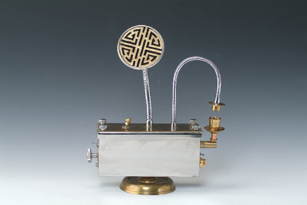

I'm not a solder-boy (or whatever you call the kind of folks who build grotboxes and experimental analog critters and all), so I don't know if what I'm proposing is a 90min project or something pretty intensive, so it'd be great if someone could clue me in as to what aspects are tricky, and which are easy.
If getting three osc tones (one of which is variable by button) and then adding a distort switch and flange switch is a really easy project, I have a few ideas to add to it to make it more versatile, mainly in terms of re-tuning.
EDIT: what I want is something kind of like what crashlander42 builds, but with a hurdy-gurdy interface:

Crashlander's vid is of a Soundlab and the cracklebox/WSG combination he calls "The Summoner". So if that's the sound(s) you're after, it just got a lot easier. Because all of those are published online (individual parts, not necessarily CL42's combination) and relatively easy to build, with good support for a newbie builder. Figure probably 2-300 dollars in parts overall. Probably want to check out the Ray Wilson/ MFOS forum at this electro-music site for details on the Soundlab and WSG. Tom Bugs' Bugbrand site has some cracklebox implementations and useful info worth looking at IMO.
An HG is basically a wheel-bowed viola, so you're looking at a string synth if you want to pursue it going another direction. Start with a couple sawtooth osc's and add a filter and/or waveshapers. The signature HG sound of a buzz bridge can be had from a PWM/square wave osc (and these are cheap simple and very useful also as chorusing for the saw oscs to get a more realistic bowed string sound.
The melody control is easy, just a slightly modified keyboard circuit. The sound lab/WSG might be a really great way to go. Because I think you'll appreciate having more "synth" available as you use this. The UI is the thing that's different really. And most of it is pretty simple; just pick the knobs you want to use and set up the notes you want to play with switches.

MIKEFORD
Joined: Nov 13, 2006
Posts: 40
Location: DEEPSOUTH
PostPosted: Thu Oct 11, 2007 4:36 pm    Post subject: Reply with quote  Mark this post and the followings unread
this is a prettier version of a wheel sound thing i was working on the silver knob on the side is a heavy weighted knob that turns a highly modded rotary switch that i rebuilt to allow rapid 360 degree turns. it has a tone circuit that has a common ground and as the wheel is turned,the notes fire off. the scale is whole toned, if i recall and there is a photo eye that allows pitchshifting via a rapid flashing super bright white led! I have another circuit that will have drone circuits as well.(based on an old texas instrument SN chip!) here is a youtube video that will demo it better! I would look into the electronic Indian drone boxes (sutri, i believe is the name)used by sitar players. Hope this helps!
http://www.youtube.com/watch?v=3Q-AItvW28Y
