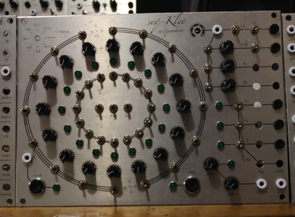

well the neo-klee panel is done
i added a mfos quantiser to it
i need to source a few panel components but other wise is done
now to wire it up
*edit added higher res photo

Looks good Luka!
Looks as if the "Range" switch is yet to be sourced. That was the last hole I filled on mine. I put a six position switch in there cause I had one, although I'll get an eight next time I order parts. Have not really missed those two extra positions so far... but...
The panel wiring was not so tedious as I expected - take your time and enjoy the build.

got the switches, they are the NKK switches seen in this pic
i just need to trim the stem
mostly bananas that i need now
this is my 2nd time at wiring a klee
i hope all the experience making cables during the first time will help me through Smile

That looks faboo Luka. I used one of those nkk switches - they work great.
Watch out for that scorpion

where did you get the knobs for the odd shaft diameter? or is it standard?

matthias luckily the knobs came with the switches
i bought them at allied electronics
yeah adam it has taken a fair bit of work to get where i am. i have no idea how people produce modules quicker. i suppose living close to parts suppliers like mouser helps, unlike us who have to bulk up our orders for projects only to find they missed parts and need to wait another few months to make another order.
i just cut out the pcb support plates for my next batch of modules so once they are on i might take some photos to show them all together
thanks for the props, i really have to give all the props to lazertran. it is such an awesome method, and also my tricky camera angles which don't show any of the imperfections caused by scratches from the aluminium filing when im drilling the holes. Smile
** edit, in the effort of not overcrowding the thread with pictures of my builds i added the pics of my system on my blog. check em here http://cycleofproblems.blogspot.com/2009/10/progress-thus-far.html
click on the photos for close ups. man i love my gf's camera

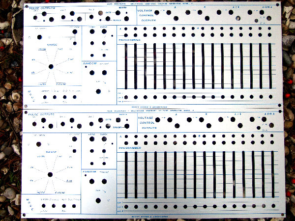

Unfortunatly theyre all packed up and about to be sent to their owner (so i cant get a nicer photo) but i think the panels below are quite a nice design.
Im eager to see the finished item : )
edit: they were not my design, but Erik's (the owner)
Erik's Klee Panels
 Filesize:  1.92 MB
 Viewed:  700 Time(s)
For custom cnc engraved panels see - http://www.thebeast.co.uk/cnc/

PostPosted: Tue Nov 24, 2009 8:32 pm    Post subject: Reply with quote  Mark this post and the followings unread
OMG, that is just devastating.
www.fluxmonkey.com
PostPosted: Tue Nov 24, 2009 11:48 pm    Post subject: Reply with quote  Mark this post and the followings unread
'Scott Stites & Associates" - that's nice Very Happy
julian, how did you do the color fill-in?

PostPosted: Wed Nov 25, 2009 5:46 am    Post subject: Reply with quote  Mark this post and the followings unread
nothing fancy - just paint.
ive tried chemical oxidising before (i meen on other panels), but you can only get it in black, and it doesnt actually work that well (or at least i havent got it to work that well)
i have an old engraving book which talks about "cold wax" infill, which, one day, i would like to try (but its more for larger work)
to do the wax infill, the panel is cut in the usual way, and then heated, and wax melted into the cuts.
the whole surface is then ground / buffefd to remove the excess wax, and flatten the whole surface, but then the finish on the wax wouldnt look nice, so its then heated again (ensuring the panel is level) to restore the gloss to the wax.
you can imagine that, on large panels, with big letters, that would look superb. not really the one for synth panels though...
PostPosted: Wed Nov 25, 2009 6:34 am    Post subject: Reply with quote  Mark this post and the followings unread
julian wrote:
acrylic? on water or on oil basis?
