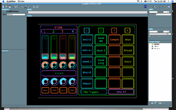

it has it limits, but just the concept of an open architecture (mostly) environment for control is great. i think it has a lot of strengths in the live arena because everything is so clearly labeled on the thing and can adapt to pretty much any environment. i also think that it will become more 'malleable' as things progress.
-matia
to be able to very clearly organize stuff is priceless in certain situations
