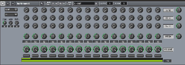

i've built a simple midi sequencer in Reaktor for controlling my Nord Modular G1. Basically it consists of Trigger Steps, Volume, Pitch, and 3 CC parameters. But my problems comes here:
The pitch/note values are sent permanentely, regardless if a note is triggered or not. That means if i record the output of the sequencer, every adjusted Pitch/note value gets recorded over the whole time.
WHAT I WANT is that a note value is sent ONLY on Note trigger. So, something that will open/close the output of the pitch/note value according to the trigger signal.
Anyone can help me please ?

here's the .ens file if someone would take a view on this...
suggestions please

There's a trick that can be done, you can connect the pitch/note knobs to the value input of an (Event Processing->)Value module, then use Note Trigger as a trigger source for the same Value module. This will meet your expectation i guess, as the pitch/note value will only be triggered if there's a note trigger signal coming.
